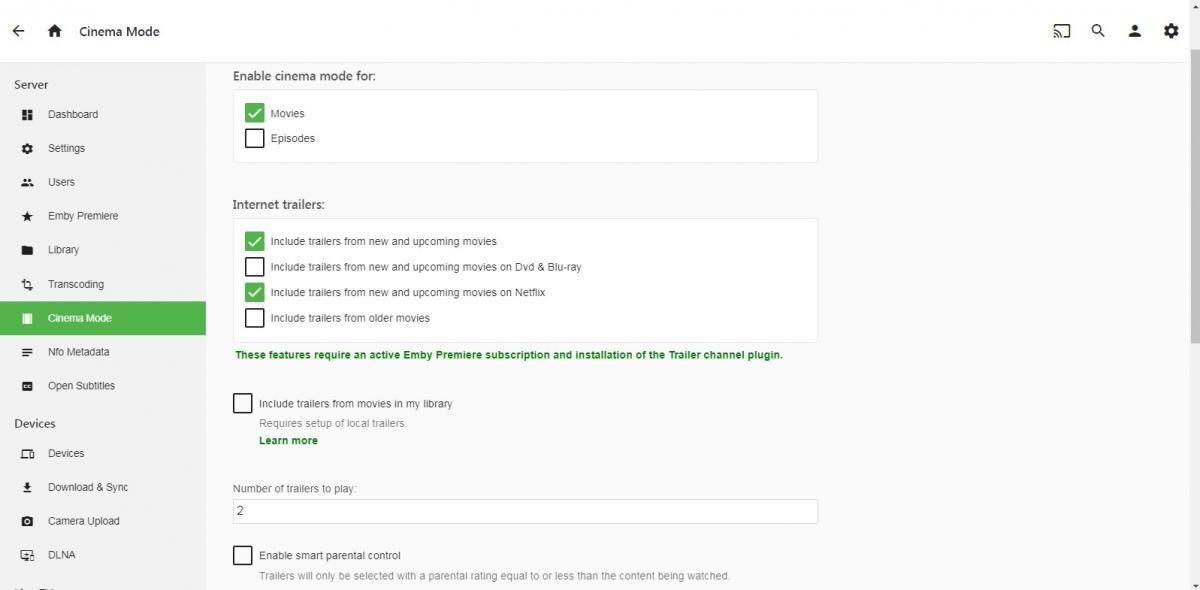

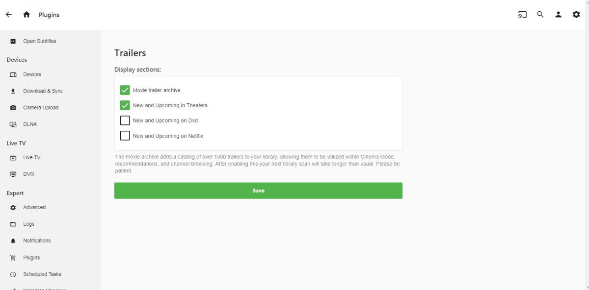

noakd8601 3 Posted January 25, 2019 Posted January 25, 2019 Just chiming in to report that I'm having the same problem with Cinema mode not working. I have disabled 'smart parental control' and 'only show trailers for unwatched movies.' Also, there's no content showing in 'new and upcoming on bluray' and 'new and upcoming on netflix.' Only the 'new and upcoming in cinemas' and 'movie trailer archive' sections are showing any content.
Luke 42219 Posted January 26, 2019 Posted January 26, 2019 As a test, try browsing into the trailer channel first and pulling up each folder. This will get trailers loaded into the Emby database. @@mgworek i will merge your thread into this one. Thanks.

Nyquis 2 Posted January 28, 2019 Posted January 28, 2019 how do i get cinema mode to work again? I didn't change anything to my setup, it just stopped working one day (I have emby premiere along with the plugin). As for my settings I have everything ticked except for : "Include trailers from my library" Also every time i access the server from my shield, I have to log in, why is this? can i change that (the emby sever is on my windows 10 pc on the same network). Since the newest update (which i installed today) backdrops no longer work on the homescreen on my shield, was this intentional by the Devs? Any help would be appreciated thanks
