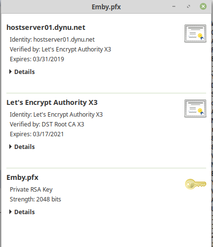

jmyumul 1 Posted January 6, 2019 Author Posted January 6, 2019 Hi, yes the intermediate cert(chain.pem) is included in the pfx. I've tried to recreate the pfx few times using openssl with combinations: [cert.pem, chain.pem and privkey.pem] or [fullchain.pem and privkey.pem] but no difference at all. I also attached a screenshot of the pfx file.
Q-Droid 1011 Posted January 6, 2019 Posted January 6, 2019 Are you still getting the verify errors using openssl s_client? I still suspect the issue is around your PFX file and config but more info is needed. We are both using dynu.net and Let's Encrypt. You're on Fedora, I'm on CentOS. Same version of Emby, 3.5.3. Earlier versions of Emby had a chain depth issue on Linux. It only responded with depth=0 but this was fixed on or before release 3.5.3. Your response from openssl s_client should come back with a chain that includes server and intermediates, for LE certs you get a certificate chain up to depth=1. Windows as a client will negotiate a connection with missing chain certs because it has intermediate certs in its own trust store. I think Linux only has root CAs in its trust store. From my server: openssl s_client -connect 172.xxx.xxx.xxx:8920 CONNECTED(00000003) depth=2 O = Digital Signature Trust Co., CN = DST Root CA X3 verify return:1 depth=1 C = US, O = Let's Encrypt, CN = Let's Encrypt Authority X3 verify return:1 depth=0 CN = [server].dynu.net verify return:1 --- Certificate chain 0 s:/CN=[server].dynu.net i:/C=US/O=Let's Encrypt/CN=Let's Encrypt Authority X3 1 s:/C=US/O=Let's Encrypt/CN=Let's Encrypt Authority X3 i:/O=Digital Signature Trust Co./CN=DST Root CA X3 ---
