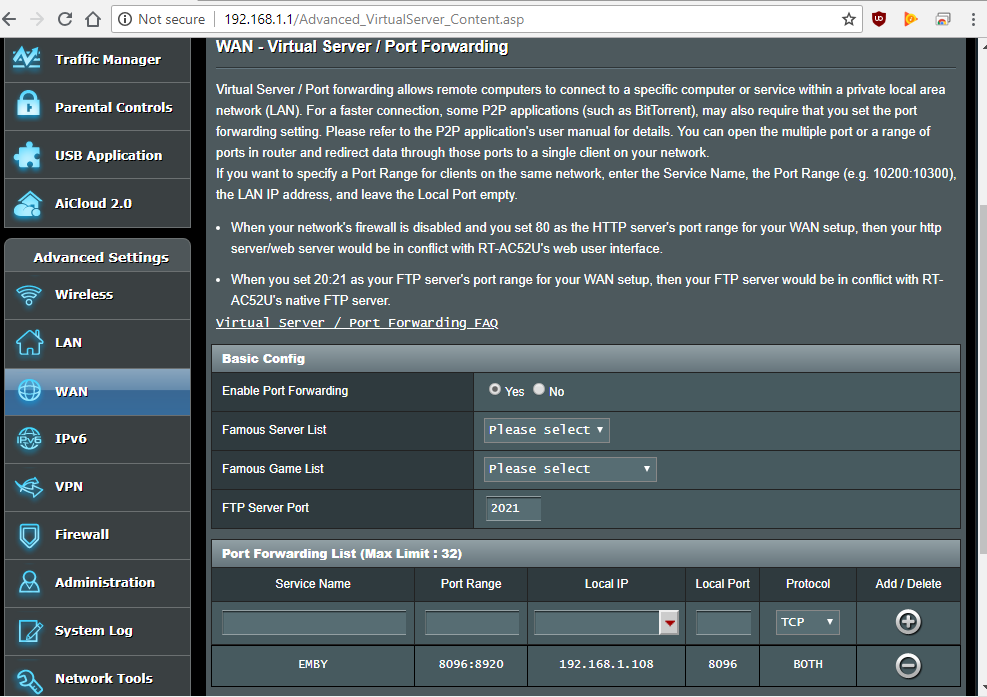

westmichigansc 0 Posted August 11, 2018 Author Posted August 11, 2018 It's possible that my port forwarding isn't set up right. Here is a snapshot of it.
Luke 42244 Posted August 11, 2018 Posted August 11, 2018 You're mapping 8920 to 8096 or am I reading that wrong?

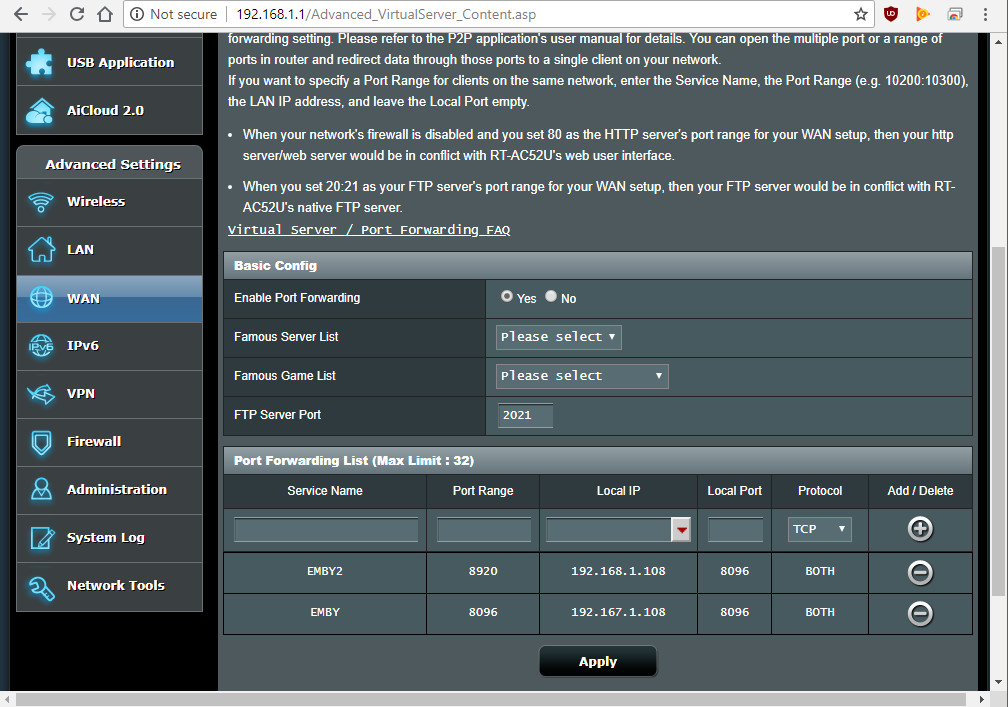

maegibbons 1287 Posted August 11, 2018 Posted August 11, 2018 Yes Break up that line in to two. One for 8096 and the other for 8920 Krs Mark
westmichigansc 0 Posted August 12, 2018 Author Posted August 12, 2018 I tried with 2 lines and it didn't change anything so something is still wrong. Here is what it looks like.
