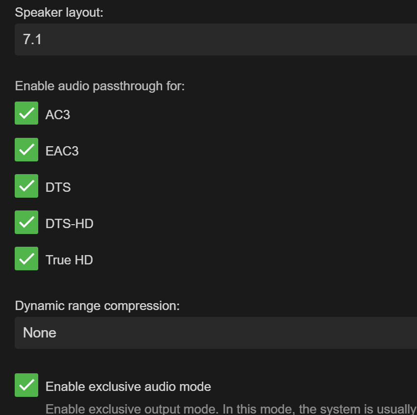

Guest asrequested Posted July 5, 2018 Posted July 5, 2018 (edited) There's a whole bunch of audio shenanigans going on in there. But it looks like your default audio device is optical. That doesn't support the audio. What are your audio settings in Theater? [af] [in] 192000Hz 7.1 8ch spdif-dtshd [ 1.432][v][af] format changed, draining filter chain [ 1.432][v][af] done format change draining [ 1.432][v][af] probing new format [ 1.432][v][af] [userspeed] 192000Hz 7.1 8ch spdif-dtshd [ 1.432][v][af] [convert] 192000Hz 7.1 8ch spdif-dtshd [ 1.432][v][af] got output format from probing [ 1.432][v][ao] Trying audio driver 'wasapi' [ 1.432][v][ao/wasapi] requested format: 192000 Hz, 7.1 channels, spdif-dtshd [ 1.432][d][ao/wasapi] Init wasapi [ 1.432][d][ao/wasapi] Find device '' [ 1.432][v][ao/wasapi] No device specified. Selecting default. [ 1.433][v][ao/wasapi] Selecting device '{0b5c0589-54ce-4c5a-9571-9cf7eff991bb}' (Realtek Digital Output (Realtek High Definition Audio)) [ 1.433][v][ao/wasapi] Monitoring changes in device {0.0.0.00000000}.{0b5c0589-54ce-4c5a-9571-9cf7eff991bb} [ 1.437][d][ao/wasapi] Init wasapi thread [ 1.437][d][ao/wasapi] Activating pAudioClient interface [ 1.437][d][ao/wasapi] Probing formats [ 1.438][v][ao/wasapi] Trying 7.1 spdif-dtshd (16/16 bits) @ 192000hz (exclusive) -> unsupported [ 1.438][v][ao/wasapi] Retrying as AC3. [ 1.438][v][ao/wasapi] Trying 7.1 spdif-ac3 (16/16 bits) @ 192000hz (exclusive) -> unsupported [ 1.438][d][ao/wasapi] Thread shutdown [ 1.438][d][ao/wasapi] Uninit wasapi [ 1.438][d][ao/wasapi] Thread uninit done [ 1.438][d][ao/wasapi] Thread return [ 1.439][d][ao/wasapi] Uninit wasapi done [ 1.439][v][ao] Trying audio driver 'openal' [ 1.439][v][ao/openal] requested format: 192000 Hz, 7.1 channels, spdif-dtshd [ 1.439][v][ao/openal] Channel layouts: [ 1.439][v][ao/openal] - #fl [ 1.439][v][ao/openal] - #fr [ 1.439][v][ao/openal] - #fc [ 1.439][v][ao/openal] - #lfe [ 1.439][v][ao/openal] - #bl [ 1.439][v][ao/openal] - #br [ 1.439][v][ao/openal] - #bc [ 1.439][v][ao/openal] - #sl [ 1.439][v][ao/openal] - #sr [ 1.439][v][ao/openal] result: 7.1 [ 1.471][f][ao/openal] Can't find appropriate sample format. [ 1.484][e][ao] Failed to initialize audio driver 'openal' [ 1.484][v][cplayer] Falling back to PCM output. Edited July 5, 2018 by Doofus

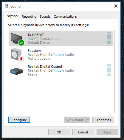

Guest asrequested Posted July 5, 2018 Posted July 5, 2018 And what is your speaker config and windows audio config?
Guest asrequested Posted July 5, 2018 Posted July 5, 2018 What cable are you using connecting your receiver to your computer?
Guest asrequested Posted July 5, 2018 Posted July 5, 2018 (edited) If it's HDMI, then the refresh rate switching is dumbfounding mpv's ability to find your receiver as the default player. And if you're using HDMI, then put this line in the mpv.conf that you made for the logging. Just put it above the logging command. audio-device=wasapi/(TX-NR5007 (Intel(R) Display Audio)) Edited July 5, 2018 by Doofus
