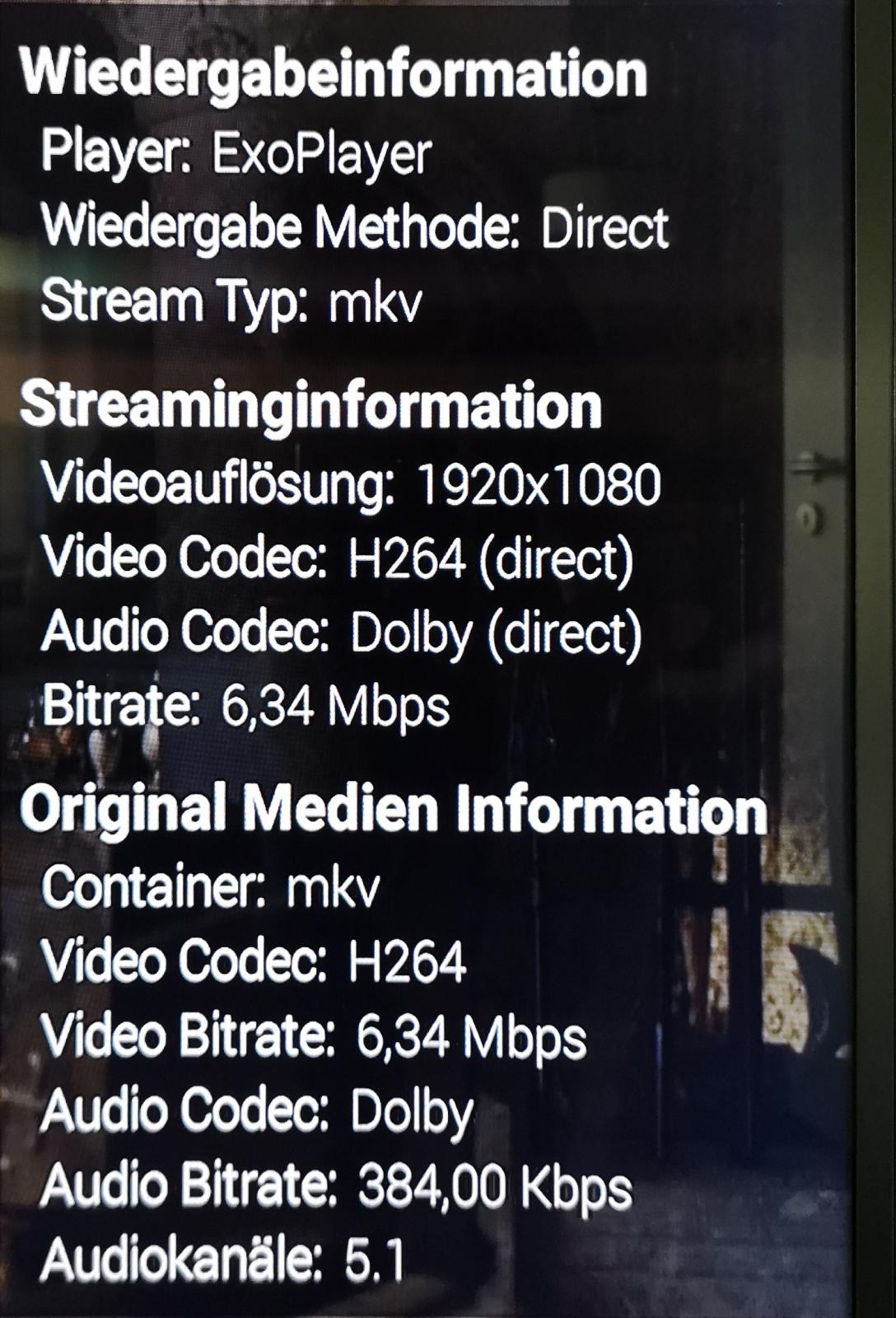

mamoel 3 Posted June 27, 2018 Posted June 27, 2018 (edited) Hi, I'm quite new to emby, but now I have to report my first problem: My video files start to stutter after ~20 minutes - sound plays without problems. Stopping (not pause!) the video and then restarting fixes the problem for the next ~20 minutes. This happens with all the episodes in this format: 1080p 25fps. My playback device ist the NVidia Shield ATV (2017) with the newest firmware Shield Experience Upgrade 7.0.1 (Oreo). It is set to 4K 422 12 bit 59.94 HZ. When I start playback in emby the display correctly switches resolution and refresh rate to 1080p 25Hz 422 12bit. Emby server is installed on my Synology DS418play (DSM6.2, upgraded to 6GB RAM). It was installed as described here. Transcoding is deactivated so I can't attach the transcoding log. In the attached server log, you can see that I started watching at 21:18:30 and stopped the first time at 21:35:46 because of stutter. Then I restarted and stopped again at 21:55:34. This is what Mediainfo shows: Format : Matroska Format version : Version 4 / Version 2 File size : 2.14 GiB Duration : 54 min 55 s Overall bit rate : 5 567 kb/s Encoded date : UTC 2014-06-24 09:27:20 Writing application : mkvmerge v6.9.1 ('Blue Panther') 64bit built on Apr 18 2014 18:23:38 Writing library : libebml v1.3.0 + libmatroska v1.4.1 Video ID : 1 Format : AVC Format/Info : Advanced Video Codec Format profile : High@L4 Format settings : CABAC / 3 Ref Frames Format settings, CABAC : Yes Format settings, RefFrames : 3 frames Codec ID : V_MPEG4/ISO/AVC Duration : 54 min 55 s Bit rate : 4 688 kb/s Width : 1 920 pixels Height : 1 080 pixels Display aspect ratio : 16:9 Frame rate mode : Constant Frame rate : 25.000 FPS Standard : Component Color space : YUV Chroma subsampling : 4:2:0 Bit depth : 8 bits Scan type : Interlaced Scan type, store method : Separated fields Scan order : Top Field First Bits/(Pixel*Frame) : 0.090 Stream size : 1.80 GiB (84%) Default : Yes Forced : No Color range : Limited Color primaries : BT.709 Transfer characteristics : BT.709 Matrix coefficients : BT.709 Audio #1 ID : 2 Format : AC-3 Format/Info : Audio Coding 3 Codec ID : A_AC3 Duration : 54 min 55 s Bit rate mode : Constant Bit rate : 384 kb/s Channel(s) : 6 channels Channel positions : Front: L C R, Side: L R, LFE Sampling rate : 48.0 kHz Frame rate : 31.250 FPS (1536 SPF) Bit depth : 16 bits Compression mode : Lossy Delay relative to video : -200 ms Stream size : 151 MiB (7%) Language : German Service kind : Complete Main Default : Yes Forced : No Audio #2 ID : 3 Format : AC-3 Format/Info : Audio Coding 3 Codec ID : A_AC3 Duration : 54 min 55 s Bit rate mode : Constant Bit rate : 384 kb/s Channel(s) : 2 channels Channel positions : Front: L R Sampling rate : 48.0 kHz Frame rate : 31.250 FPS (1536 SPF) Bit depth : 16 bits Compression mode : Lossy Delay relative to video : -200 ms Stream size : 151 MiB (7%) Language : English Service kind : Complete Main Default : No Forced : No The same files play without problems on my Raspberry Pi with Kodi and even on the Shield ATV with Kodi. Any help would be appreciated, especially because I bought the lifetime subscription :-) 01.07.2018 *removed log* Edited July 1, 2018 by mamoel
Luke 42245 Posted June 27, 2018 Posted June 27, 2018 Hi, just want to confirm, if you reactivate transcoding, does this still direct play?
mamoel 3 Posted June 28, 2018 Author Posted June 28, 2018 Yes, just retested it with transcoding set to "allowed". It is still played "direct".
