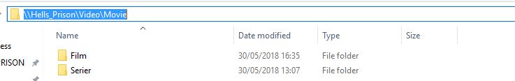

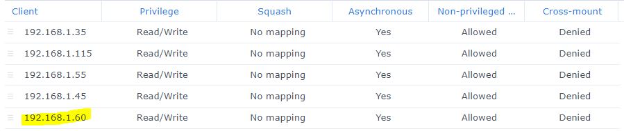

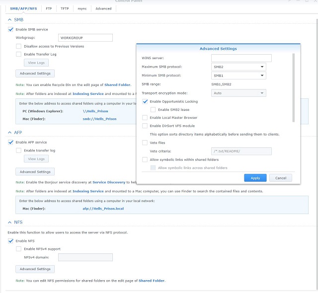

wollabille 17 Posted June 3, 2018 Posted June 3, 2018 (edited) Hi all. I hope that some one out there can help me with an issue, that from what i can gather is something that a lot of people have. I recently bought me a Nvidia Shield since i was suggested this device for 4K playback. But the issue i have, is i can't get it to work via Direct play, here i found a post where some one had it fixed, but without any explanation on how he did it. So thats why i now come to the site, to all the brains I will start with my setup. I have all my media in a Synology DS918+ where the path to the folders (movies and series) are as follows: IP Address 192.168.1.30 I have the Emby server installed on my old NUC with IP 192.168.1.55 The Nvidia Shield has IP : 192.168.1.60 When running the setup on the Shield, it finds the Emby server fine. As soon as i come to the Native part i get the same problem as this post It finds everything fine but as soon as i try to play something, it says it can't locate the file, and asks me to delete the path. The path i have tried for the network credentials are the following: \\Hells_Prison\Video\Movie \\Hells_Prison\Movie \\Hells_Prison And also insted of Hells_Prison i have tried with the IP address 192.168.1.30 Now i have 2x NUC pc's and it works flawlessly there. In the Synology i have given access to the Shield (Marked in yellow) 45/55 are the 2 NUC's. I have even tried to reset Kodi on my main PC (192.168.1.35) to set it up again. And i got it to work instantly. So from all that i read there are some issues with Kodi on Android (called SPMC?? correct me if im wrong) and using Native. But it works "fine" in Addon. I write "fine" because i have experienced some micro stuttering (which might be able to be fixed according to this post from poster Domg73) But thats another matter. The Is there something i'm missing, then just ask away!? Please and Thank you for the help Edit: I forgot to write that both the Shield, Kodi and emby is running the newest versions. Edited June 4, 2018 by wollabille
sualfred 677 Posted June 4, 2018 Posted June 4, 2018 (edited) Try to set the maximum SMB protocol to SMB3. Also read: https://forum.kodi.tv/showthread.php?tid=314350 Edited June 4, 2018 by sualfred
