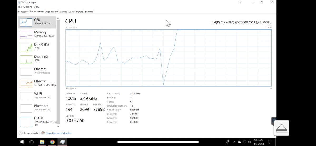

OSBuckeyes4Life 12 Posted January 5, 2018 Author Posted January 5, 2018 I mean I can stream the crap external network, this picture, and I wanted to try and max it out, but I had up to 7 videos playing at once. All tests are external, mobile network. Different network, he has Cerizon and I have AT&T but both unlimited data, so it’s not a network issue. But yes that video plays fine on his phone and not on my iPhone.

OSBuckeyes4Life 12 Posted January 5, 2018 Author Posted January 5, 2018 I was proving that it is not Windows firewall and that it is in-fact an issue with the iOS device. If it was Windows FW, I would not be able to get to it at all. Sorry got sidetracked. I was also just trying to see how many I could do on that CPU. just putting in a claim for bragging rights.
