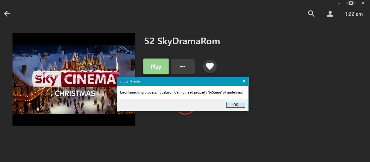

kikinjo 294 Posted January 4, 2018 Posted January 4, 2018 Hi Emby theater cant play live tv streams at all, error in screenshot, while Emby WMC app from windows store plays it without any issue, same m3u, same channels. Really interesting, i will dig up logs and posti it. Windows 10, V1607, latest Emby server.
jasonwilliams 37 Posted January 4, 2018 Posted January 4, 2018 I also noticed that the full Emby client won't always playback the M3U stream. When I launch a channel, the spinning wheel just spins for several minutes and then 50% of the time it will start playback. I was going to report this later today, so I'll send logs when I get home. I have not received the error message reported by kikinjo. Thanks.
kikinjo 294 Posted January 4, 2018 Author Posted January 4, 2018 Same here Jason, spinning and in rare cases stream starts. Other than that this error and spinning... Weird is that Windows store client runs iptv streams without an issue.
Luke 42243 Posted January 4, 2018 Posted January 4, 2018 @@kikinjo, did you setup an external player?
kikinjo 294 Posted January 4, 2018 Author Posted January 4, 2018 @@kikinjo, did you setup an external player? Hi Luke, Yes i did, afterwards i removed it. Tried to test the iptv provider. After removal this error does not pops up, but live tv is loading (spininig circle). Trying to find in logs something about it but no luck yet.
