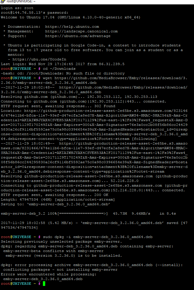

tdiguy 99 Posted November 29, 2017 Posted November 29, 2017 You will need to do the following. cd ~/Downloads wget https://github.com/MediaBrowser/Emby/releases/download/3.2.36.0/emby-server-deb_3.2.36.0_amd64.deb sudo dpkg -i emby-server-deb_3.2.36.0_amd64.deb
dcrdev 255 Posted November 29, 2017 Posted November 29, 2017 hi thanks but getting this error That's because the link has been truncated by the forum software, as @@tdiguy hasn't put it in a code block, your not actually downloading anything. Start again: cd ~/Downloads wget https://github.com/MediaBrowser/Emby/releases/download/3.2.36.0/emby-server-deb_3.2.36.0_amd64.deb sudo dpkg -i emby-server-deb_3.2.36.0_amd64.deb
xavier 1 Posted November 29, 2017 Author Posted November 29, 2017 thankyou getting somewhere now but came across this now

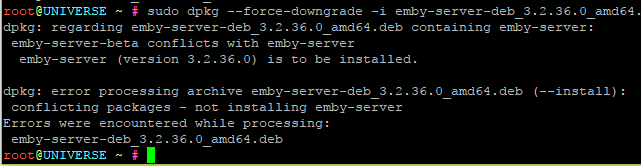

dcrdev 255 Posted November 29, 2017 Posted November 29, 2017 Try this instead: sudo dpkg --force-downgrade -i emby-server-deb_3.2.36.0_amd64.deb

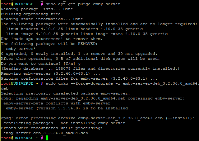

dcrdev 255 Posted November 29, 2017 Posted November 29, 2017 I'm not a debian guy, but you could try: sudo apt-get purge emby-server Before running dpkg again...
dcrdev 255 Posted November 29, 2017 Posted November 29, 2017 Oh I see you've installed the beta version... Do this then try dpkg sudo apt-get purge emby-server-beta
xavier 1 Posted November 29, 2017 Author Posted November 29, 2017 ok thank you that as now downgraded is there a way of downgrading without wiping it clean , content, users etc
