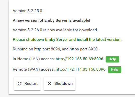

jutn25 0 Posted August 5, 2017 Posted August 5, 2017 Hi, Im currently running version 3.2.25.0 on Ubuntu 16 and when i run the cmd sudo apt update && sudo apt upgrade -y it does not upgrade the emby server. This cmd use to work all the time. Is there another command that I can input to update the server. Thanks !
Luke 42245 Posted August 5, 2017 Posted August 5, 2017 hi @@jutn25 can you please describe exactly the issue that you're seeing? What exactly happens when you try to update? Do you get an error message? If so, what does it say? thanks.
jutn25 0 Posted August 6, 2017 Author Posted August 6, 2017 (edited) The issue is that when I enter the above command, it doesnt update emby on my server "/ The command I used always worked and when I log onto the dashboard I would no longer see the message of a new update. I was wondering is there a more specific command to tell emby to update and not a command that just updates my whole server. Also i do not receive any error messages. Edited August 6, 2017 by jutn25
jutn25 0 Posted August 7, 2017 Author Posted August 7, 2017 (edited) So i figured it out. when i upgraded from Ubuntu 14 to 16. Emby was not on the list for updating. A key was expired. Edited August 7, 2017 by jutn25
Marvel emby 0 Posted August 7, 2017 Posted August 7, 2017 im also having the same issue on my servers how did you fix this ? i normally use apt-get update && apt-get dist-upgrade and normally updates fine but wont now 2x servers on ubuntu 16 and 1x ubuntu 17
Jdiesel 1437 Posted August 7, 2017 Posted August 7, 2017 im also having the same issue on my servers how did you fix this ? i normally use apt-get update && apt-get dist-upgrade and normally updates fine but wont now 2x servers on ubuntu 16 and 1x ubuntu 17 Just follow the initial install instructions again to download and add the key. https://emby.media/linux-server.html
