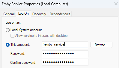

rbjtech 5335 Posted March 23, 2023 Posted March 23, 2023 (edited) So you need to create a 'service account', give it permission to logon as a service (and give it access to the shares) and use that as the 'Log On As' account in the service setup. for example - Also - I would not put the cache on smb shares - performance will be very degraded. Edited March 23, 2023 by rbjtech
nonyhaha 4 Posted March 23, 2023 Posted March 23, 2023 1 hour ago, rbjtech said: So you need to create a 'service account', give it permission to logon as a service (and give it access to the shares) and use that as the 'Log On As' account in the service setup. for example - Also - I would not put the cache on smb shares - performance will be very degraded. Service is running under the exact same user as the app. The share is a zfs raidz pool of 4 ssds. I made that primarily for my sql and emby needs.
rbjtech 5335 Posted March 23, 2023 Posted March 23, 2023 3 minutes ago, nonyhaha said: Service is running under the exact same user as the app. The share is a zfs raidz pool of 4 ssds. I made that primarily for my sql and emby needs. Then it should work - there is no reason for it not to.

nonyhaha 4 Posted March 24, 2023 Posted March 24, 2023 Hello, Just a headsup to anybody doing this as a service. My problems seem to have come from the fact that i was pinting emby server to MAPPED NETWORK LOCATIONS. This does not work, I had to use the entire network address of the folders. Cheers! 1
rbjtech 5335 Posted March 24, 2023 Posted March 24, 2023 (edited) 3 hours ago, nonyhaha said: Hello, Just a headsup to anybody doing this as a service. My problems seem to have come from the fact that i was pinting emby server to MAPPED NETWORK LOCATIONS. This does not work, I had to use the entire network address of the folders. Cheers! Good shout. In emby I always use UNC path names even for local storage/drives and recommend anyone to do to the same as it adds a flexibility layer to the configuration. ie I created a shared drive on my local D : drive to be \\MEDIA\share - and in emby point it to \\MEDIA\share That way, if I want to even move the contents to lets say another local drive or even a NAS etc - all I have to do is move the 'share' - emby see's it no differently and I don't have to re-scan everything. Edited March 24, 2023 by rbjtech
