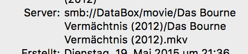

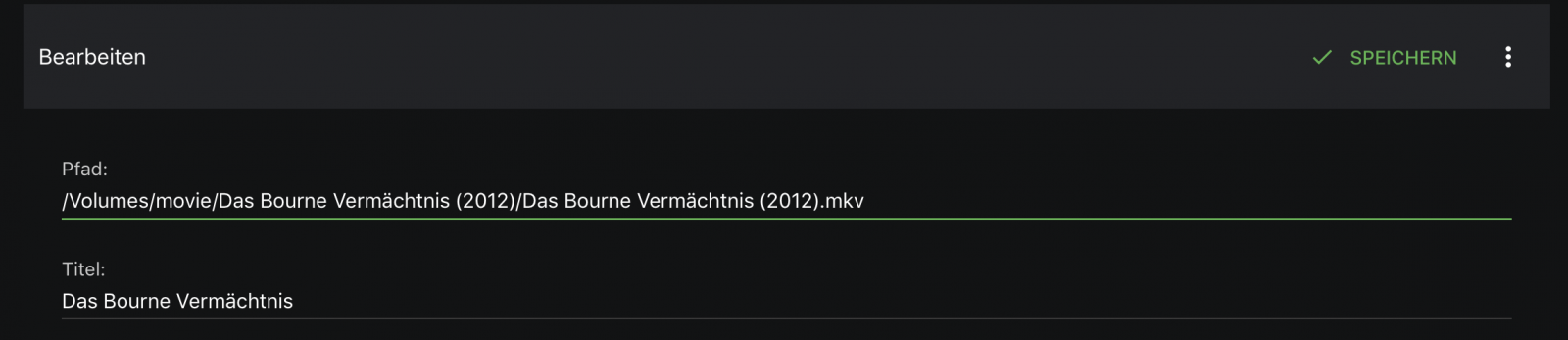

elChupete 2 Posted February 24, 2017 Author Posted February 24, 2017 Nope - path is correct (Mac File Info) and Emby Server MetaData Manager using substitution to replace smb://DataBox with /Volumes If filename and folder name is changed to ../movie/Das Bourne Vermaechtnis (2012)/Das Bourne Vermaechtnis (2012).mkv the movie is played. Just tried something else: added a "ä" to a filename, which previously did not contained any "umlaute". After Emby has updated and synced to Kodi - Movie not played Change back to original name - Movie played. Very Strange Will make sure not to use any special characters and rename existing files.... Strange though
