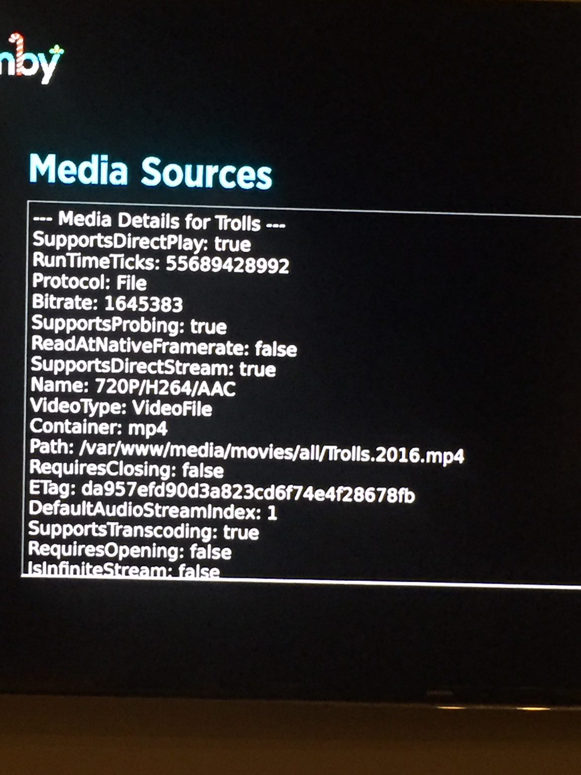

speechles 2062 Posted January 20, 2017 Posted January 20, 2017 (edited) Odd that roku calls it dolby digital plus. This means whoever answered that question has no idea WTF they are talking about. It is almost as if that is a scripted answer roku support replies with. Dolby digital plus is eac3. Dolby digital is ac3. You need to explain to roku support the difference between their ass and a hole in the ground. Haw Level 31 for the video.. What is the refframes? You can see this using the blue neon app. Choose the show overview/info button from an items detail screen. If not taken directly to media information, choose it on the overview screen. How many refframes is the video stream (your image doesnt say)? The issue is when transcoding. What version is your ffmpeg? Are you windows or *nix flavored? Sent from my Nexus 7 using Tapatalk Edited January 20, 2017 by speechles
weas98 0 Posted January 20, 2017 Author Posted January 20, 2017 @@speechles - I attached all the information from the blue neon Emby app. Also if I force direct stream movie plays at correct speed without sound. Forcing direct play and transcode play in Fast Forward. Sent from my iPhone using Tapatalk
speechles 2062 Posted January 21, 2017 Posted January 21, 2017 (edited) Snap.. I remember this now. You sent me a dropbox link already. It was the trolls movie. Yep. Problem is that damn dropbox link gets to 50% or 56% or 65% and speed goes to shit. Then I see, sweet, it failed ... WTF .. Why can't the internet shit just work. Scream at the dog real loud and blame it. Get away from me.. ARGHH.. Tried a bunch of times to grab that trolls thing but deemed it impossible on my measly 3mbit download speed. Which is odd, because I grab much larger things from usenet and torrents just fine and dandy as if it was cotton candy. Delicious. But yeah.. I remember this.. So I see, indeed there is no refframes reported. Now I am worried it is the dreaded 4 refframes and somehow it just isn't showing in media details. Maybe the file just needs to be refreshed? Can you refresh that file from the web interface and see if it gives a reference frame count after that? Do any refframes show on the web client for that trolls movie before you do this? It shouldn't because then it would show everywhere else, but maybe you have ghosts in your machine? Maybe? Doubtful.. Seriously curious what the refframes are for that movie.. @@ebr Can you probe that file and find out what the refframes are? I am assuming you were successful in getting the full file. Edited January 21, 2017 by speechles
