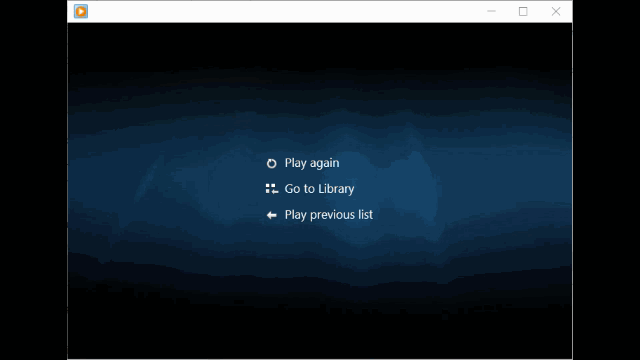

Guest asrequested Posted November 4, 2016 Posted November 4, 2016 (edited) I've had a few recordings like this. I think what's happening is that is records a space at the beginning, so when you play it back, the filters aren't detecting picture and switch off. When I play using MadVR the tray icon doesn't appear but the file is playing the sound, perfectly. The last time this happened (a few days ago), I was going to slice off the beginning and share it. But the edit software didn't register the blank space and the resulting file, played perfectly. If I play it in another player, the blank is visible. Edited November 4, 2016 by Doofus

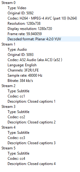

bungee91 133 Posted November 6, 2016 Posted November 6, 2016 (edited) I can hear the audio, but don't get video. Tried on two computers with Theater, also tried all video options (EVR, EVR+, MadVR) with the same results. Server shows direct playing for this file, this was recorded with the built in Live Tv. Same file plays fine with the Android app, also shows as direct play. Freshly booted server log attached, it should show the file being accessed in ET, and then from Android. If I need to submit a clip of the file itself, please let me know the easiest way to trim it and I'll post it. Plays fine in VLC, I added an attachment from the codec info when playing. EmbyServerLog.txt Edited November 6, 2016 by bungee91

Guest asrequested Posted November 7, 2016 Posted November 7, 2016 Do they play in windows media player? I'm guessing no based on the first post? Yes they do. It plays in everything but ET. I only captured the first few seconds to show that it does start playing after the blank space. In ET, you just get the audio, no picture. I think when the file is probed, it finds no video and just plays the audio. I could share the video, but its 4.5 GB

speechles 2062 Posted November 7, 2016 Posted November 7, 2016 Its that delay relative to video. Notice the number is negative. So the audio starts before the video. This is probably causing that "blank" spot you mention. The framerate shown is also wacky sauce. Heh Sent from my Nexus 7 using Tapatalk
