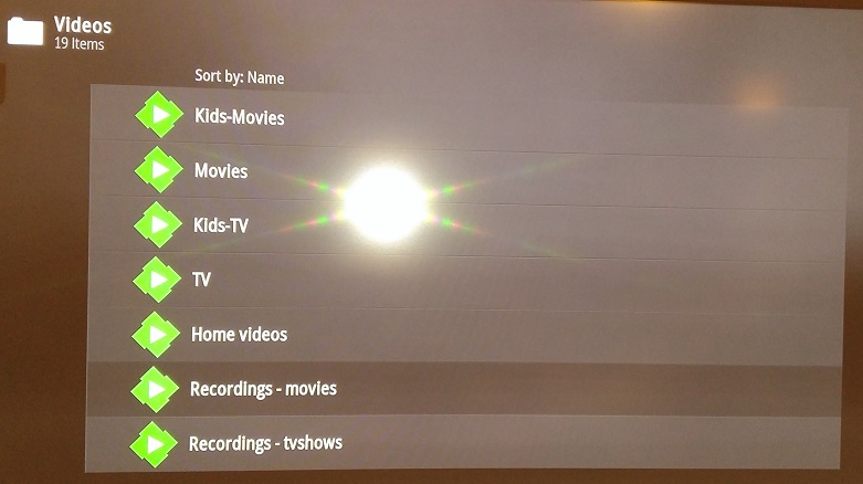

Where are they displayed as movies?
Hi,
They are appearing in Kodi under Recordings-Movies as shown below, this then seems to loads the contents into the local movie library on kodi
however I have now got round the problem by stopping the user used by kodi having access to the recordings library.
but these seems like a work around?

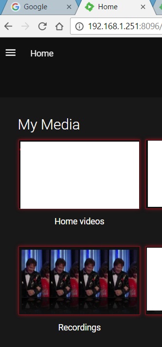

How do they look in the Emby web app?
In libraries they appear in recordings :-
in Movies as shown below they do not appear :-
So it is only a problem in Kodi?

Is recording a mixed library? Is recording - tvshows empty? I don't see how what you are seeing is possible. We request from the server, using the media type. We say, emby, return Movies from recordings, then process them as movies. Then, we process Series from recordings. So the only explanation seems your recordings get the content type movies server-side at some point and maybe what you are seeing is leftover stuff from when it was first added to Kodi.
If you run a manual sync, does it rectify the situation? Launch the emby add-on > manual sync
Can you please provide your Kodi log capturing this issue? If you know in advanced when a recording will occur, enable the add-on log level to debug prior to it being processed by your server (addon settings > advanced tab > log level debug), then post your log. This will tell us exactly what is happening.
