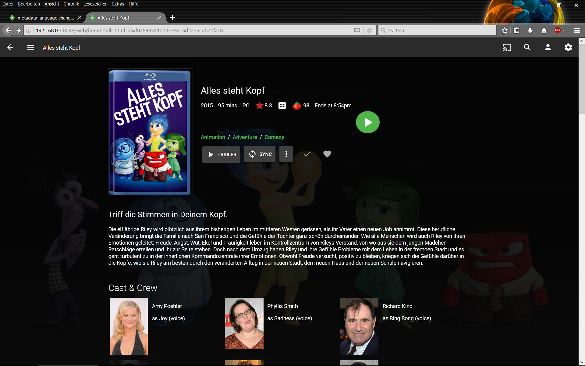

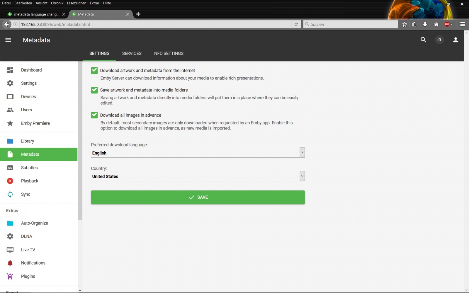

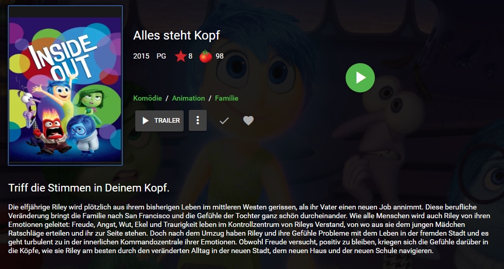

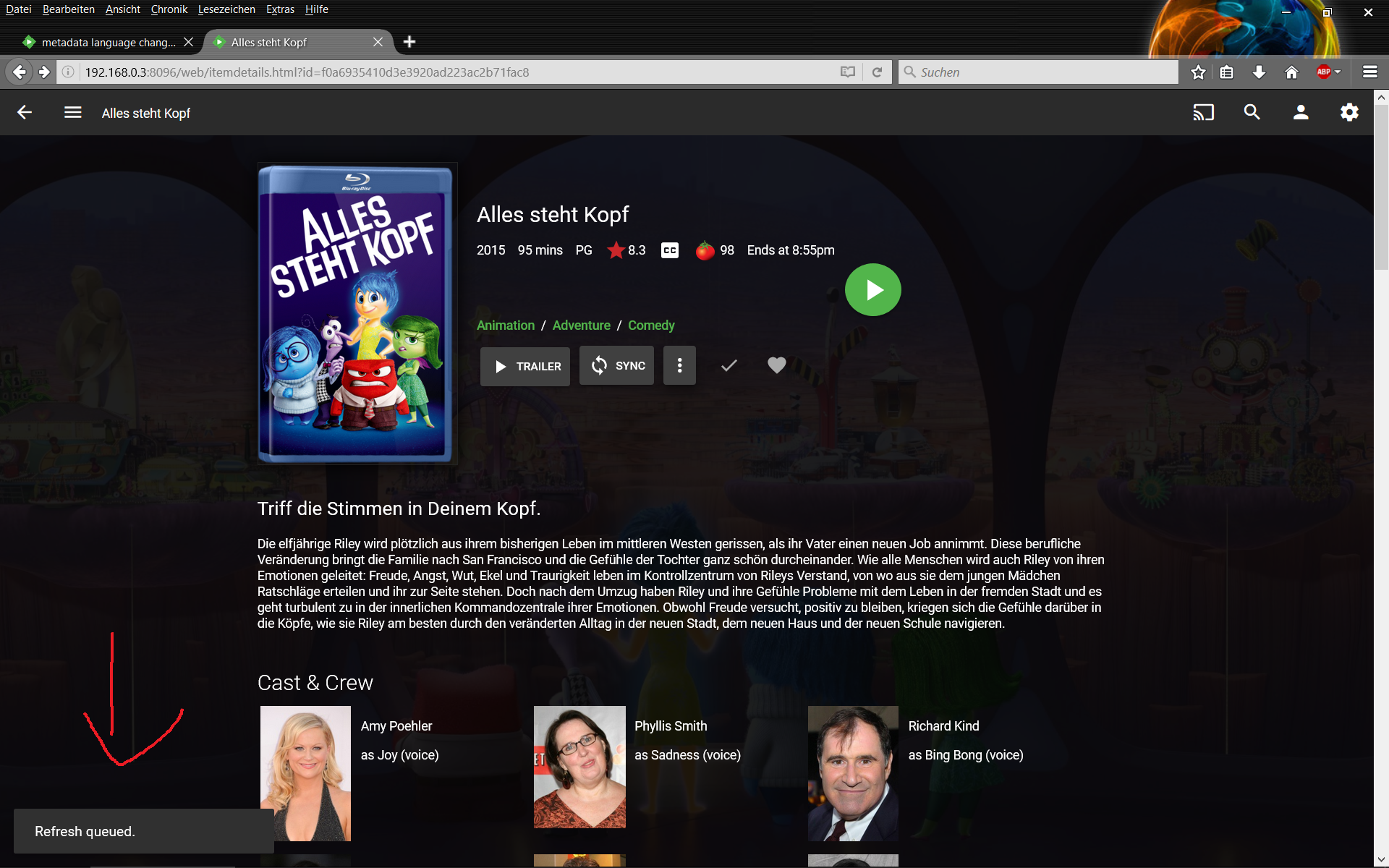

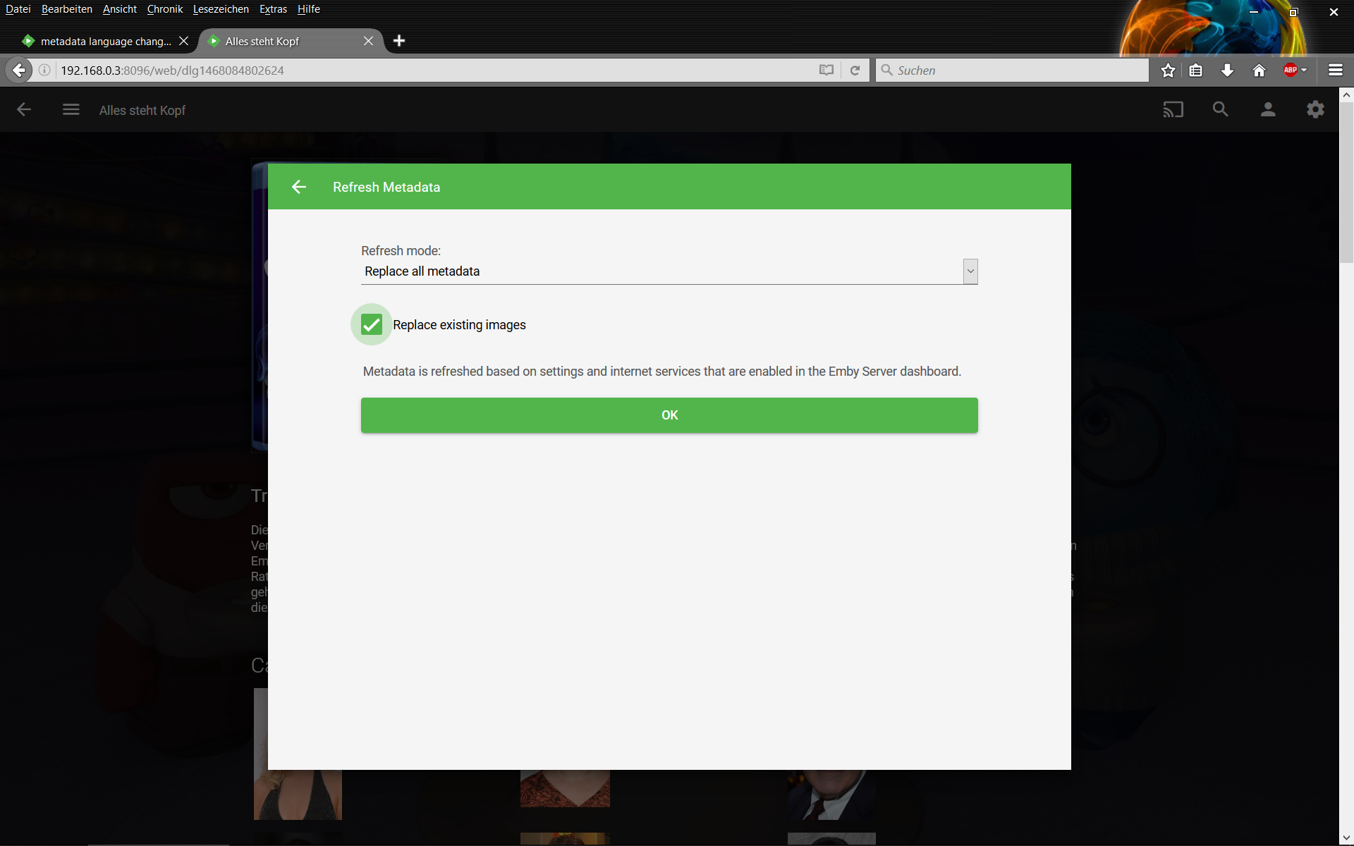

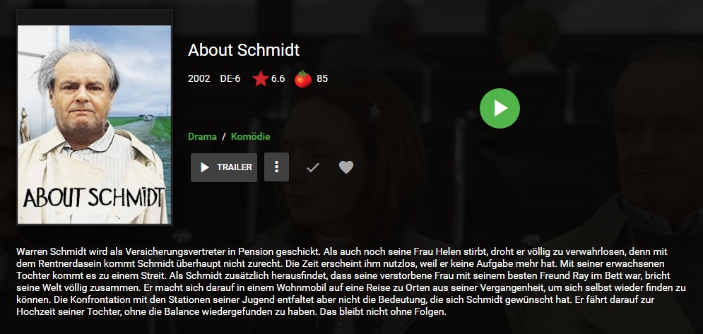

horstepipe 422 Posted July 8, 2016 Posted July 8, 2016 hey Because Emby can download metadata and images only in the same language, I tried to accomplish different languages by the following "trick": My movies have German images (posters, banners etc) and German metadata (plot..), but I want the images to be English. So, in metadata settings I changed preferred language for downloads to English. I picked a movie and refreshed it with these settings Search for missing metadata Replace existing images in the hope that my existing metadata stays German and the images are being swapped with English ones. Unfortunately nothing has changed, everything stays German. So I tried to refresh with replace all metadata but the plot is still German. So changing the language of the scraper doesn't seem to work at all at the moment..? Regards
Luke 42186 Posted July 8, 2016 Posted July 8, 2016 Hi, as you can see, no problem here when switching between english and german. Please discuss a specific example, and see how to report a problem. Thanks!
horstepipe 422 Posted July 8, 2016 Author Posted July 8, 2016 mhh ok it's really strange, some movies work, some don't. Here are three example movies Inside Out (2015) (German title: Alles steht kopf) - doesn't work About Schmidt (2002) - doesn't work A perfect World (1993) - works

Luke 42186 Posted July 9, 2016 Posted July 9, 2016 The metadata language is German so you must not have configured it to English.

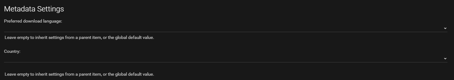

horstepipe 422 Posted July 10, 2016 Author Posted July 10, 2016 (edited) The metadata language is German so you must not have configured it to English. to make it more clear: From my first problem description I went on to generalize my problem, I can't change the metadata language of most movies at all. So the shown movie is German and I can't make it English. Do these settings have values already set? no they haven't. As from my understanding when they're empty the global metadata settings are being used which are set to English atm. For test purposes I set the value here to English, too. Unfortunately, no change. What you get may also depend on the order of metadata providers. Not all metadata providers have multi-language results at all and some of our provider implementations default to English in case no localized info is returned. If one of such providers has a higher priority than another provider that would even have the localized info, still the English info would be used. A while ago I have provided a fix for this situation (https://github.com/MediaBrowser/Emby/pull/1731) but it hasn't been picked up yet. To further analyze the situation you can try my MetadataViewer plugin (http://emby.media/community/index.php?/topic/32984-new-plugin-metadata-viewer/). It displays metadata results from each provider in priority order from left to right and you can even compare the results for different languages. This way you'll immediately see what's happening here! But I guess all providers are able to fetch the data in English? So if not even this language works, this is most likely not the problem..? Edited July 10, 2016 by horstepipe

Solution Luke 42186 Posted July 10, 2016 Solution Posted July 10, 2016 In your log About Schmidt was configured for German, not English. This means you either didn't set the global language to English, or you have already customized the language for the movie to German, or have already customized the language for a parent folder to German. So please check all three of those. 1
horstepipe 422 Posted July 10, 2016 Author Posted July 10, 2016 (edited) or you have already customized the language for the movie to German here we have the problem. But I definitely did not set this up, I always just changed the global metadata settings. I randomly overlooked some movies in metadata manager, some have the language set to German, some don't. At least I know what's going wrong now, thank you! But how can I solve the problem? I don't want to select thousands of movies and change the settings separately. And removing the whole movie database and re-import it isn't the best idea either, because it would take days to recreate the coverart and chapter images in which my NAS is quite unusable because the CPU is maxed out Edited July 10, 2016 by horstepipe
