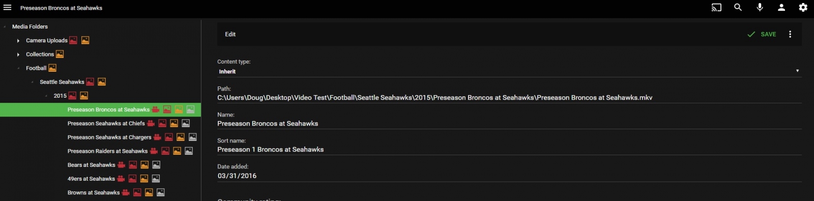

CrossCech 10 Posted March 31, 2016 Posted March 31, 2016 (edited) I have several american football games that I've recorded and archived. One of the major reasons I selected Emby for my media server, was the ability to manipulate custom metadata for my football games. I had them the way that I wanted, but a recent server update (3.0.5911.0) has seemed to throw things out of whack. In metadata manager, i would set Name: Team vs. Team, then Sort Name: 2015 Week 01 Team vs. Team. With an entire season listed, Emby Classic would show a correct list under Season 2015 using the preferred Team vs. Team, because I personally didn't want the additional 2015 Week 01 showing up ... felt it too cluttered. Today, I open Emby Classic only to find each season's list completely out of order, as well as out of order in metadata manager, even though the Name: and Sort Name: are correct. Has something changed in the server update that's caused it to not read Sort Name: correctly? Edit** It appears that metadata manager is listing all the games in alphabetical order using Name: and ignoring Sort Name entirely. There a check mark somewhere that's been added that I need to uncheck or something? Edited March 31, 2016 by CrossCech

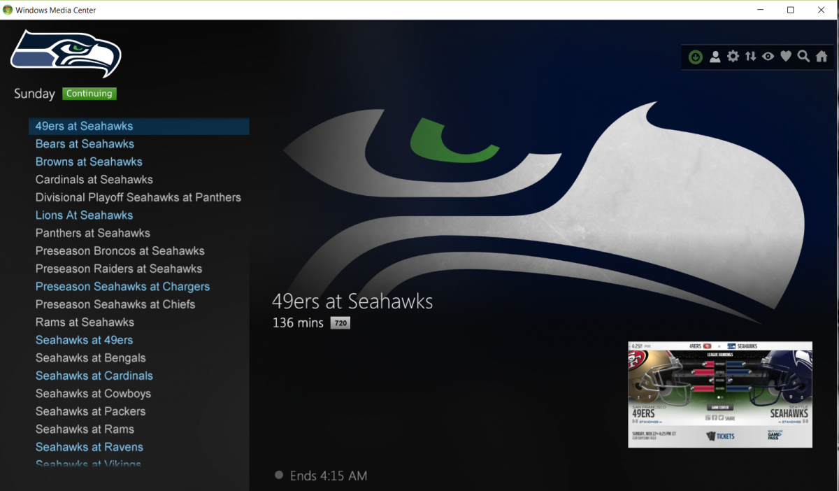

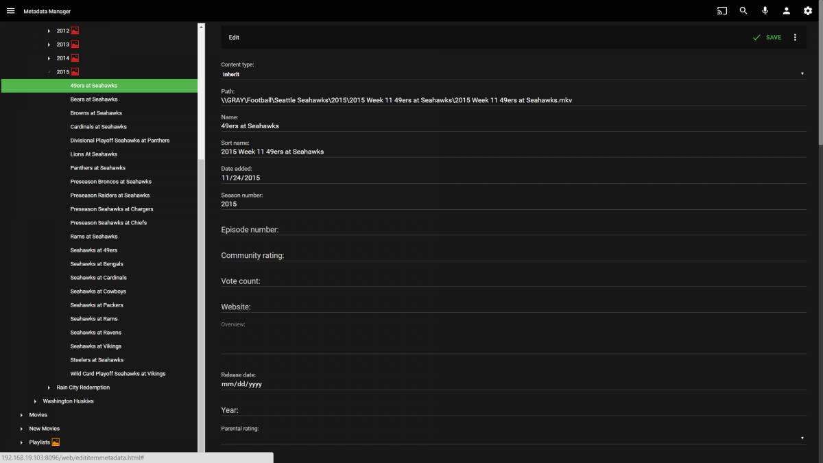

CrossCech 10 Posted March 31, 2016 Author Posted March 31, 2016 (edited) As you see in the left pane, all the games for season 2015 are listed in alphabetical order. Over in the right pane it shows a particular game sort name as 2015 Week 11 49ers at Seahawks which would normally have it 11th in the list, but because it's going alphabetical, it has it as the first game. The order of the games in the left pane is what shows up in Emby Classic. Before the recent server upgrade, the order would be 4 preseason games, then Week 01 - Week 17 then playoff games. The names that appear are correct, but would be ordered via the sort name which is now not being adhered to. Hope this makes sense. FYI, when using the android app or web client, the order was never correct. Only in Classic. It never concerned me with android and web, because I hardly ever streamed to devices that used those clients. Usually only watch the games on my Windows HTPC on the big screen with Classic. By the way, is Emby Classic 3.0.299 becoming a premium app? It upgraded on my family room HTPC and now it's buffering and only playing 36 seconds of video files before closing out the video. Apparently, there's a bunch of changes going on and I'm not keeping up or something. On another pc with Emby Classic, but not the latest version, everything plays fine ... still has football games out of order though ... which I think is more of a server issue than a client issue Resolved the 30 second playback limit problem by rejoining that troublesome pc back to the homegroup. Plays nicely again. Edited March 31, 2016 by CrossCech
Luke 42204 Posted March 31, 2016 Posted March 31, 2016 if it never was correct in the web client then i'm sorry but nothing has actually been broken. this is probably some special sauce applied by EMC and I'm sorry about that, but it's only there to try and keep things a certain way for older MB2 users. I really don't know what EMC was doing, but you've set these up as a TV library and episodes sort using season & episode numbers, not titles. So what i see are two options here - specify episode numbers OR change the library content type to plain home videos so that your custom sort names will be utilized.
CrossCech 10 Posted March 31, 2016 Author Posted March 31, 2016 (edited) you've set these up as a TV library and episodes sort using season & episode numbers, not titles. So what i see are two options here - specify episode numbers OR change the library content type to plain home videos so that your custom sort names will be utilized. I'm not sure how you determined that I'm using episode numbers. The above picture of metadata manager shows that info as blank. Metadata manager autofilled in the Season # on it's own. I'm using Name and Sort Name. I've actually had the football folder setup as Unset (mixed content). The metadata manager in the server used to list the games in the correct order using Sort Name. The above picture with the left pane now shows all of them in alphabetical order by Name and isn't using Sort Name at all. What's the purpose of Sort Name if it doesn't sort? Shouldn't Sort Name override Name if it's used? I believe this issue is with the server and not with EMC, though EMC was the only app I used that actually followed that I configured metadata manager to do. Using episode numbers would probably solve the problem, but what it does is add a # and other dots and whatnot in front of each game in EMC which I don't want. I like how it looks in the above picture of EMC with each game listed, just wish it would go back to using sort name so it would list the games in their correct order. As you can see from above, even the preseason games are out of order ... they should be at the top of the list ... not the middle. Used to be but a server update recently has changed that. Don't think EMC would affect Metadata manager on the server. Edited March 31, 2016 by CrossCech
Luke 42204 Posted March 31, 2016 Posted March 31, 2016 Sorry, what i mean is, the fact that the above screenshot shows the episode and season numbers indicates to me that you've set it up as a TV library. episodes are sorted using the season and episode numbers, then by name, so now that i'm looking at it, we might be able to change that last part to by sort name.

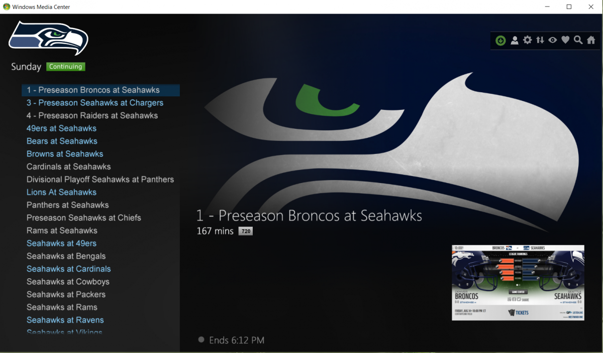

CrossCech 10 Posted March 31, 2016 Author Posted March 31, 2016 Here's an example of what I don't want to happen: After put in a 1 in episode # in MM, it now puts a 1 - in front of the game in EMC. Blech! Yes it's in the correct order, but is there a way to hide the number so it won't appear in EMC or any other client?
