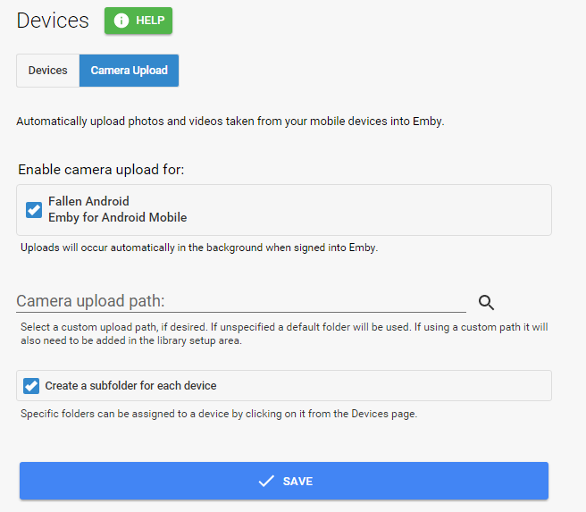

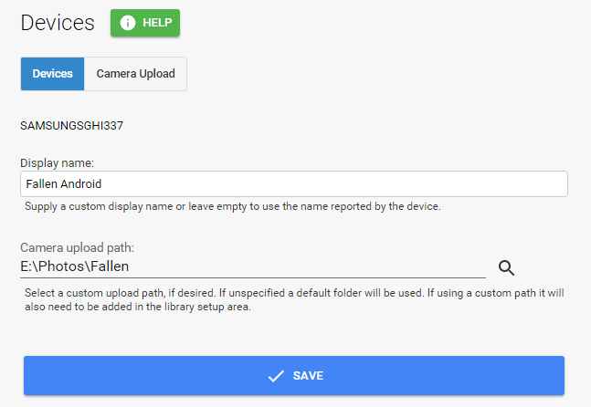

Fallen Archangel 0 Posted December 31, 2015 Author Posted December 31, 2015 (edited) Here is the sync log from my android devicehttp://pastebin.com/r0Uf8gWjAnd here is the other log file beside it.http://pastebin.com/Ygxii3EwThe most recent log from the emby server is to large to use with pastebin, so I have postedThe first 150 linesand the last 150 lines.If you need the full file, I will upload it to a file hosting website.EDIT:Just an update, I started a second server on a Windows 10 machine. It's set up mostly the same, but I made sure path substitution was set up, and that everyone had full access to the library location. Still the same results. Because of this I'm starting to think I'm doing something incorrectly on my configuration. And whatever it is, it's probably not related to the fact it was running on Ubuntu.Devices - > DevicesDevices - > Camera Upload And I have to seperate librarys set for photos, just in case.One is E:\Photos\ , the other is E:\Photos\Fallen\On my android device, I have Sync only on WiFi unchecked, and have enabled camera upload below it.If I go to Settings -> Accounts -> Emby , The sync Emby option is checked, and I have also tried the "Sync Now" option. Edited January 1, 2016 by Fallen Archangel

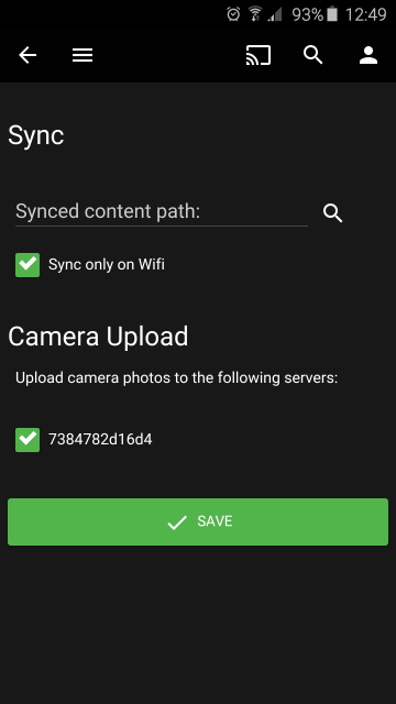

Banjo 2 Posted June 3, 2016 Posted June 3, 2016 ok, I think I've got it. The Wiki seems to be out of date: https://github.com/MediaBrowser/Wiki/wiki/Camera-upload Not only do we have the Camera Upload path in the Devices section but there's also the Sync > Camera Upload settings which let you set another path. This was no set for for me. Turn it on allows a manual sync from the phone to upload photos. That just leaves auto-upload. When I take a photo, the Emby app is not noticing the new photo and syncing it. I have to manually open the app and run the sync.
Luke 42243 Posted June 3, 2016 Posted June 3, 2016 it will auto-sync every hour. check your system settings under settings-> accounts to make sure it hasn't been turned off.
