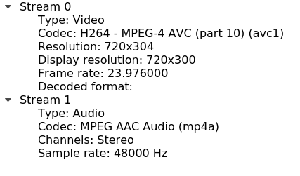

psi 1 Posted December 6, 2015 Author Posted December 6, 2015 getting somewhere 'diect stream' works!! and going back to auto, re-enables transcoding. this is what VLC says about the test file

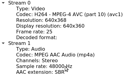

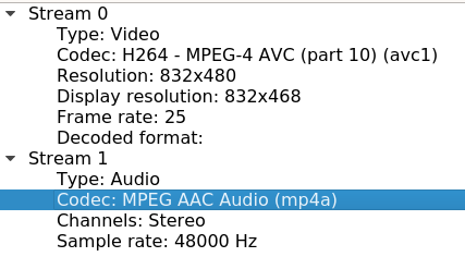

psi 1 Posted December 6, 2015 Author Posted December 6, 2015 just one more, unless others would be helpful.

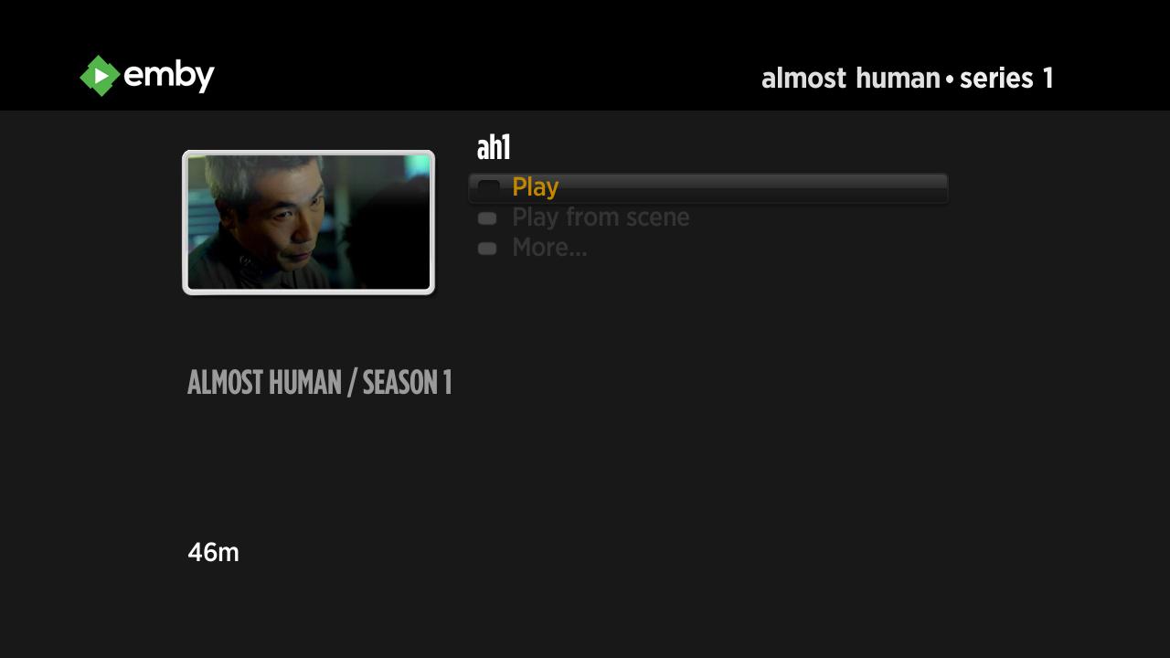

psi 1 Posted December 6, 2015 Author Posted December 6, 2015 i don't see that, i get the file name and length in mins only, whether the media is transcoded or not.
