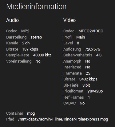

Most of my movies are MPEG2 Movies recorded from TV and converted to MPEG2-PS (extension .MPG).
If i play these files with Emby i get the error message from my TV "not supported file format" (translated from german -> "Nicht unterstütztes Dateiformat").
They are not transcoded because of the DirectPlayProfile (See Smart TV CD Series.xml). My TV is able to play such movies.
With Serviio it is no problem to play these files without transcoding.

I still do not understand why the MPGs are not played by my TV.
In the Log i can see the link to the movie
http://192.168.2.117:8096/videos/aebb4c4209d0139cb47987173d087177/stream.mpg?Params=52b4bc522ffc5b95a57aadf12954e8d6;test;aebb4c4209d0139cb47987173d087177;true;;;;;;;;;;;0;;;;;;;;;aebb4c4209d0139cb47987173d087177
If i put this in the adress field of my browser, the movie ist played immediately!
When one movie ist not played, then the tv tries do play the next, until i close the media player of my tv. Tha tis the reason of the 3 "HTTP HEAD http://192.168.2.117:8096/videos/.../stream.mpg?"
I allready changed the Flags of ProtocolInfo "http-get:*:video/mpeg:DLNA.ORG_PN=MPEG_PS_PAL;DLNA.ORG_FLAGS=9D700000000000000000000000000000", but without success.
It is possible to play the movie on the TV, if i change the profile to transcode MPGs, but this is not what i want.
Does Emby give wrong values for bitrate, movie length, etc., that makes Samsung TV unable to play the movie? Does someone have a hint, where i can start/continue searching?
