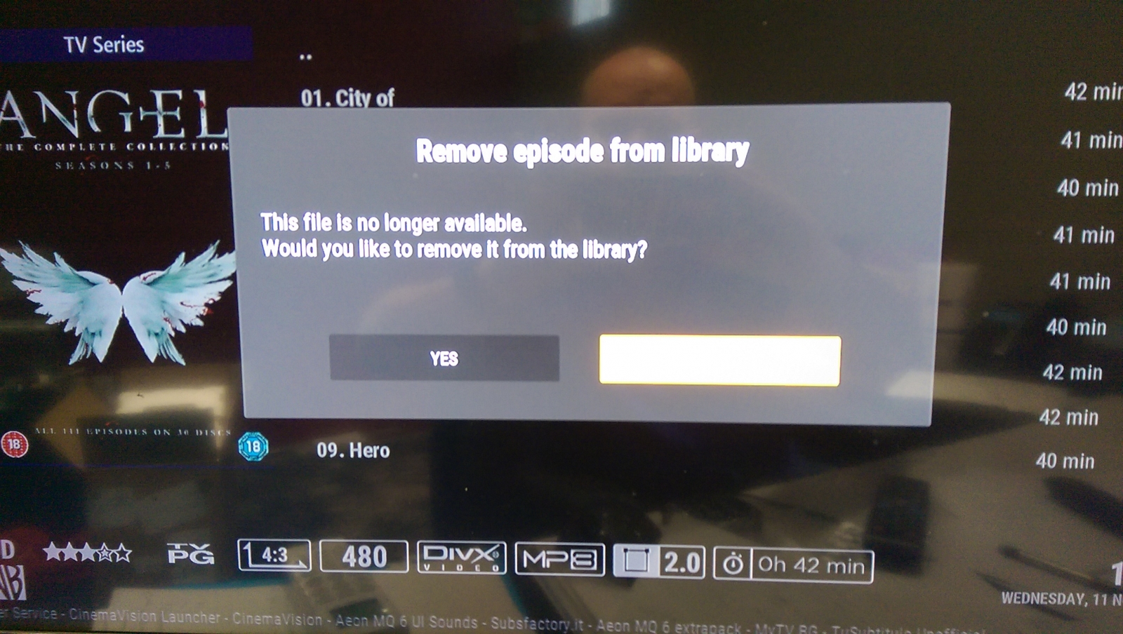

Dizzy49 99 Posted November 10, 2015 Posted November 10, 2015 I set up Emby for Kodi (14.1) on my Matricom G-Box Q. The sync appeared to go fine, and I can see all of my movies and shows. However, when I go to play anything (movies or TV) I get a box saying the file is no longer available and should it be removed from the library. No sure what's going on. Suggestions?

Dizzy49 99 Posted November 11, 2015 Author Posted November 11, 2015 It is still not working for me Here are my folders setup in the Library: http://prntscr.com/91lzg2 http://prntscr.com/91lznb Here is my path subs: http://prntscr.com/91lzy8 Below is the Add-On Settings. What am I missing? This is the actual error I'm getting:
