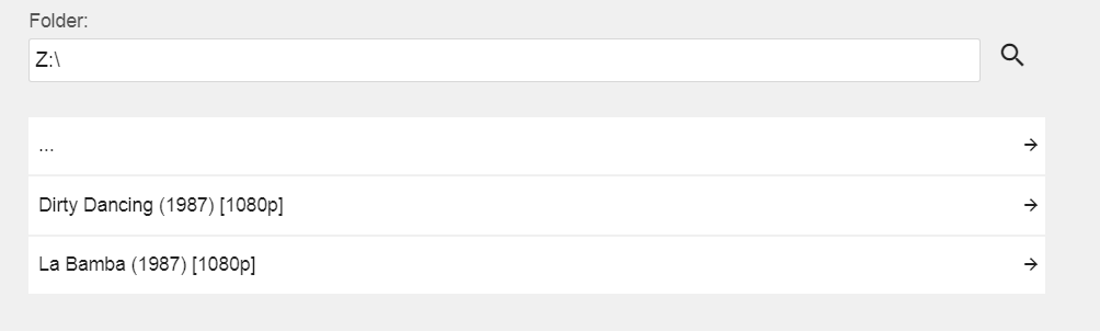

EODCrafter 181 Posted August 11, 2018 Posted August 11, 2018 (edited) This has never really been answered. I have emby installed on Windows server 2012 100 Gb SSD. My tv shows and movies are on drive d and I have even mapped the network drive but I still get the same error as above if I try to add the library. I obviously can't move a whole lot to a 100 Gb SSD so what is the answer to this please? There was an error adding the media path. Please ensure the path is valid and the Emby Server process has access to that location. Edited August 11, 2018 by EODCrafter
Luke 42212 Posted August 11, 2018 Posted August 11, 2018 Hi there, please attach the information requested in how to report a problem. Bear in mind, we highly discourage adding mapped drives to Emby and instead just add the original network location.
EODCrafter 181 Posted August 11, 2018 Posted August 11, 2018 (edited) Thanks @@Luke, I don't think this is Emby related but if I can't figure it out I'll send the logs. I'm pretty sure it's a simple Permission problem, that I can't figure out. Yes.....That was it. I copied the Server data from Drive C:, Windows 10 Drive, and put it on Windows Server and that User that was created for Emby did not have access on Windows Server. Solution: I recreated the Server with the Administrator Account and all is well. Edited August 11, 2018 by EODCrafter
