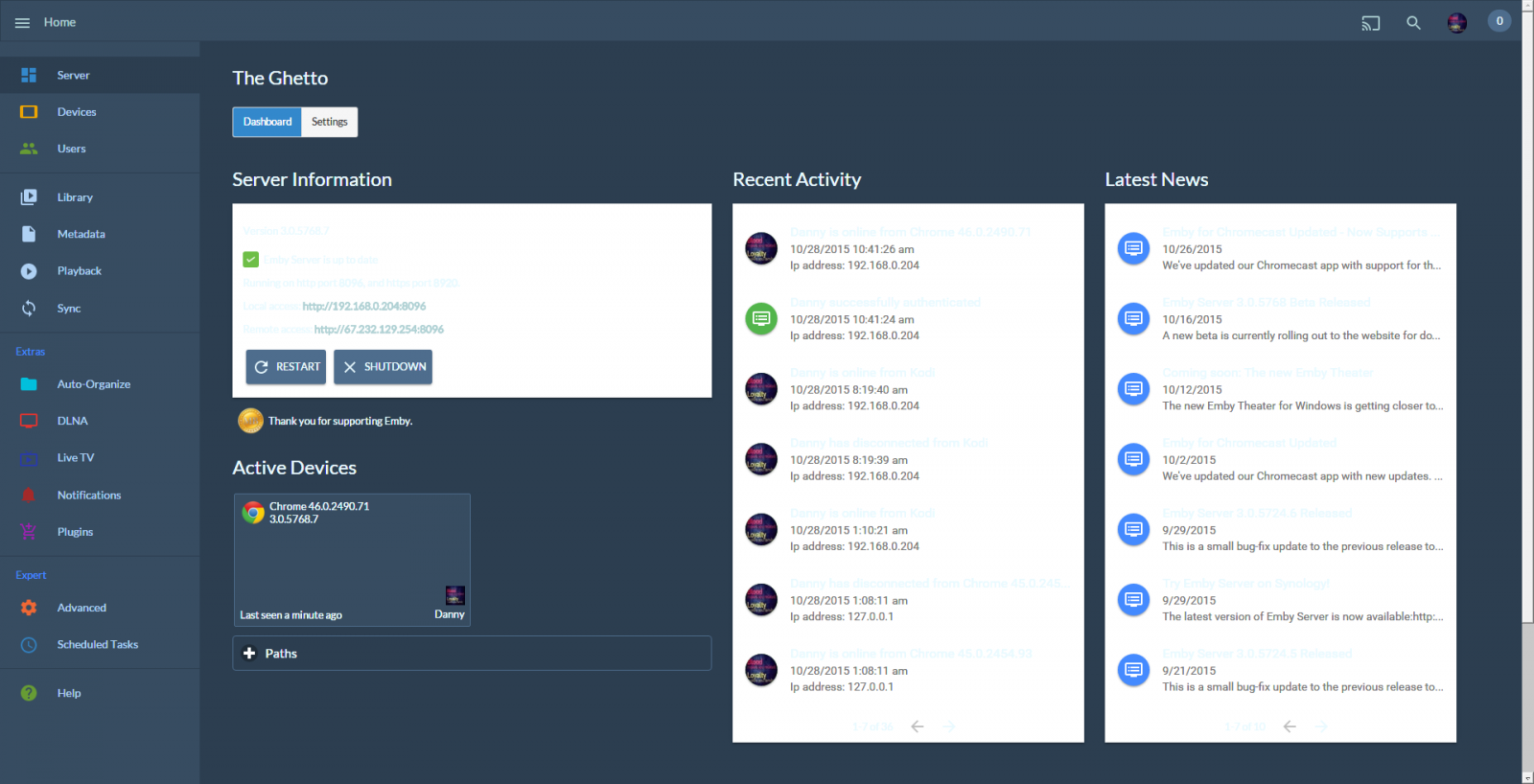

Blueeyiz702 223 Posted October 28, 2015 Posted October 28, 2015 Is the white area part of the server upgrade? it changed my css,from showing all blue to the white areas showing instead of blue?
Luke 42185 Posted October 28, 2015 Posted October 28, 2015 well it didn't change your css, but rather, your css has never seen those new markup elements before
