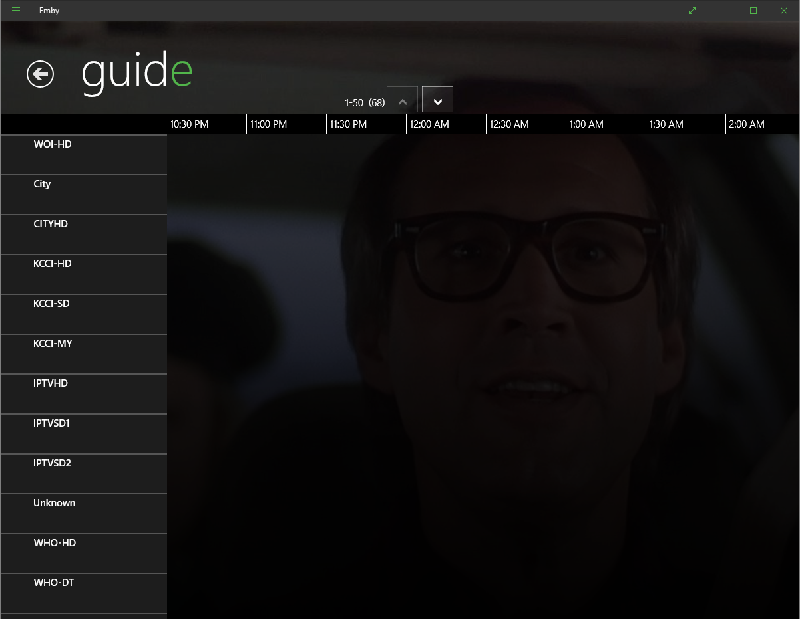

BrianG 11 Posted August 11, 2015 Posted August 11, 2015 I am trying to get EmbyTV to access unencrypted cableTV (Mediacom). I installed the HDHomeRun tuner (Extend model), updated its firmware, signed up for a SchedulesDirect account, installed and configured the EmbyTV plugin in Emby, added the proper lineup in Emby as well as SchedDirect, but can not seem to get guide data. All I see is a list of my channels in Emby, but not what is on at what time (attachment "emptyguide.png"). When I refresh guide data, it takes about 1 second and then says it completed successfully but still no data. The Emby server log (attachment "embylog.txt") shows that it can't find data for channel xyz for all channels. But if I go to http://www.schedulesdirect.org/getdata (in their "report a lineup problem" page), I DO see data (attachment "sd_data_sample_xml.txt"). It seems like the channel mapping on the HDHomerun box is not mapping correctly to the data from Schedules Direct so Emby is never finding program data, or something like that. I tried flagging all the channels as favorites in the HDHomerun app. Restarting the MediaBrowser service doesn't help either. I can view live TV if I go to Channels and then click on a channel. I just never know what is on until it starts playing. Is this something I can fix? BTW: In a different computer, I have a Hauppauge TV tuner card and Windows Media Center has no problem getting guide data. sd_data_sample_xml.txt embylog.txt

BrianG 11 Posted August 11, 2015 Author Posted August 11, 2015 Thanks again. Hopefully someone from the Emby team can shed some light on this. Here is an excerpt from my server log pertaining to the channel guide request. FYI, 192.168.1.109 is the IP of the HDHomerun box: 2015-08-11 11:13:26.0280 Info - App: StartupTrigger fired for task: Refresh Channels 2015-08-11 11:13:26.0280 Info - App: Queueing task RefreshChannelsScheduledTask 2015-08-11 11:13:26.7826 Info - App: Executing Refresh Guide 2015-08-11 11:13:26.7826 Info - App: HttpClientManager GET: http://192.168.1.109/ 2015-08-11 11:13:26.8408 Info - EmbyTV: Start GetChannels Async, retrieve all channels for HDTC-2US-1050A1BD 2015-08-11 11:13:26.8408 Info - App: HttpClientManager GET: http://192.168.1.109/lineup.json 2015-08-11 11:13:26.8878 Info - EmbyTV: Found 87channels on host: 192.168.1.109 2015-08-11 11:13:26.8878 Info - EmbyTV: Only Favorites?True 2015-08-11 11:13:26.8878 Info - App: HttpClientManager POST: https://json.schedulesdirect.org/20141201/token 2015-08-11 11:13:27.1082 Info - EmbyTV: Authenticated with Schedules Direct token: *REDACTED* 2015-08-11 11:13:27.1082 Info - App: HttpClientManager GET: https://json.schedulesdirect.org/20141201/lineups/USA-IA14438-DEFAULT 2015-08-11 11:13:27.2486 Info - EmbyTV: Found 105 channels on the lineup on ScheduleDirect 2015-08-11 11:13:27.2486 Info - EmbyTV: Mapping Stations to Channel 2015-08-11 11:13:27.2486 Info - EmbyTV: Added 28 channels to the dictionary 2015-08-11 11:13:27.2486 Info - EmbyTV: Schedules Direct doesnt have data for channel: 5.1 WOI-HD 2015-08-11 11:13:27.2486 Info - EmbyTV: Schedules Direct doesnt have data for channel: 7.1 City 2015-08-11 11:13:27.2486 Info - EmbyTV: Schedules Direct doesnt have data for channel: 7.2 CITYHD 2015-08-11 11:13:27.2486 Info - EmbyTV: Schedules Direct doesnt have data for channel: 8.1 KCCI-HD 2015-08-11 11:13:27.2486 Info - EmbyTV: Schedules Direct doesnt have data for channel: 8.2 KCCI-SD 2015-08-11 11:13:27.2486 Info - EmbyTV: Schedules Direct doesnt have data for channel: 8.3 KCCI-MY 2015-08-11 11:13:27.2486 Info - EmbyTV: Schedules Direct doesnt have data for channel: 11.1 KDINHD 2015-08-11 11:13:27.2486 Info - EmbyTV: Schedules Direct doesnt have data for channel: 11.2 KDINSD1 2015-08-11 11:13:27.2486 Info - EmbyTV: Schedules Direct doesnt have data for channel: 11.3 KDINSD2 2015-08-11 11:13:27.2486 Info - EmbyTV: Schedules Direct doesnt have data for channel: 12.1 Unknown 2015-08-11 11:13:27.2486 Info - EmbyTV: Schedules Direct doesnt have data for channel: 13.1 WHO-HD 2015-08-11 11:13:27.2486 Info - EmbyTV: Schedules Direct doesnt have data for channel: 13.2 WHO-DT 2015-08-11 11:13:27.2486 Info - EmbyTV: Schedules Direct doesnt have data for channel: 13.3 WHO-DT 2015-08-11 11:13:27.2486 Info - EmbyTV: Schedules Direct doesnt have data for channel: 17.1 KDSM-DT 2015-08-11 11:13:27.2486 Info - EmbyTV: Schedules Direct doesnt have data for channel: 17.2 GET TV 2015-08-11 11:13:27.2486 Info - EmbyTV: Schedules Direct doesnt have data for channel: 17.3 GRIT TV 2015-08-11 11:13:27.2486 Info - EmbyTV: Schedules Direct doesnt have data for channel: 23.1 KCWI 2015-08-11 11:13:27.2486 Info - EmbyTV: Schedules Direct doesnt have data for channel: 39.1 ION 2015-08-11 11:13:27.2486 Info - EmbyTV: Schedules Direct doesnt have data for channel: 51.1 Hall 2015-08-11 11:13:27.2486 Info - EmbyTV: Schedules Direct doesnt have data for channel: 51.5 Fam 2015-08-11 11:13:27.2486 Info - EmbyTV: Schedules Direct doesnt have data for channel: 51.7 Com 2015-08-11 11:13:27.2486 Info - EmbyTV: Schedules Direct doesnt have data for channel: 51.11 DSC 2015-08-11 11:13:27.2486 Info - EmbyTV: Schedules Direct doesnt have data for channel: 51.13 FNC 2015-08-11 11:13:27.2486 Info - EmbyTV: Schedules Direct doesnt have data for channel: 51.17 RFD 2015-08-11 11:13:27.2486 Info - EmbyTV: Schedules Direct doesnt have data for channel: 51.19 TLC 2015-08-11 11:13:27.2486 Info - EmbyTV: Schedules Direct doesnt have data for channel: 51.21 WE 2015-08-11 11:13:27.2486 Info - EmbyTV: Schedules Direct doesnt have data for channel: 51.25 BTN 2015-08-11 11:13:27.2486 Info - EmbyTV: Schedules Direct doesnt have data for channel: 52.1 FX 2015-08-11 11:13:27.2486 Info - EmbyTV: Schedules Direct doesnt have data for channel: 52.5 ETV 2015-08-11 11:13:27.2486 Info - EmbyTV: Schedules Direct doesnt have data for channel: 52.7 NBCS 2015-08-11 11:13:27.2486 Info - EmbyTV: Schedules Direct doesnt have data for channel: 52.9 FS1 2015-08-11 11:13:27.2486 Info - EmbyTV: Schedules Direct doesnt have data for channel: 52.11 Univ 2015-08-11 11:13:27.2486 Info - EmbyTV: Schedules Direct doesnt have data for channel: 52.13 BET 2015-08-11 11:13:27.2486 Info - EmbyTV: Schedules Direct doesnt have data for channel: 52.15 Bravo 2015-08-11 11:13:27.2486 Info - EmbyTV: Schedules Direct doesnt have data for channel: 52.17 CNBC 2015-08-11 11:13:27.2486 Info - EmbyTV: Schedules Direct doesnt have data for channel: 52.19 APL 2015-08-11 11:13:27.2486 Info - EmbyTV: Schedules Direct doesnt have data for channel: 52.21 USA 2015-08-11 11:13:27.2486 Info - EmbyTV: Schedules Direct doesnt have data for channel: 52.23 Trav 2015-08-11 11:13:27.2486 Info - EmbyTV: Schedules Direct doesnt have data for channel: 53.1 CNN 2015-08-11 11:13:27.2486 Info - EmbyTV: Schedules Direct doesnt have data for channel: 53.3 HLN 2015-08-11 11:13:27.2486 Info - EmbyTV: Schedules Direct doesnt have data for channel: 53.5 TOON 2015-08-11 11:13:27.2486 Info - EmbyTV: Schedules Direct doesnt have data for channel: 53.7 TBS 2015-08-11 11:13:27.2486 Info - EmbyTV: Schedules Direct doesnt have data for channel: 53.9 TNT 2015-08-11 11:13:27.2486 Info - EmbyTV: Schedules Direct doesnt have data for channel: 53.11 SPIKE 2015-08-11 11:13:27.2486 Info - EmbyTV: Schedules Direct doesnt have data for channel: 53.13 TVLAND 2015-08-11 11:13:27.2486 Info - EmbyTV: Schedules Direct doesnt have data for channel: 53.15 CMT 2015-08-11 11:13:27.2486 Info - EmbyTV: Schedules Direct doesnt have data for channel: 53.17 MTV 2015-08-11 11:13:27.2486 Info - EmbyTV: Schedules Direct doesnt have data for channel: 53.19 NICK 2015-08-11 11:13:27.2486 Info - EmbyTV: Schedules Direct doesnt have data for channel: 53.21 MSNBC 2015-08-11 11:13:27.2486 Info - EmbyTV: Schedules Direct doesnt have data for channel: 53.23 truTV 2015-08-11 11:13:27.2486 Info - EmbyTV: Schedules Direct doesnt have data for channel: 54.1 FOOD 2015-08-11 11:13:27.2486 Info - EmbyTV: Schedules Direct doesnt have data for channel: 54.3 HGTV 2015-08-11 11:13:27.2486 Info - EmbyTV: Schedules Direct doesnt have data for channel: 54.5 DSNYJR 2015-08-11 11:13:27.2486 Info - EmbyTV: Schedules Direct doesnt have data for channel: 54.7 DSNY 2015-08-11 11:13:27.2486 Info - EmbyTV: Schedules Direct doesnt have data for channel: 54.11 AE 2015-08-11 11:13:27.2486 Info - EmbyTV: Schedules Direct doesnt have data for channel: 54.13 HIST 2015-08-11 11:13:27.2486 Info - EmbyTV: Schedules Direct doesnt have data for channel: 54.15 VH1 2015-08-11 11:13:27.2486 Info - EmbyTV: Schedules Direct doesnt have data for channel: 54.17 LIFE 2015-08-11 11:13:27.2486 Info - EmbyTV: Schedules Direct doesnt have data for channel: 54.21 SYFY 2015-08-11 11:13:27.2486 Info - EmbyTV: Schedules Direct doesnt have data for channel: 54.23 AMC 2015-08-11 11:13:27.2486 Info - EmbyTV: Schedules Direct doesnt have data for channel: 54.25 WGN 2015-08-11 11:13:27.2486 Info - EmbyTV: Schedules Direct doesnt have data for channel: 54.99 TELE 2015-08-11 11:13:27.2486 Info - EmbyTV: Schedules Direct doesnt have data for channel: 55.5 ESPN 2015-08-11 11:13:27.2486 Info - EmbyTV: Schedules Direct doesnt have data for channel: 55.11 Telefut 2015-08-11 11:13:27.2486 Info - EmbyTV: Schedules Direct doesnt have data for channel: 55.13 ESPN2 2015-08-11 11:13:27.2486 Info - EmbyTV: Schedules Direct doesnt have data for channel: 55.15 FMW 2015-08-11 11:13:27.2486 Info - EmbyTV: Schedules Direct doesnt have data for channel: 55.17 TWC 2015-08-11 11:13:27.2486 Info - EmbyTV: Schedules Direct doesnt have data for channel: 55.29 FSPLUS 2015-08-11 11:13:27.6228 Info - App: Refresh Guide Completed after 0 minute(s) and 0 seconds 2015-08-11 11:13:27.6228 Info - ServerManager: Sending web socket message ScheduledTaskEnded 2015-08-11 11:13:46.0289 Info - App: StartupTrigger fired for task: Log file cleanup 2015-08-11 11:13:46.0289 Info - App: Queueing task DeleteLogFileTask 2015-08-11 11:14:16.2637 Info - App: StartupTrigger fired for task: Cache file cleanup 2015-08-11 11:14:16.2637 Info - App: Queueing task DeleteCacheFileTask 2015-08-11 11:16:02.7777 Info - App: Udp message sent to 192.168.1.108:55879 2015-08-11 11:16:04.8077 Info - App: HttpClientManager POST: http://www.mb3admin.com/admin/service/registration/ping 2015-08-11 11:16:51.4905 Info - App: ScheduledTasksWebSocketListener stop transmitting over websocket to 127.0.0.1:53910
rkulagow 19 Posted August 11, 2015 Posted August 11, 2015 Ah, well there's your problem. It looks like you have QAM there; while Schedules Direct supports QAM lineups, we need the scan sent to us in order to create a -QAM lineup (which would then have the "dot" channels in it.) so that you could select that rather than -DEFAULT or -X If you can send me the output of http://192.168.1.109/lineup.json directly to my main email account at rkulagow@gmail.com then I'll see what I can do.
BrianG 11 Posted August 11, 2015 Author Posted August 11, 2015 Ah, well there's your problem. It looks like you have QAM there; while Schedules Direct supports QAM lineups, we need the scan sent to us in order to create a -QAM lineup (which would then have the "dot" channels in it.) so that you could select that rather than -DEFAULT or -X If you can send me the output of http://192.168.1.109/lineup.json directly to my main email account at rkulagow@gmail.com then I'll see what I can do. Done. I sent it from my gmail account.

rkulagow 19 Posted August 12, 2015 Posted August 12, 2015 OK, you've added two lineups to your account -DEFAULT and -X. Only the -X lineup is going to have channels that are higher that 125 (-DEFAULT is for plain analog coax out of the wall), so in order to get 783, etc, you need to be using -X.
Solution rkulagow 19 Posted August 13, 2015 Solution Posted August 13, 2015 The documentation on the API has been updated:https://github.com/SchedulesDirect/JSON-Service/wiki/API-20141201#stationid--channel-mapping-for-a-lineup to make the QAM lineup response look more like everything else. Since there's at least 3 ways that providers put QAM on the wire (some have more information, some have less as far as whether they use a real callsign in the PSIP), QAM maps are a little more complicated. Comcast turned off my QAM a long time ago, so I'm basically trying to develop in a black-box. Please pull down the QAM lineup again, and see if the grabber makes more matches now. 1
