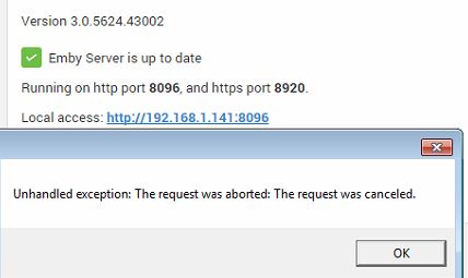

gjviii 48 Posted May 27, 2015 Posted May 27, 2015 Is this the same issue? If so its not resolved in dev 3.0.5624.43002. This happens after every reboot of the server. Once I click okay, the server closes. Thanks server-63568320302.txt unhandled_2d19ddff-6d12-430b-968f-15dec063d979.txt
Luke 42184 Posted May 27, 2015 Posted May 27, 2015 EmbyTV is throwing an error. Report it to the developer and/or remove it for now
