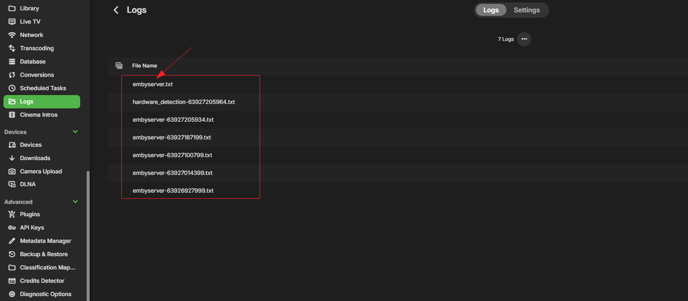

How did you get to the log file?
thejacer87
from the logs download in the dashboard

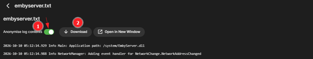

Neminem
Yes but 😉
Click on the filename.
Then activate "Anonymise log contents" and download.

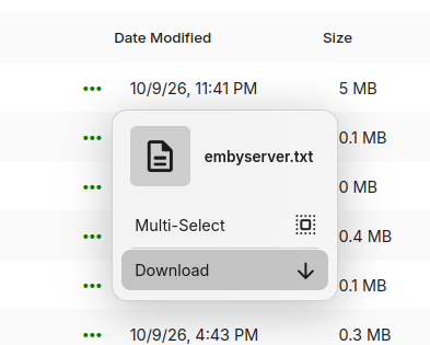

so the live stream stopped before it could finish, again (which is a different issue). but maybe the logs will show you whether it tried to start 2 mins early (see screenshot)
maybe all this is just cuz the iptv stream is just failing before ever getting to the end of a show
