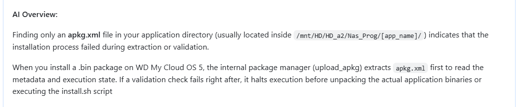

allxsan 5 Posted October 15 Author Posted October 15 (edited) On 10/11/2026 at 9:11 PM, Luke said: Hi, how has this gone? at the moment it's still working. But why had I tried twice to manually remove via ssh file apkg.xml (otherwise it would never work again except after reinstalling the WDMyCludUltraEx from scratch) which in my case is always the only file left in the folder "/mnt/HD/HD_a2/Nas_Prog/embyserver/start.sh /mnt/HD/HD_a2/Nas_Prog/embyserver" ? Why did it not work twice after manually removing via SSH and uninstalling Emby via WD interface but the third time it simply worked repeating exactly the same things? Edited October 15 by allxsan
Solution sa2000 890 Posted October 15 Solution Posted October 15 We don't know why the issue arose with an apkg.xml file being left and may be the same happened more than once This is overview from a google search We are going to make improvement to the install script to allow for this arising - but of couse why it arises in the first place is unknown 1
sa2000 890 Posted October 26 Posted October 26 On 15/10/2026 at 11:32, sa2000 said: We are going to make improvement to the install script to allow for this arising - but of couse why it arises in the first place is unknown FYI the WD Emby Server install script has been improved in beta 4.11.0.10 1
