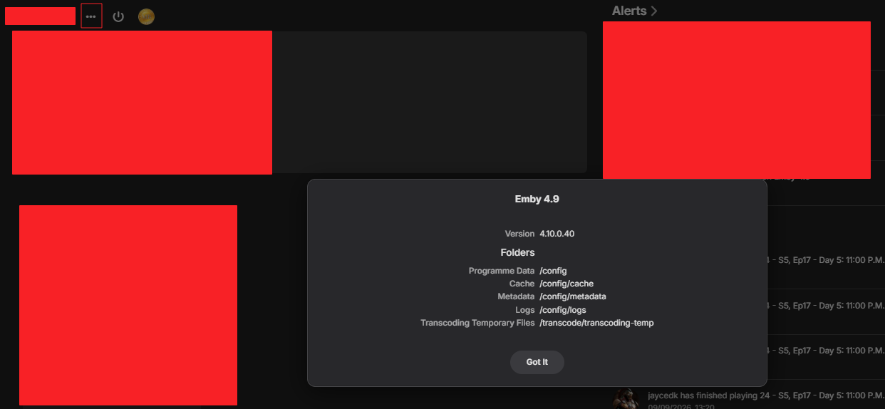

Neminem 1989 Posted September 9 Posted September 9 Click the 3 dots on your server dashboard. Then click "view server info" That should show where its installed. In my case these are mapped volumes in docker.

allxsan 5 Posted September 13 Author Posted September 13 On 9/9/2026 at 2:19 PM, Neminem said: Click the 3 dots on your server dashboard. Then click "view server info" That should show where its installed. In my case these are mapped volumes in docker. I think this not for me (?)

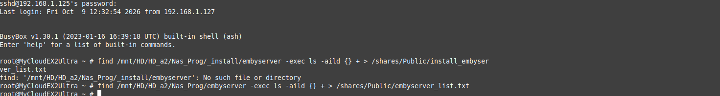

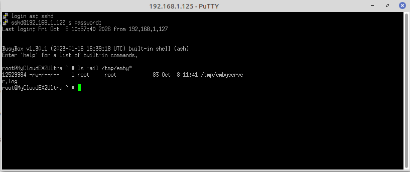

sa2000 884 Posted October 9 Posted October 9 50 minutes ago, allxsan said: "mv: can't rename '/mnt/HD/HD_a2/Nas_Prog/_install/embyserver': Directory not empty" This suggests there was a problem with an install / uninstall If you can use PuTTy, i would like detailed directory listings using "ls -ail" to see date/times and what files/folders are there So first ls -ail /tmp/emby* and then run these commands - they will output to 2 files in the Public share on the WD NAS find /mnt/HD/HD_a2/Nas_Prog/_install/embyserver -exec ls -aild {} + > /shares/Public/install_embyserver_list.txt find /mnt/HD/HD_a2/Nas_Prog/embyserver -exec ls -aild {} + > /shares/Public/embyserver_list.txt Please send me the 2 text files and the screen output from the ls command Thanks The emby server log shows last run was on 1st August on Emby Server 4.10.0.17
allxsan 5 Posted October 9 Author Posted October 9 (edited) /mnt/HD/HD_a2/Nas_Prog/_install/embyserver contains only "apkg.xml" I'm using Linux.. anyway 1 Putty + 1 linux ssh screenshot Edited October 9 by allxsan
sa2000 884 Posted October 9 Posted October 9 2 minutes ago, allxsan said: folder not sure what you mean The 2 files i need after running the find commands are /shares/Public/install_embyserver_list.txt /shares/Public/embyserver_list.txt /shares/Public/install_embyserver_list.txt /shares/Public/embyserver_list.txt plus what gets displayed on the screen when you run ls -ail /tmp/emby*
