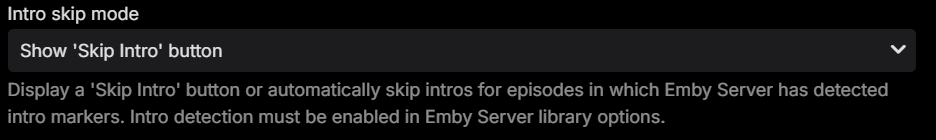

yocker 2084 Posted October 11 Posted October 11 22 minutes ago, spongebob69 said: Hi, I have installed the plugin, run scan from scheduled tasks but still can’t see skip intro button when starting a show. I use Emby app on my LG tv. Do I need emby premier subscription? In settings -> playback you need to enable:
spongebob69 10 Posted October 11 Posted October 11 I have this enabled 2 minutes ago, yocker said: In settings -> playback you need to enable:
