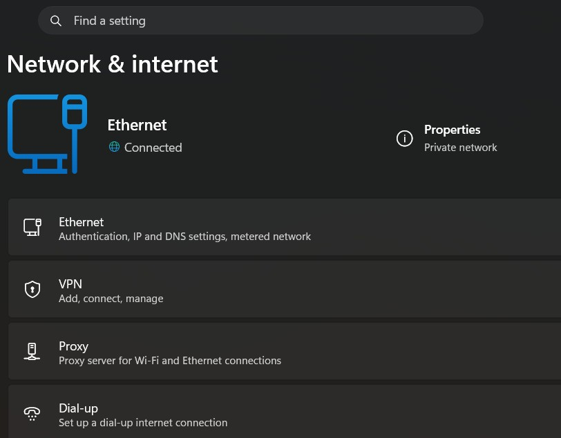

arrbee99 1924 Posted May 19 Posted May 19 I think it help for this setting to be 'Private network', not public, in Windows settings and any anti virus thing you might have - course if its already private...
Solution NeverExists 27 Posted May 19 Author Solution Posted May 19 Well, turns out that unplugging my modem from the wall then plugging it back in worked for some weird reason
