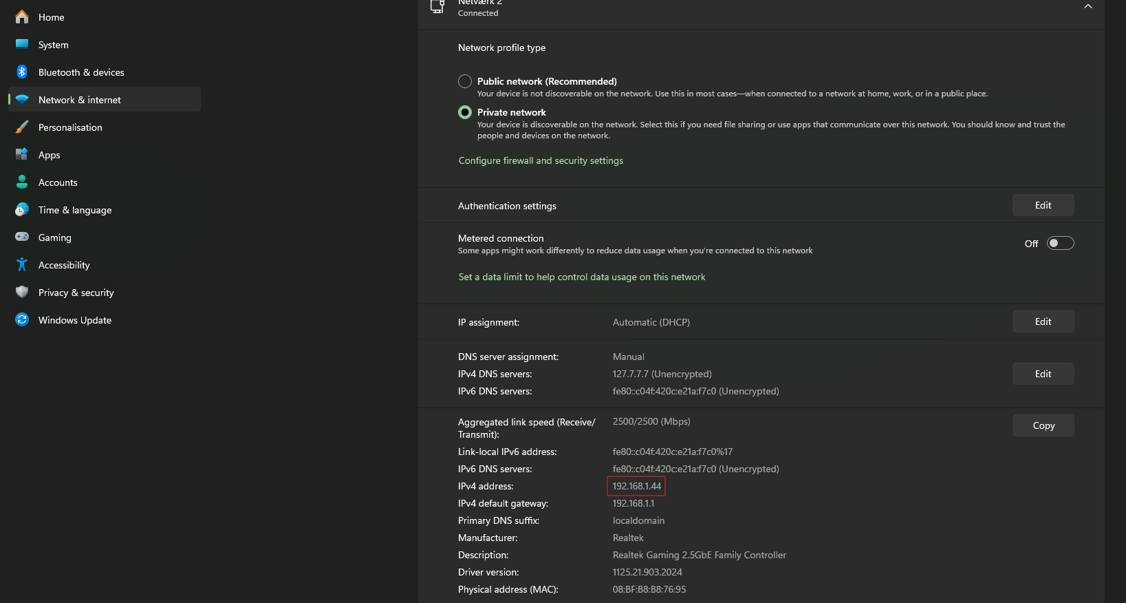

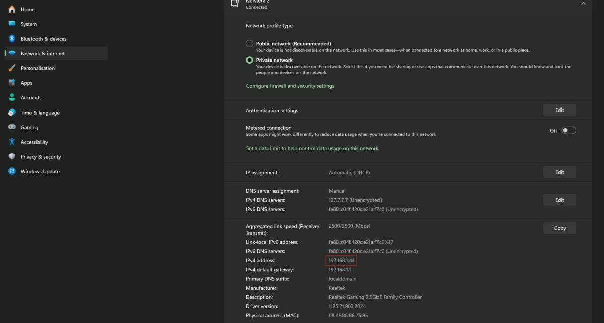

Neminem 1984 Posted May 18 Posted May 18 Did the update set your network to public? It needs to be private.

NeverExists 27 Posted May 18 Author Posted May 18 1 hour ago, Neminem said: Did the update set your network to public? It needs to be private. It did set it to public, but changing it to private did nothing

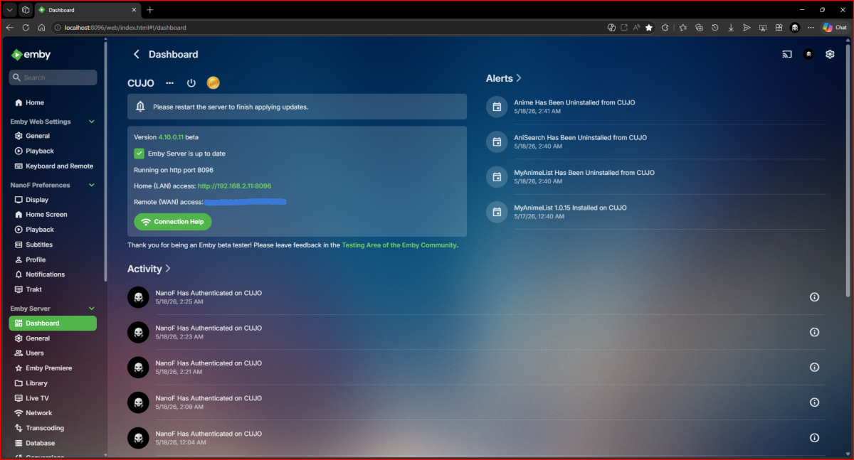

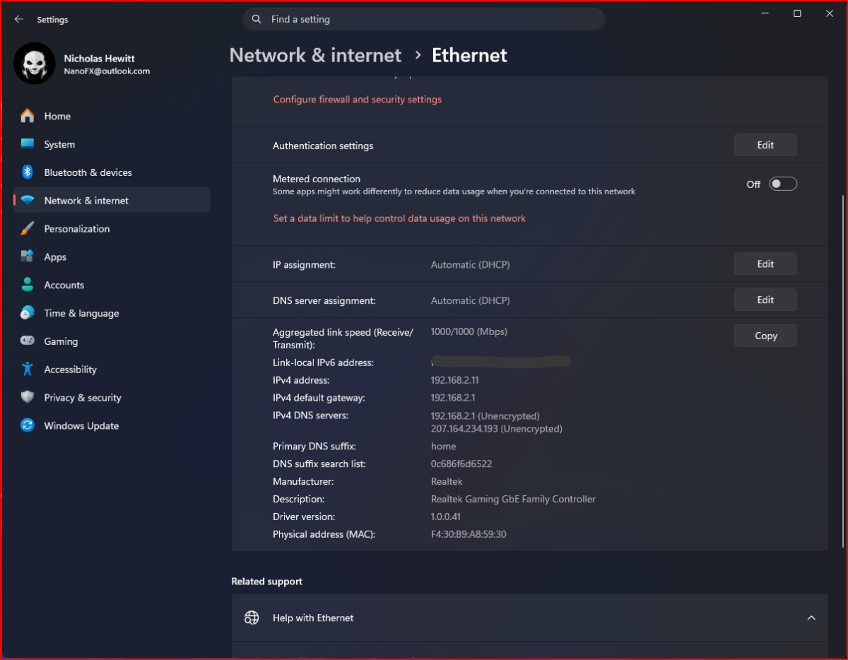

Neminem 1984 Posted May 18 Posted May 18 You look at you network connection. And check if that's the ip you use in the apps.
Neminem 1984 Posted May 18 Posted May 18 can you try from your phone. and use the browser to access the server. http://ip:8096
