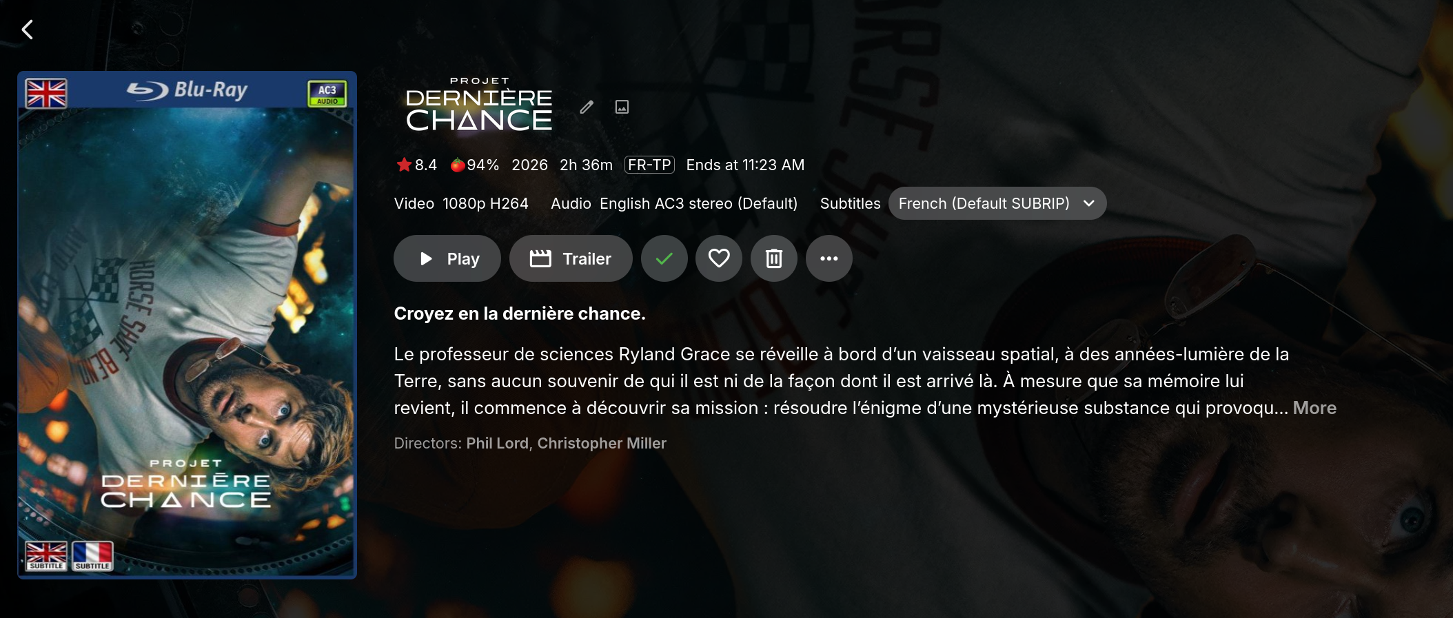

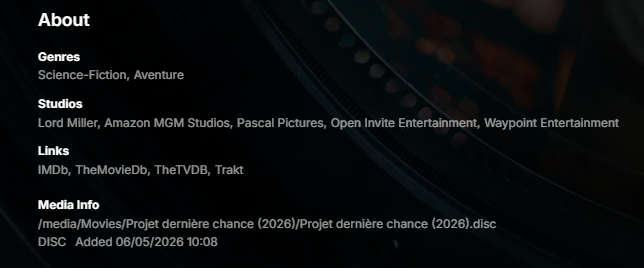

vincen 89 Posted May 6 Posted May 6 Hi It looks like an annoying bug for non english users. At least for movies it doesn't get genre from metadata databases or don't save it when it gets metadata. Here is a movie scanned with Emby setup in french for metadata (same file with Emby in english and no problem). In english it shows well as a Science-Fiction movie. Genre is not even saved in emby database (and bug would be just a display issue) as a search in science fiction doesn't list the movie Emby server 4.9.3.0 on Debian Linux No need to ask for logs as I won't give them (for obvious confidentiality reason). Thanks Vincèn

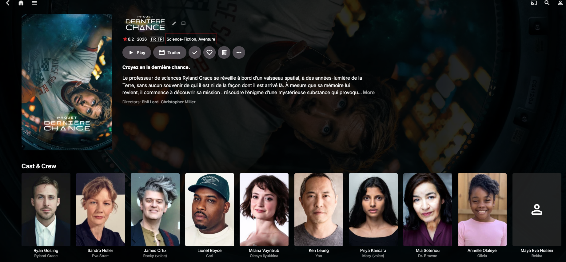

Neminem 1957 Posted May 6 Posted May 6 Just did a quick test of this movie. I set the metadata to French. And I dont see the issue with Metadata - Genres But without logs, op can hop and dance as it likes. 1

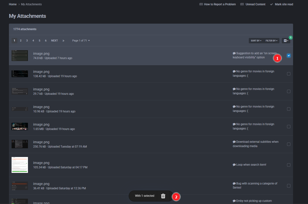

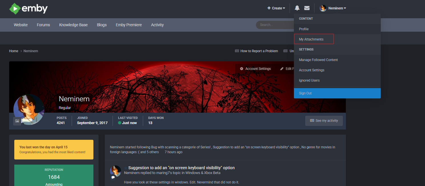

vincen 89 Posted May 7 Author Posted May 7 18 hours ago, Luke said: How did you check? By doing a direct API request on tmdb 18 hours ago, Neminem said: ust did a quick test of this movie. I set the metadata to French. And I dont see the issue with Metadata - Genres But without logs, op can hop and dance as it likes. Thanks a lot for the test so it's not a general bug but I still can't find what does that I have deactived all plugins just in case but exact same issue... For logs already explained why I don't share them all the more when it's also impossible to remove any attachments later in a post...
vincen 89 Posted May 7 Author Posted May 7 9 minutes ago, Neminem said: You can remove attachments at any time. Thanks, had not noticed that menu entry, I had tried to do it in past on the post itself 1

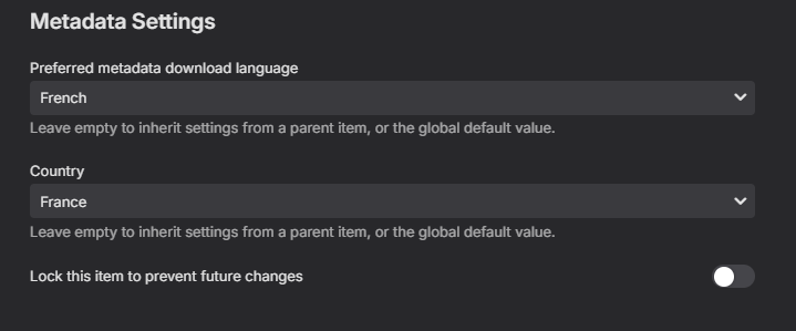

sa2000 860 Posted May 26 Posted May 26 (edited) On 23/05/2026 at 16:49, GrimReaper said: If it is, send it in a PM to Luke so he can trace it. I found the place (specific log lines) where we are not anonamizing the public IP address. I will refer this to the development team On 06/05/2026 at 09:22, vincen said: I already checked for metadata provider that is tmdb here and the problem is not present on their website for few movies I checked. After more investigations, movies have either no genre at all in french in Emby or only 1/2 while in english they have 3/4 i am looking at your log and I can see that genre was added but then got removed - "Science-Fiction" and "Aventure" Can you tell me what your settings are for the following: Settings / Library / Advanced (i.e. global default) : * Preferred Metadata Language * Certification Country Settings / Library / library = Films / Library Settings: * Preferred metadata download language * Certification Country * Preferred image download language * Folder scanning mode * Multi-version item detection (sorry - i am including options that are probably not relevant - but i want to have similar settings to yours when testing it out) Edited May 26 by sa2000 1
sa2000 860 Posted May 26 Posted May 26 On 23/05/2026 at 15:59, vincen said: They are not properly anonymised as public IP address of server is visible in it for example Is your server directly connected to the internet / WAN ? It is being seen as a local IP address
vincen 89 Posted May 26 Author Posted May 26 (edited) 26 minutes ago, sa2000 said: I found the place (specific log line) where we are not anonamizing the public IP address. I will refer this to the development team @sa2000 26 minutes ago, sa2000 said: i am looking at your log and I can see that genre was added but then got removed - "Science-Fiction" and "Aventure" Can you tell me what your settings are for the following: Settings / Library / Advanced (i.e. global default) : * Preferred Metadata Language * Certification Country Settings / Library / library = Films / Library Settings: * Preferred metadata download language * Certification Country * Preferred image download language * Folder scanning mode * Multi-version item detection (sorry - i am including options that are probably not relevant - but i want to have similar settings to yours when testing it out) Here are settings requested. For the Films library: Films: Library settings: Preferred metadata download language: French Certification country: Frnce Preferred image download language: French Folder scanning mode: default Multi-version item detection: Detect multi-version based on both files and metadata Library / Advanced settings: Preferred metadata download language: French Certification country: France Let me know if you need anything else 22 minutes ago, sa2000 said: Is your server directly connected to the internet / WAN ? It is being seen as a local IP address The server has one network port with direct public IP (it's in a rack in a datacenter) and the other one with a non routable IP that is connected to a local LAN for monitoring and management. Emby is configured to use an external domain that points at public IP of server and it has an SSL certificate (Secure connection mode is enforced). Thanks Edited May 26 by vincen 1
