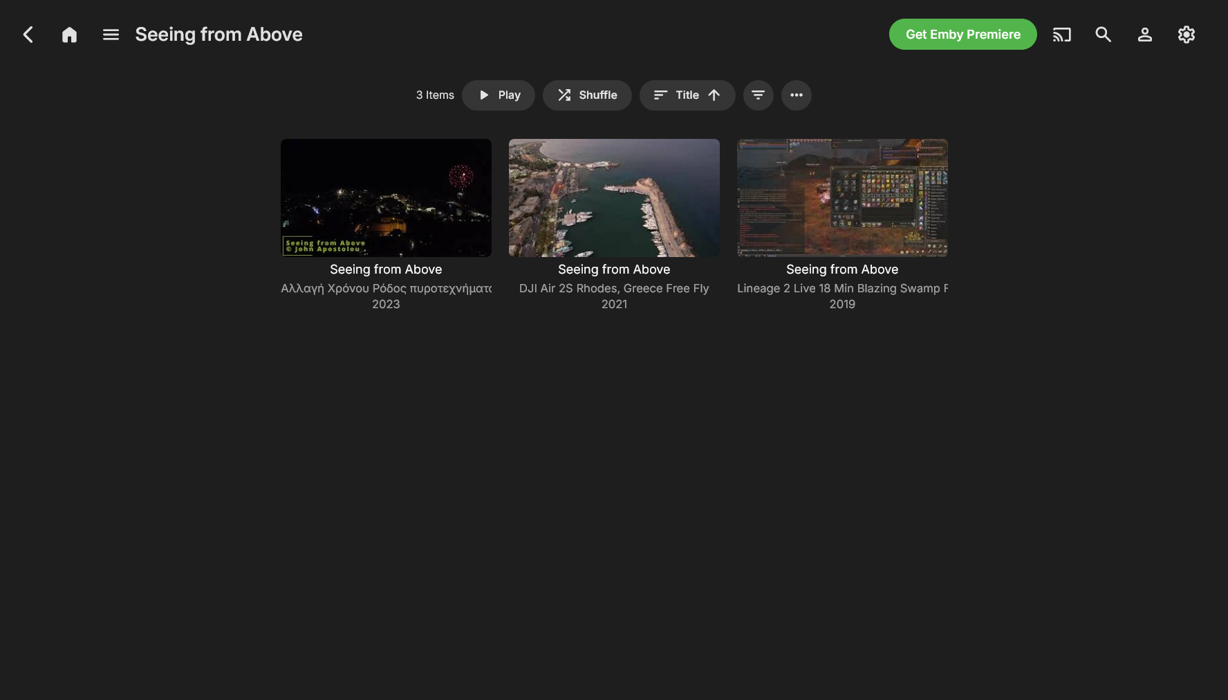

LoveYou2 4 Posted April 23 Posted April 23 (edited) I put my channel in plugin @SeeingfromAbove and get only 3 video. What am I doing wrong? Edit: I have this problem if Hide shorts Video. Edited April 23 by LoveYou2

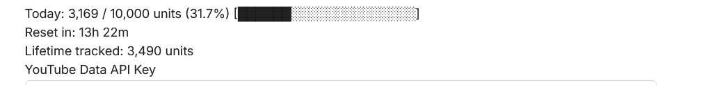

eli761 18 Posted April 23 Author Posted April 23 Sounds like you've hit the YouTube API quota limit. Try refreshing tomorrow once the quota has reset and you should see all your videos.
LoveYou2 4 Posted April 23 Posted April 23 6 minutes ago, eli761 said: Sounds like you've hit the YouTube API quota limit. Try refreshing tomorrow once the quota has reset and you should see all your videos.
eli761 18 Posted April 23 Author Posted April 23 Can you check your API quota usage in the Google Cloud Console? You can see how much you've used within the last day here: https://console.cloud.google.com/apis/dashboard If you updated the plugin recently, the counter might have reset and triggered a new quota cycle.
eli761 18 Posted April 24 Author Posted April 24 (edited) Small hotfix — v1.17.2 Hey everyone Quick hotfix for a quota issue I noticed in the logs. What was going on: The category browser was burning through the daily quota way faster than it should. When a category's regional chart came back empty, it was falling back to search.list — which costs 100 units per call. With a few empty categories and Emby refreshing every 15 minutes, the full 10k daily quota could be gone in a few hours. Fixes: Dropped the search.list fallback — empty categories are just hidden now instead of searched. Category folders no longer try to fill in sparse charts with search either. You get whatever chart=mostpo returns (1 unit). Quota: Daily usage should drop from ~10k down to around 1.5–2k units for most setups. Download: Emby.YouTubePlugin.dll Let me know how it runs for you Edited April 24 by eli761

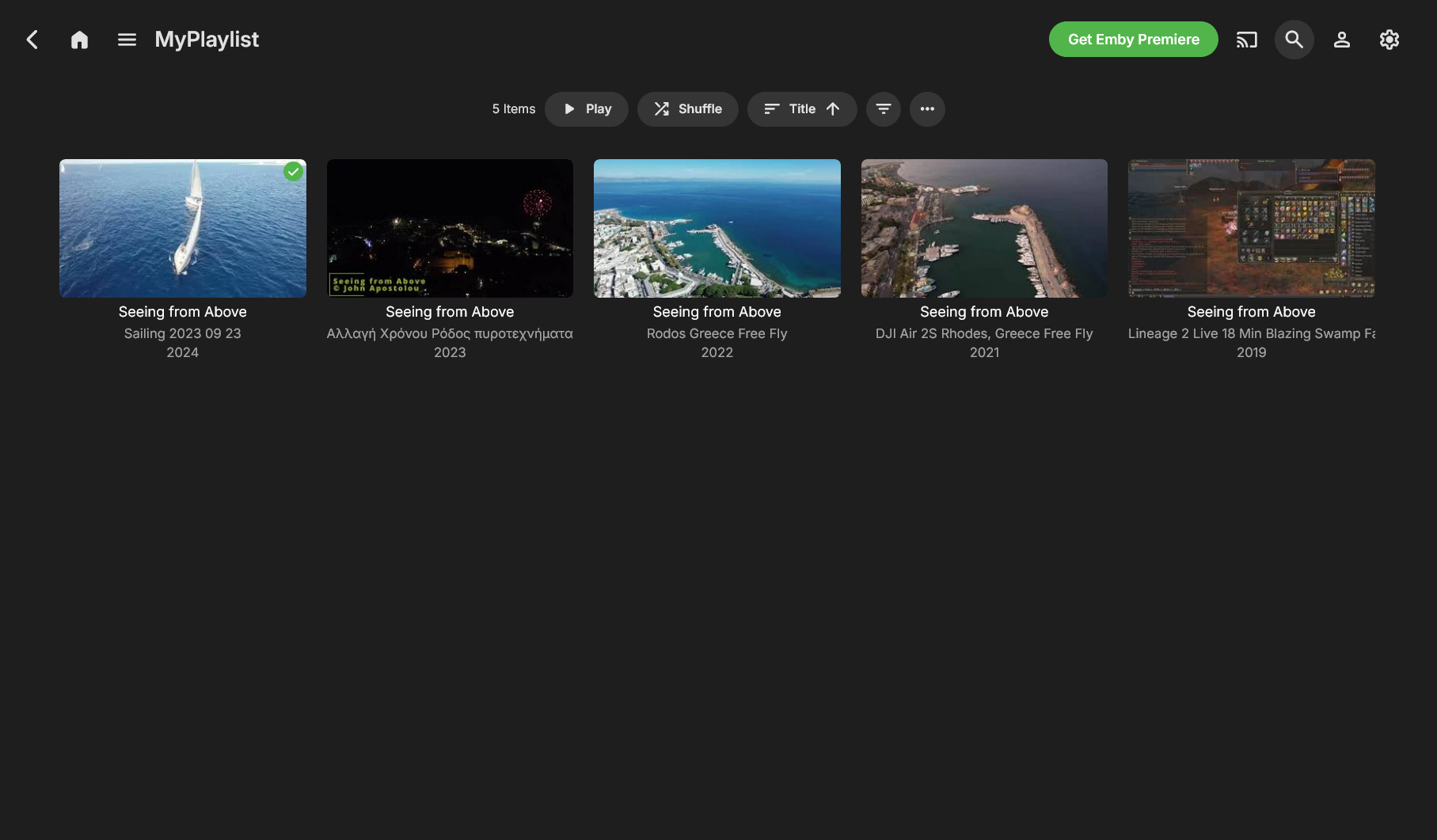

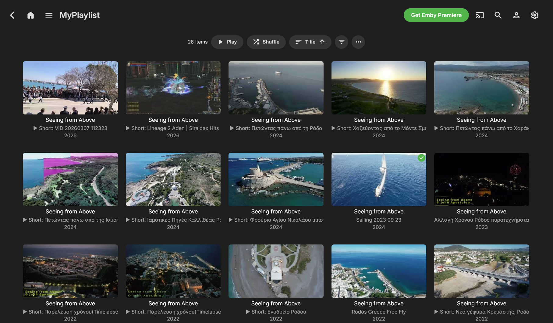

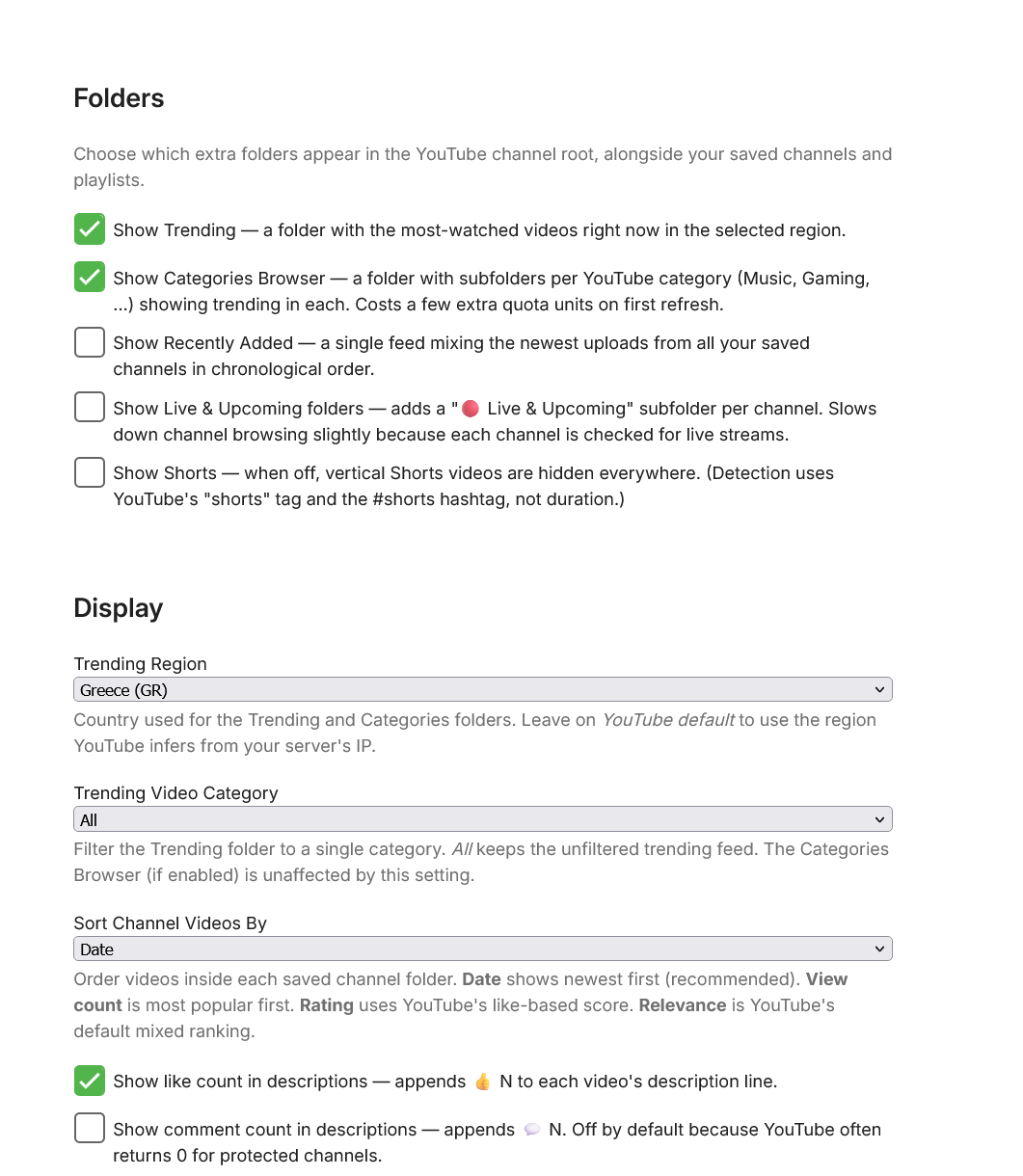

LoveYou2 4 Posted April 24 Posted April 24 Hello eli761, Hide Shorts: ON Hide Shorts: OFF I think that in my case, when “Hide Shorts” is ON, the results are incorrect. It should be showing all the videos.
eli761 18 Posted April 24 Author Posted April 24 (edited) Hey, could you tell me the exact duration of the videos that get hidden when Hide Shorts is ON? Also, could you send me a link to one of the affected videos so I can use it as a test case when adjusting the short detection logic? Edited April 24 by eli761
LoveYou2 4 Posted April 24 Posted April 24 (edited) 9 minutes ago, eli761 said: Hey, could you tell me the exact duration of the videos that get hidden when Hide Shorts is ON? Also, could you send me a link to one of the affected videos so I can use it as a test case when adjusting the short detection logic? https://www.youtube.com/@SeeingfromAbove/videos AI Overview Short-form video is a, usually vertical, video format typically under 60–90 seconds designed for rapid, engaging viewing on social media platforms. These clips—such as TikToks, Instagram Reels, or YouTube Shorts—are popular for their quick storytelling and high shareability in mobile-first environments Most of my videos are under 60 seconds, but they don't meet the criteria to be considered short. They are not vertical. Edited April 24 by LoveYou2
eli761 18 Posted April 24 Author Posted April 24 Thanks for the info! I'll rework the algorithm. Will ship it in the next release. 1

eli761 18 Posted April 29 Author Posted April 29 22 minutes ago, LoveYou2 said: Hi eli761, How's your work going? Making progress? Hi, yes, I’m making progress. I still need a few more days to clean things up properly. In the next update, Shorts should be detected correctly. 1

eli761 18 Posted May 2 Author Posted May 2 On 4/30/2026 at 6:25 PM, LoveYou2 said: Something wrong? Show Shorts OFF I've pushed a new version that should fix this issue. After updating, please trigger a manual channel refresh once to apply the changes. Then let me know if you run into any further problems! Thanks for your patience. 1
LoveYou2 4 Posted May 2 Posted May 2 8 minutes ago, eli761 said: I've pushed a new version that should fix this issue. After updating, please trigger a manual channel refresh once to apply the changes. Then let me know if you run into any further problems! Thanks for your patience. Look better now thanks

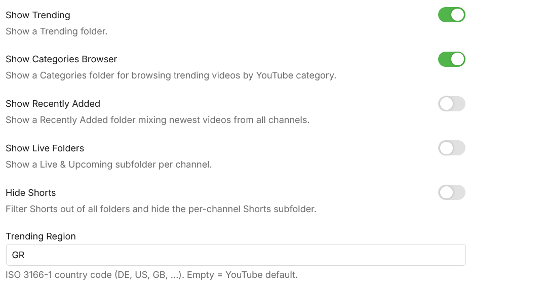

Swaf 2 Posted June 23 Posted June 23 I install the plugin and try with "@MrBeast" and i let show trending but when i go in youtube plugin mrbeast folder and trending folder are both empty ?
eli761 18 Posted June 23 Author Posted June 23 How long did you wait? It can take a few minutes for the plugin to load the items.
