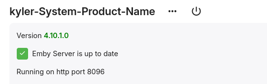

KylerMarkle 2 Posted October 19 Author Posted October 19 1 hour ago, Luke said: Are you sure you're using the correct ip address? Where did you get it from? The emby dashboard in my web browser, it's under this;
