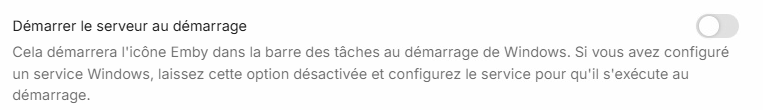

MAX92 93 Posted February 9 Author Posted February 9 Merci @massilliaman, très intéressant. Dommage, la licence coûte 50€. Mais j'ai peut-être trouvé l'origine de mon problème : A voir avec le temps

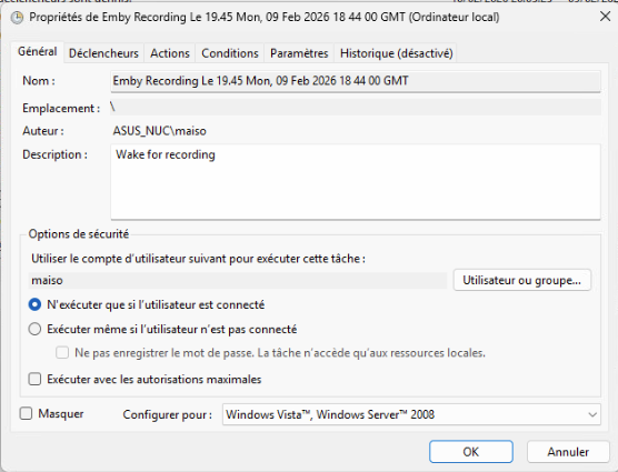

MAX92 93 Posted February 10 Author Posted February 10 J'ai trouvé ce qui lance à nouveau le serveur : c'est la planificateur de tache. @LukeComment faire pour que la tache ne se déclenche pas quand le service est actif ?
Solution Luke 42237 Posted February 11 Solution Posted February 11 15 hours ago, MAX92 said: I found what restarts the server: it's the task scheduler. @LukeHow can I prevent the task from triggering when the service is active? HI, the only option is go to into advanced live tv settings and disable waking the server machine for recordings. Then it will be up to you to ensure the machine is awake for recording. Please note, changing this option will not remove any entries from the task scheduler that have already been added.
