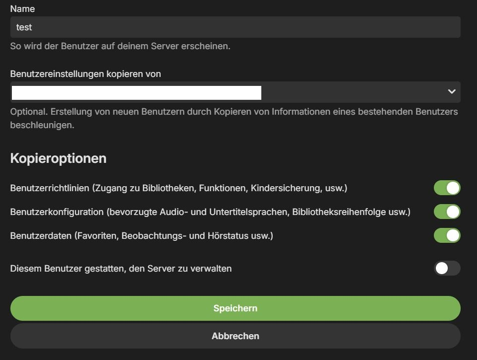

Stueck 0 Posted February 5 Posted February 5 (edited) Hello, I have the following problem: I create a new user and copy the user settings of a specific user (admin account) using the “User data” checkbox. Spoiler This fails with the message “Exception of type ‘SQLitePCL.pretty.SQLiteException’ was thrown.” Spoiler It works without the “User data.” This is not a problem with other accounts. I have already followed all the steps in the support article “Corrupt Database” and applied them to all 4 databases. All `integrity_checks` were `OK`. `VACUUM` and `REINDEX` also ran without errors. I noticed the problem as follows: I use the Statistics plugin. Unfortunately, it doesn't seem to work for this user - since it's the (local) admin account, I thought it might be due to admin rights—so I wanted to simply copy the account without admin rights to view the statistics. However, that doesn't seem to be the cause. Unfortunately, the UserStats array of the request http://192.168.xx.xx:8096/emby/Plugins/291d866f-baad-464a-aed6-a4a8b95a8fd7/Configuration?X-Emby-Client=Emby+Web&X-Emby-Device-Name=Chrome+Windows&X-Emby-Device-Id=xxxxxxxxx-xxxx-xxxx-xxxx-xxxxxxxxxxxx&X-Emby-Client-Version=4.9.3.0&X-Emby-Token=xxxxxxxxxxxxxxxxxxxxxxxxxxxxxxxx&X-Emby-Language=de does not contain this user. I therefore suspect a problem in the data structure. How can I solve the problem without having to recreate the user and lose all user statuses? Here is my embyserver.txt: embyserver.txt Thank you very much Stueck Edited February 5 by Stueck
