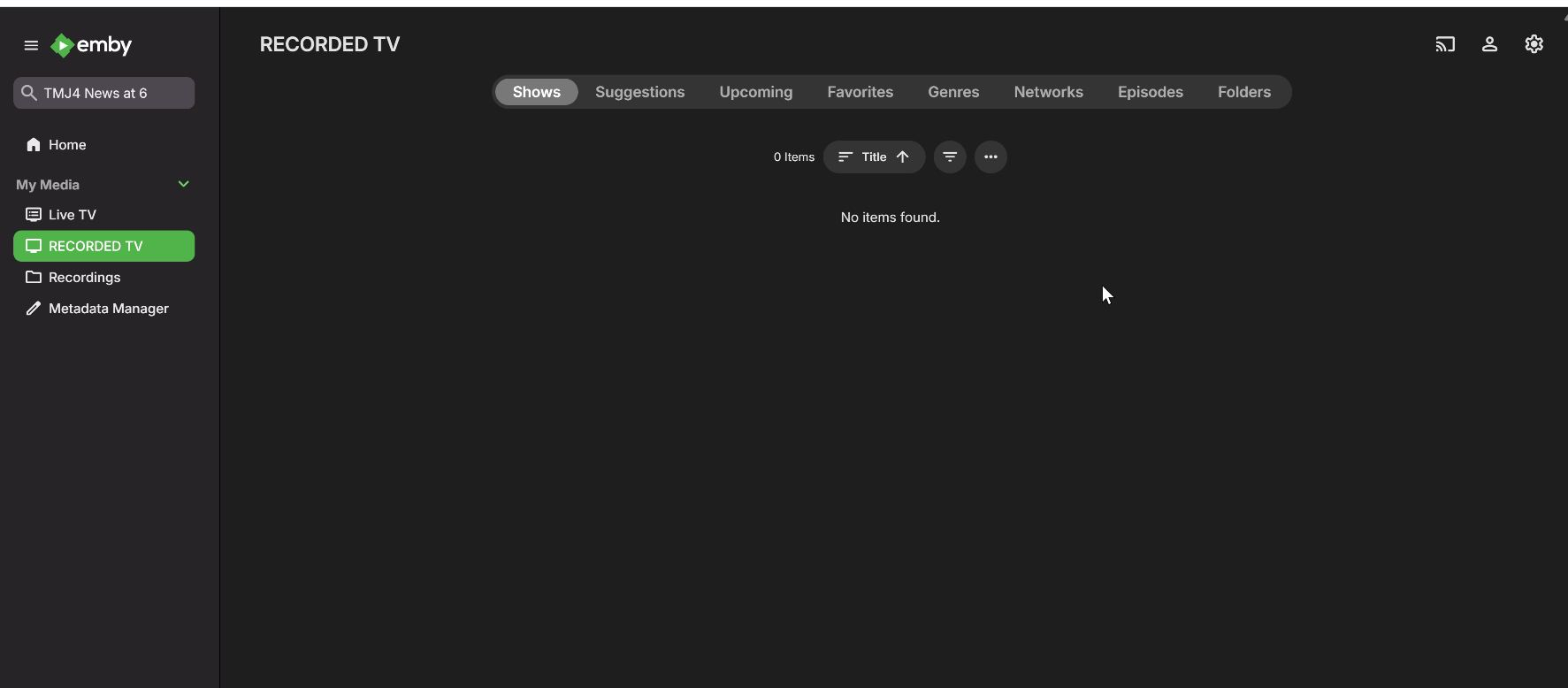

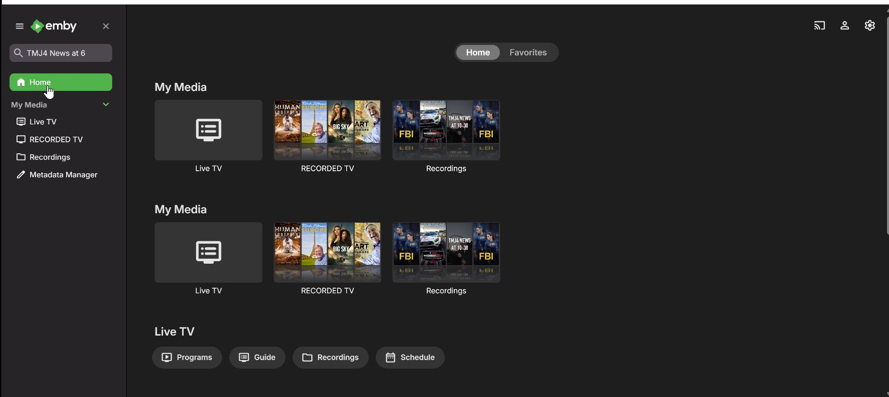

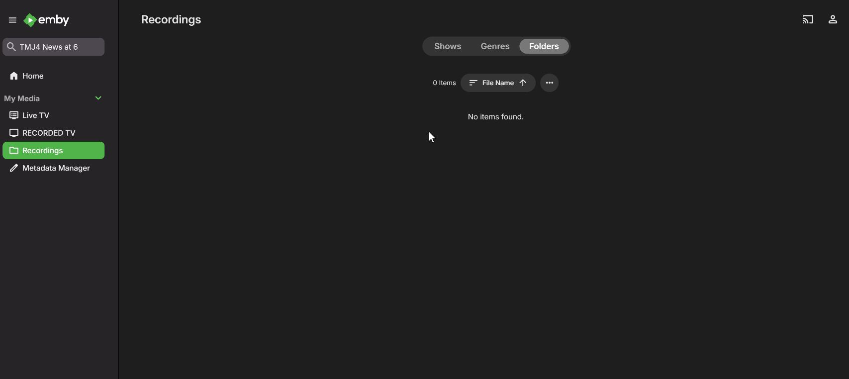

carefulkelly 4 Posted February 5 Author Posted February 5 I have attached a screenshot showing my emby homepage with the sample images for each of my two recording folders and the tv shows they contain, however when I click these images to show the linked shows in emby it indicates that the folders are empty. However, when I go to the folders in windows explorer there are several shows in each. Additionally, as I had mentioned above, I tried to set Emby to record to my (preferred) external HDD (O/Recorded TV), but every time I try to record a show in emby it still drops the new show back into the default emby c drive location c/users/...../ "recordings" folder again. Again, as I mentioned above, the help files appear out of date as to how to force Emby to record to a new folder. And on a side note, the "how to report a problem" page that is linked in all your reply messages is also out of date. The help page indicates that logs are located under advanced/logs in the server. But now it appears there is a dedicated /logs section in the server. @sa2000 Thanks for your assistance with this. Looking forward to organizing my emby experience embyserver (1).txt embyserver-63905846400.txt
carefulkelly 4 Posted February 5 Author Posted February 5 Please note that there are no filter conditions in the emby folder view settings, it is set to "any" condition.

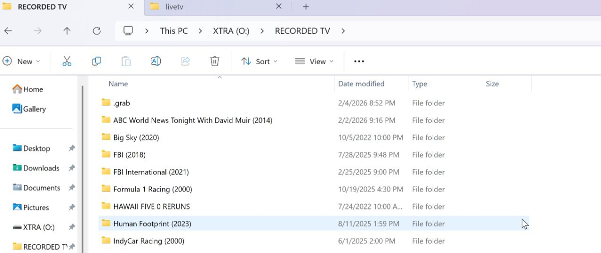

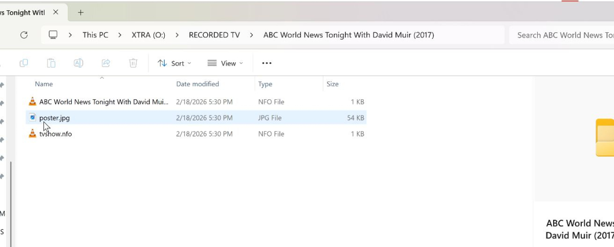

carefulkelly 4 Posted February 6 Author Posted February 6 Correction: I did not check the files within my windows folders. While they populated with the correct show listings, inside the folders (in either media location) the only files are simply 1kb .nfo files. 1 being [show name].nfo and 1 being tvshow.nfo. along with a poster.jpg. Obviously, that's why the cover art is showing but no media files. So clearly they are not recording. I am confident my guide data is correct as I previously learned how to do this for the channels I needed + I refreshed it multiple times today.
Luke 42140 Posted February 6 Posted February 6 Quote However, when I go to the folders in windows explorer there are several shows in each. Hi, in Emby library setup, what folders are added to each library?

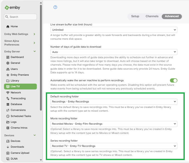

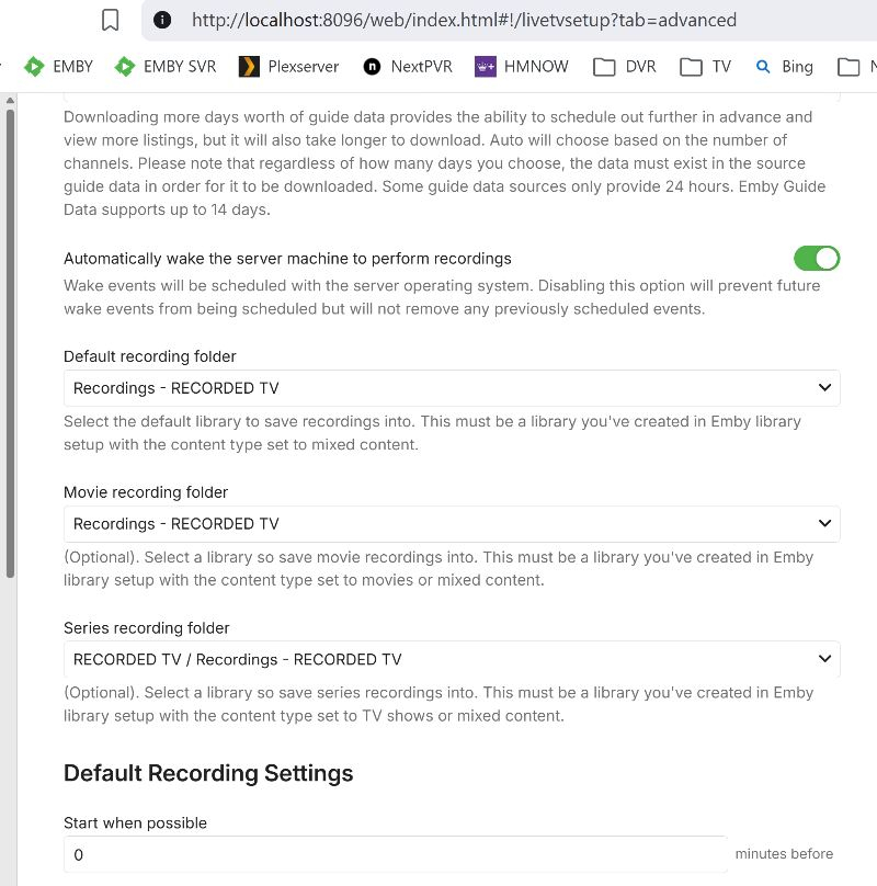

sa2000 684 Posted February 6 Posted February 6 (edited) 15 hours ago, carefulkelly said: And on a side note, the "how to report a problem" page that is linked in all your reply messages is also out of date. The help page indicates that logs are located under advanced/logs in the server. But now it appears there is a dedicated /logs section in the server I have corrected this 15 hours ago, carefulkelly said: Additionally, as I had mentioned above, I tried to set Emby to record to my (preferred) external HDD (O/Recorded TV), but every time I try to record a show in emby it still drops the new show back into the default emby c drive location c/users/...../ "recordings" folder again What do you have set in the Live TV Advanced Settings for recording paths ? There are 3 settings. Example of what I have on of my emby servers. 9 hours ago, carefulkelly said: While they populated with the correct show listings, inside the folders (in either media location) the only files are simply 1kb .nfo files. 1 being [show name].nfo and 1 being tvshow.nfo. along with a poster.jpg. Obviously, that's why the cover art is showing but no media files. Could you enable debug logging on Emby Server - Settings / Logs / Settings Restart the server Record an airing If the recording media files do not get created, capture the embyserver log and upload please together with a screenshot of the folder explorer view Edited February 6 by sa2000
carefulkelly 4 Posted February 6 Author Posted February 6 My default recording folders were not set. As I am testing this out, I am wondering about the location of active recordings. When I record test shows, Emby immediately creates a folder in windows explorer folder for that show, but it is not showing any .ts or other file in the folder that indicates it is actually caching/adding data as recording progresses. Is the final destination folder the cache folder as well or is there another? I see a .grab folder but it is empty, so I guess not, is that even an Emby folder?

Luke 42140 Posted February 7 Posted February 7 Quote When I record test shows, Emby immediately creates a folder in windows explorer folder for that show, but it is not showing any .ts or other file in the folder that indicates it is actually caching/adding data as recording progresses. Is the final destination folder the cache folder as well or is there another? HI there, can you please provide a specific example? How to Report a Problem Thanks !

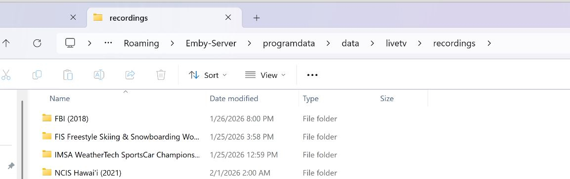

sa2000 684 Posted February 9 Posted February 9 (edited) On 06/02/2026 at 16:52, carefulkelly said: As I am testing this out, I am wondering about the location of active recordings. I expect the default to be C:\Users\Den\AppData\Roaming\Emby-Server\programdata\data\livetv\recordings On 06/02/2026 at 16:52, carefulkelly said: I see a .grab folder but it is empty This is Plex Live TV recordings folder. Not emby Please provide logs as requested for a recording that is going wrong On 06/02/2026 at 12:08, sa2000 said: If the recording media files do not get created, capture the embyserver log and upload please together with a screenshot of the folder explorer view Edited February 9 by sa2000

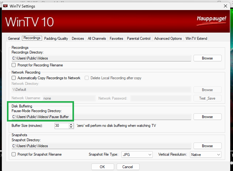

sa2000 684 Posted February 19 Posted February 19 The default pause buffer location is in "C:\Users\Public\Videos" - did you change it in WinTV settings to "O:\Recorded TV\Videos" ? Does the folder exist ? This is my setting which uses the default for the pause buffer With default setup, there should be a WinTV folder under c:\users\public - locate that and then look for the Logs folder and log.txt The log file would have log lines relating to the pause buffer file
sa2000 684 Posted February 19 Posted February 19 (edited) Maybe if you change the Hauppauge Pause Buffer location, you need to create the path yourself first, creating each of these folders O:\Recorded TV\Videos O:\Recorded TV\Videos\Pause Buffer Edited February 19 by sa2000
carefulkelly 4 Posted March 1 Author Posted March 1 Thank you so much Luke. The problem was my failure to create a default recordings folder (or any other for that matter) in WinTV10 for my Hauppauge tuner. I had purchased and installed WinTV10 as I read that it was necessary to set up emby; however, I was not aware that it's default recording settings needed to be setup first in order for Emby to work. By this time I had also reinstalled Emby from scratch and it looks like I am now on track. 1
carefulkelly 4 Posted March 1 Author Posted March 1 just a follow up on this in case it benefits others: EMBY SERVER AND HAUPPAUGE TUNERS You not only need to purchase and install wintv10 for Emby to work with a HAUPPAUGE tuner, you also need to immediately configure the default recording folder and pause buffer location. Wintv10 should catch this, but either way, without these settings Emby will not record or play and live tv. Fortunately my Hauppauge tuner is recent enough that wintv10 does not need to remain running in the background after these settings are made. 2
