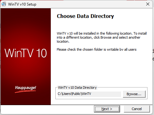

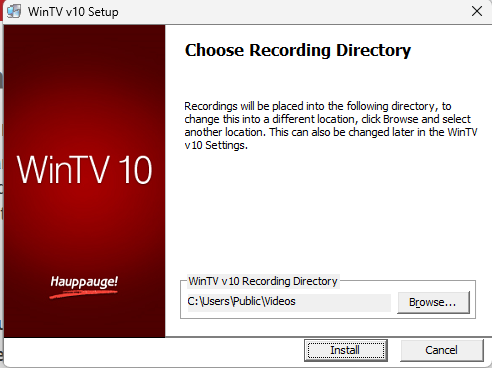

    When installing the WinTV application, make sure that it is installed for all Windows users to access and that the folder paths for the installation and recordings are in directories that have full permissions set for the windows user account that Emby Server would run under. The following shows the paths that need to be defined at install time.
    and
    These paths can also be set through WinTV application settings.

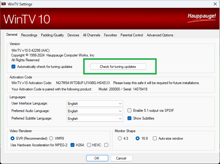

    After installing the Hauppauge WinTV app, ensure all the channel tuning data is updated, click on Settings and then Check for Tuning Updates in the General tab.

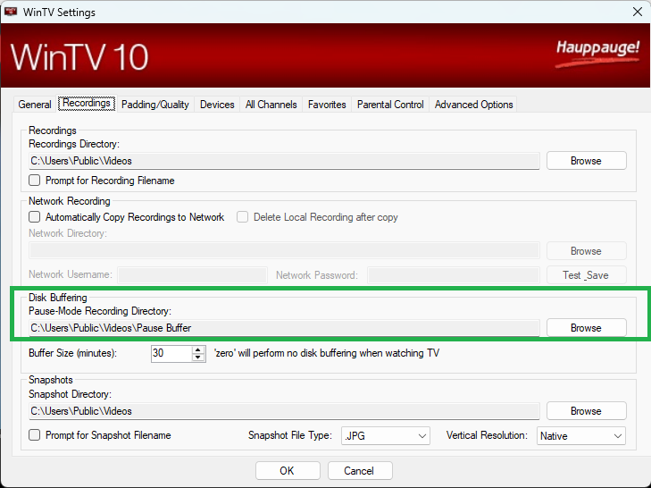

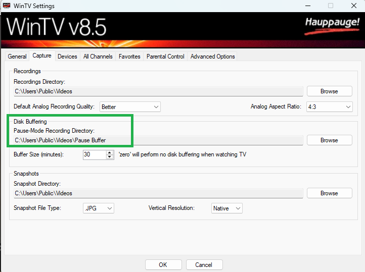

    After ensuring that the tuning data is up to date, make sure the Hauppauge Pause Buffer path is setup and permissions are set for the Emby Server windows process for full access. To set the directory paths, on WinTV v10, select the Recordings tab and on WinTV v8.5, select the Capture tab. The Disk Buffering Pause-Mode Recording Directory is used by Emby Server for Live TV streaming and recordings.

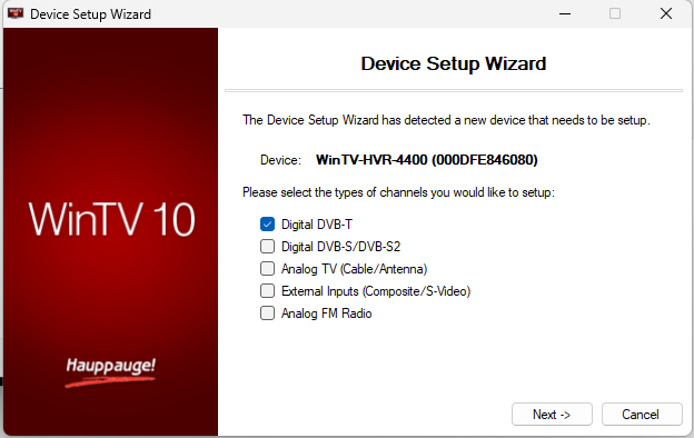

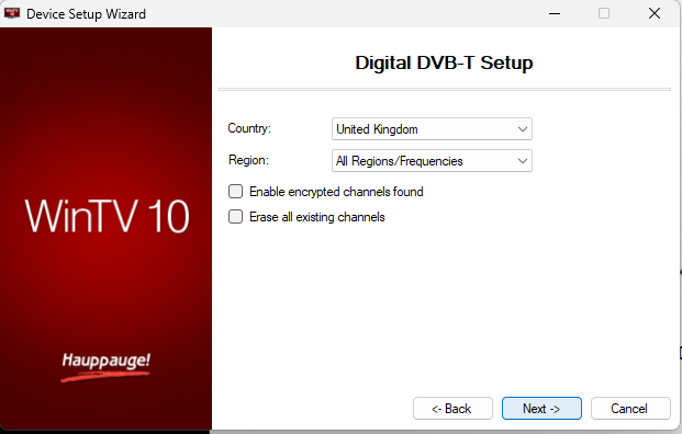

    Next is to configure the tuner and scan for the TV channels. The example in the following screenshots is for DVB-T OTA channels for the UK.

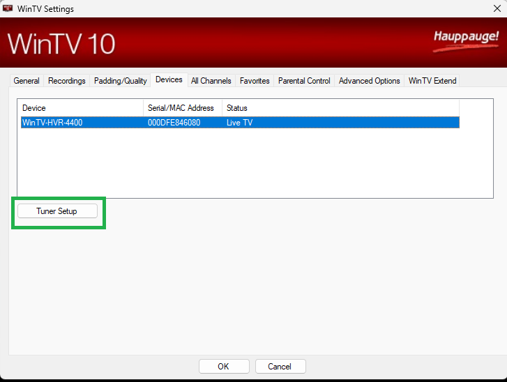

    Select the tuner and click on Tuner Setup.
    Go through the options applicable to your region, type of tuner and channels available for you.
    On completion of the scan and setup, use the WinTV app to test that the channels do stream and the signal and quality is good.

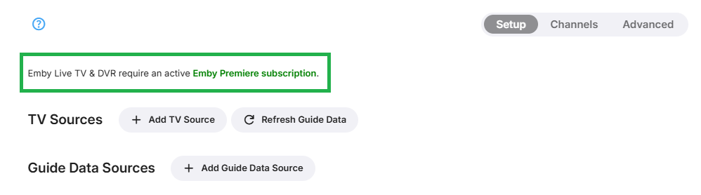

    The Live TV & DVR feature requires a valid Emby Premiere subscription. This would be indicated on the setup screen when there is no subscription:
    Note
    Whilst you will be permitted to add the Live TV device, there would be no channels or guide data without an Emby Premiere subscription.

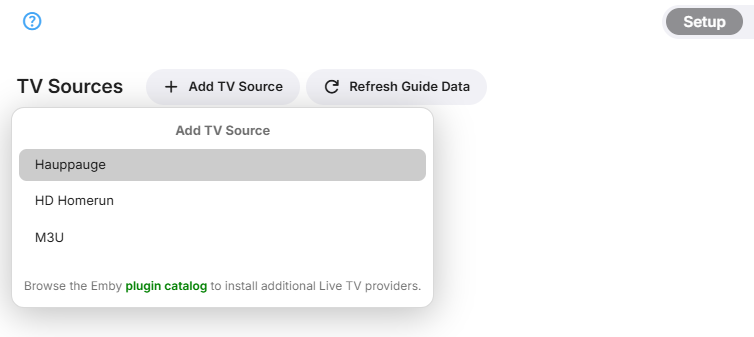

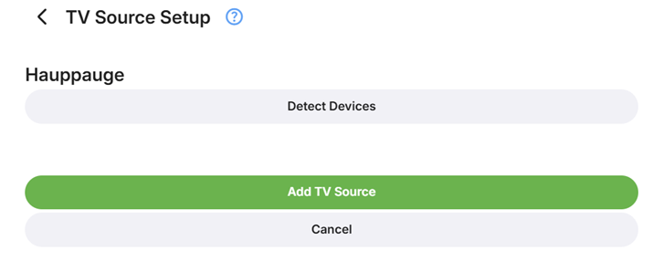

    To add an Hauppauge device, click on + Add TV Source and select Hauppauge
    This will show the following

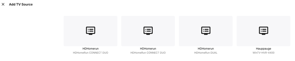

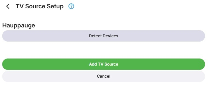

    Click on Detect Devices
    You will then see all the detected new Live TV tuner devices, select the Hauppauge device you wish to add

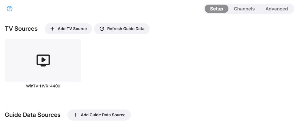

    You will be back to this screeen. Click on Add TV Source
    You will now see the device added.
