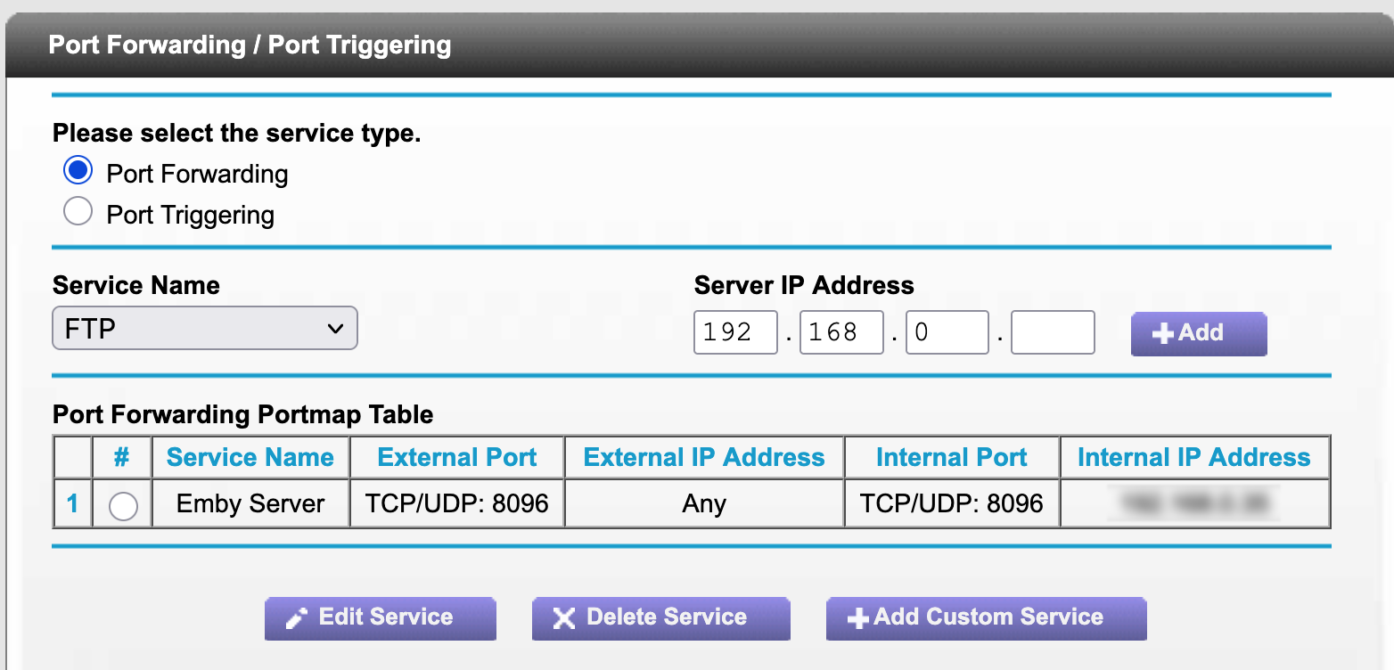

lbalbo 4 Posted January 24 Author Posted January 24 Can't say for sure. I've been trying to log into the router and it never connects. There are no issues with the LAN, just connecting from my neighbor's Emby Connect Roku app.
lbalbo 4 Posted January 24 Author Posted January 24 I was able to get into my router and believe I have successfully setup port forwarding. Waiting for Dynamic DNS Service.
Neminem 1619 Posted January 25 Posted January 25 What does this web site tell you. Open Port Check Tool -- Verify Port Forwarding on Your Router
lbalbo 4 Posted January 25 Author Posted January 25 The port is showing as open and now the server can be accessed from my neighbor's Roku TV. Port forwarding was the issue. Thank you! 1
