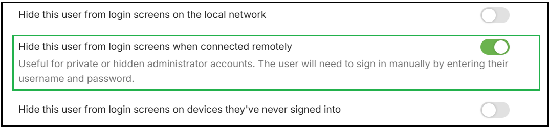

Neminem 1630 Posted January 18 Posted January 18 (edited) @UltimateOne You say " login attempts on a handful of my user accounts" Are those user accounts showing when remote? If they are disable that, NOW. Are you using Emby standart port's? Change them to something not known. Read this Secure Your Server | Emby Documentation And pay attention to the details, and how you might put your self at risk. If a bot / script kiddy scan the internet for open Emby ports, they will try to hack it. If you have user names showing on login screen, they have half the login. And will try to brute force the password. Have a good read through on these postes. Edited January 18 by Neminem 1

sa2000 703 Posted January 19 Posted January 19 52 minutes ago, brothom said: Is there any documentation on this feature (how long the timeout is, how many login attempts, etc? This is not stated at the moment in our Secure Your Server article. I don't think it would be a good idea to publish the internal security measures. What is important here is establishing if these were actual login attempts or just accessing the public IP and public port - because the latter happens all the times with bots If they were attempts to login then to establish if attempting some random user names or specific names like admin or actually for some of the emby server user accounts. The user names are not disclosed by emby server for remote connections by default and as mentioned by @Neminemyou need to go through the server user accounts and check the setting for remote visibility
brothom 211 Posted January 20 Posted January 20 11 hours ago, sa2000 said: This is not stated at the moment in our Secure Your Server article. I don't think it would be a good idea to publish the internal security measures. I doubt this should be an issue since any leaky server is just one bruteforce away to find that out anyway. Other APIs usually indicate their timeouts via oauth and such. Regardless, the choice is yours ofcourse. For server admins (us) It's important to note that "Hide this user from login screen" only literally hides this user from the user-selection screen. "Hidden" users can still log with their username using the "Manual Login" method.
sa2000 703 Posted January 20 Posted January 20 3 hours ago, brothom said: Hidden" users can still log with their username using the "Manual Login" method Yes of course. The difference is that the user would need to know what the username is
