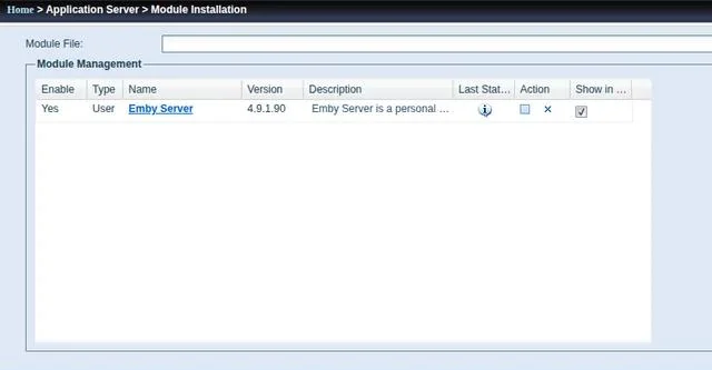

RobbyThomas2525 0 Posted January 1 Posted January 1 hi i'm trying to make my NAS Server a media server it's a Thecus n4200 and i have a problem where after i install it it doesn't want to open i have it enabled and everything but it still won't open and i don't see anything in the logs of it failing i think it's because i'm missing Mono and FFmpeg but i don't know where to get the .mod files for them https://preview.redd.it/9yavyq670tag1.png?width=809&format=png&auto=webp&s=c2d762401673bc9656fed9db552e4a1533caa153

RobbyThomas2525 0 Posted January 3 Author Posted January 3 3 hours ago, RobbyThomas2525 said: yes https://preview.redd.it/9yavyq670tag1.png?width=809&format=png&auto=webp&s=c2d762401673bc9656fed9db552e4a1533caa153 do you think it could be that i don't have mono and FFmpeg installed on my NAS cause i'm not sure where i get a .mod file for them
Luke 42234 Posted January 3 Posted January 3 Quote and i don't see anything in the logs of it failing What logs do you have?
RobbyThomas2525 0 Posted January 3 Author Posted January 3 hi i've tried to install emby on my nas and it's not opening up for me from the web interface on my nas i've tried the ports and the firewall but i'm now wondering if it's because of the fact i don't have mono and ffmpeg installed but i'm not sure where to get the .mod files from and they don't have it on the download site https://emby.media/thecus-server.html
RobbyThomas2525 0 Posted January 3 Author Posted January 3 i don't really have any logs or error messages just when i click on the emby server in this photo it just says unable to connect on the web browser but when i installed this on a arch VM on my computer it worked so that's why i'm thinking i'm just missing MONO and FFmpeg on my NAS

RobbyThomas2525 0 Posted January 3 Author Posted January 3 (edited) opening the site from the NAS software to Emby (the emby server button in the photo) i'm thinking now though it has something to do with Mono missing cause it's not on the list but i don't know where i can get the .mod file from for Mono and FFmpeg i think it's that cause i installed the arch linux Emby server on a VM and it worked with that port number Edited January 3 by RobbyThomas2525
Luke 42234 Posted January 4 Posted January 4 When you try to start the server, is any server log file generated under this folder? Emby Server Data Folder
RobbyThomas2525 0 Posted January 4 Author Posted January 4 That website doesn’t have a TheCus option and I don’t see anything on the network it that could be a permission though cause I notice with the Emby server installed it takes about 700MB of space
alucryd 318 Posted January 5 Posted January 5 @RobbyThomas2525What version did you install? That model has an x86_64 CPU so you need https://github.com/MediaBrowser/Emby.Releases/releases/download/4.9.1.90/emby-server-thecus_4.9.1.90_x86_64.mod
Luke 42234 Posted January 5 Posted January 5 On 1/4/2026 at 11:25 AM, RobbyThomas2525 said: That website doesn’t have a TheCus option and I don’t see anything on the network it that could be a permission though cause I notice with the Emby server installed it takes about 700MB of space the data directory is /raid/data/module/EmbyServer/programdata @sa2000can update the doc. 1
