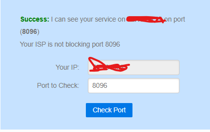

seanbuff 1355 Posted January 24 Posted January 24 4 hours ago, LaHaye said: I'm not able to remote into Emby when I'm outside my network. I have Plex and I can connect without any issues. I've got port forwarding setup correctly. I believe the client is just not getting to my external ip address. Have you followed the External Connections Troubleshooting guide here: https://emby.media/support/articles/Connectivity.html#troubleshooting-external-connections Which of the following checks pass or fail? Once port forwarding is configured, checked via CanYouSeeMe: https://emby.media/support/articles/Connectivity.html#verify-your-external-ip-address Check for cgNAT: https://emby.media/support/articles/Connectivity.html#cgnat-double-nat Checked for Multiple routers double NAT: https://emby.media/support/articles/Connectivity.html#multiple-routers-double-nat Checked that your ISP is not blocking external connections: https://emby.media/support/articles/Connectivity.html#isp-blocking P.S. You cannot compare to Plex as they operate such that all your connections go via their central servers, this makes it easy for them to provide remote connectivity without much user intervention.
LaHaye 3 Posted January 24 Posted January 24 Seanbuff, Thanks for the information. I had success using information you sent me. I found another setting in my firewall that I enabled and we're good now. I completely revamped my internal network so more than likely I missed a configuration. So much for my Rookie mistake. 1 1
