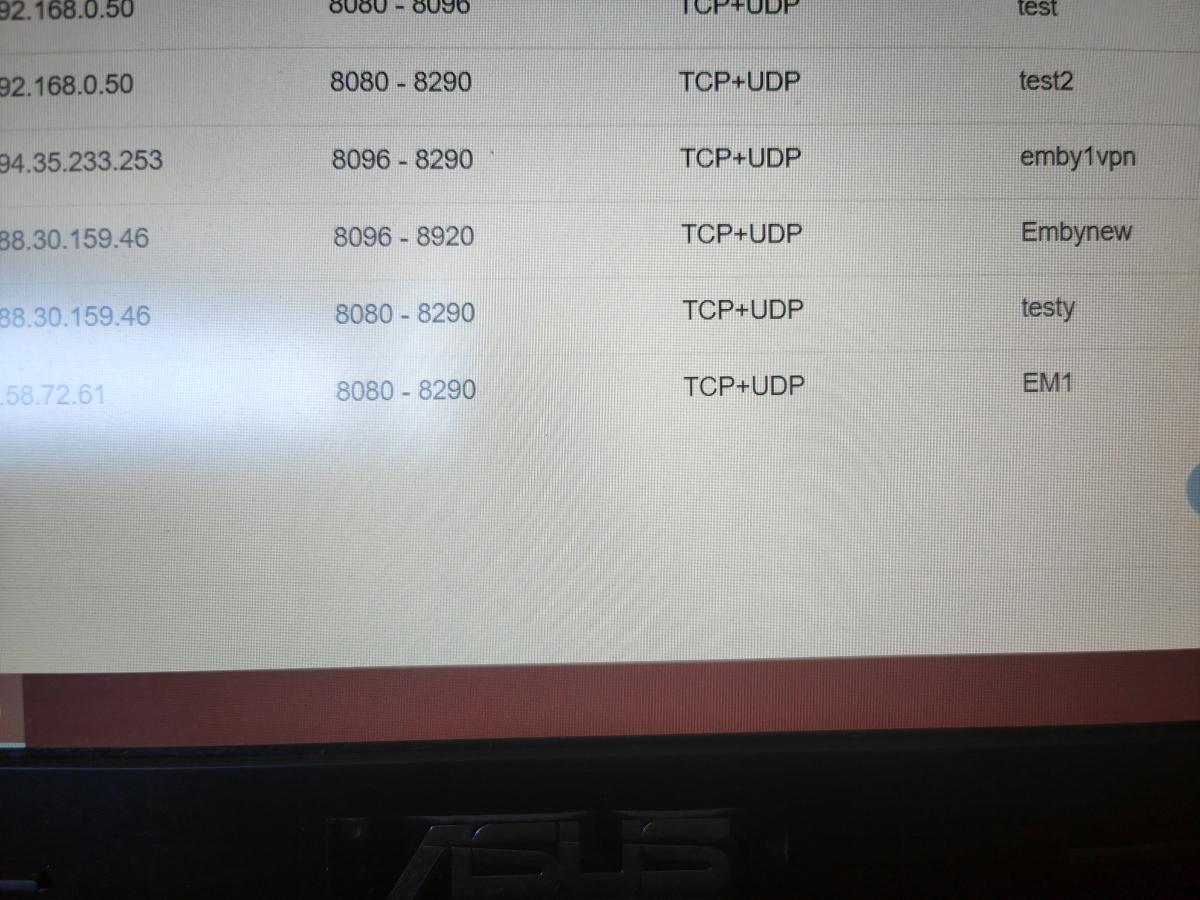

Luke 42237 Posted December 30, 2025 Posted December 30, 2025 Can you show us how you setup your port forwarding?
Luke 42237 Posted December 30, 2025 Posted December 30, 2025 Can you show us a screenshot of the setup in the router?

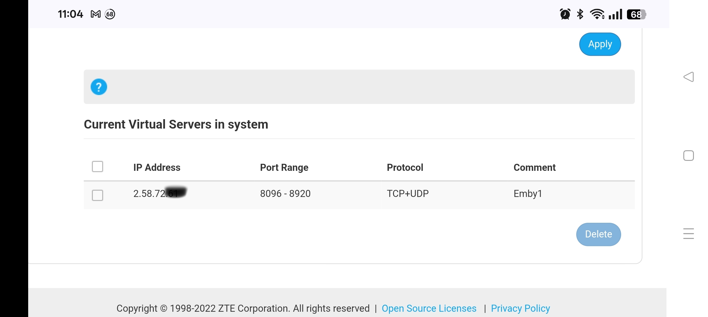

seanbuff 1355 Posted January 4 Posted January 4 33 minutes ago, Benny72 said: Yes I run things like Plex ok I just can't get emby to work remotely You have specified a public IP in that rule. You need to port forward to your private (internal) IP address of the QNAP NAS which is hosting your Emby Server (eg. 192.168.0.100, etc)

Luke 42237 Posted January 5 Posted January 5 10 hours ago, Benny72 said: I think it's my router I'm running through a (three) router and tho I have done the port forwarding the upnp doesn't seem to be working Hi, can you please show us how you setup port forwarding in your router?

Luke 42237 Posted January 5 Posted January 5 Are you sure the ip address that you entered into the port forwarding rule is correct?

Luke 42237 Posted January 5 Posted January 5 Have you checked to see if your new ISP is using a cgnat? If they are then remote access will require a vpn such as tailscale.
