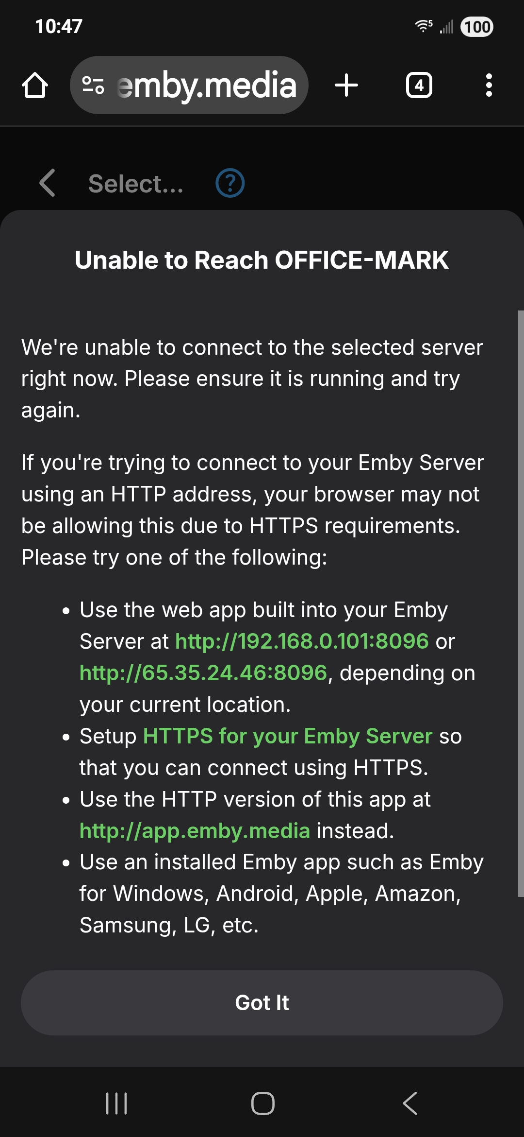

Luke 42287 Posted December 27, 2025 Posted December 27, 2025 On 12/25/2025 at 9:45 AM, Trekdriver3 said: What do you mean? I tried all those links to try to connect to "emby connect". None worked. Hi, there is no such thing as "connect to emby connect". Emby Connect is just a feature to help you connect to your own server. But since you said you tried all those links, then for the second bullet point, what SSL certificate did you set up? For the fourth bullet point, what installed Emby app did you try to use?

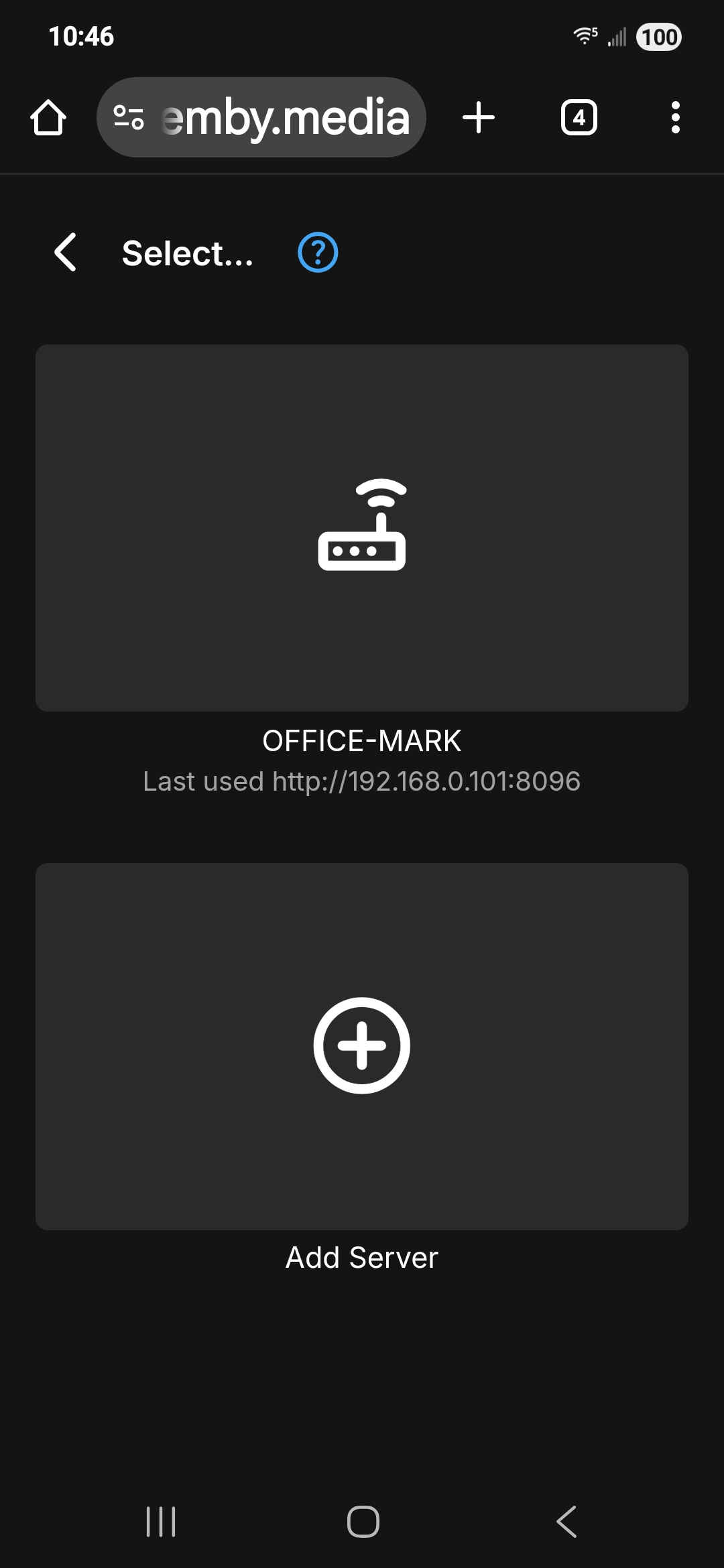

Trekdriver3 12 Posted December 27, 2025 Author Posted December 27, 2025 I don't know that I did set up an ssl, I don't really know what that ia. When I first installed emby, I just did what it asked me to do. Next I went to emby connect, to start linking to t.v.s. Emby Connect is listed as https://emby.media That is what I cannot get into, I have an account, I should be able to see it. All I get is that list of (what you call) bullet points, none of which work.I don't know what else I can do to explain things, like I said, I'm not that computer savvy, I don't know a lot of the terms.
Luke 42287 Posted December 27, 2025 Posted December 27, 2025 1 hour ago, Trekdriver3 said: I don't know that I did set up an ssl, I don't really know what that ia. When I first installed emby, I just did what it asked me to do. Next I went to emby connect, to start linking to t.v.s. Emby Connect is listed as https://emby.media That is what I cannot get into, I have an account, I should be able to see it. All I get is that list of (what you call) bullet points, none of which work.I don't know what else I can do to explain things, like I said, I'm not that computer savvy, I don't know a lot of the terms. But you’re saying none of which work when it sounds like you haven’t tried them. in the fourth bullet point, what installed Emby app did you install?
Trekdriver3 12 Posted December 27, 2025 Author Posted December 27, 2025 Just now, Trekdriver3 said: So, the above is as far as I can get. These were from my phone. But I use Emby for windows 64 bit and on my phone its for Android. And no, none of those links work, believe me, I've tried them all, numerous times. The last one emby media takes me back to the sign in page.
Trekdriver3 12 Posted December 27, 2025 Author Posted December 27, 2025 53 minutes ago, Trekdriver3 said: So, the above is as far as I can get. These were from my phone. But I use Emby for windows 64 bit and on my phone its for Android. And no, none of those links work, believe me, I've tried them all, numerous times. The last one emby media takes me back to the sign in page. 53 minutes ago, Trekdriver3 said: 53 minutes ago, Trekdriver3 said: 19 hours ago, Trekdriver3 said: Ok sorry. If I open Emby from my new book mark which is what works, it shows version 4.9.1.90 and shows "up to date" Emby connect I cannot get into to change my physical house address from Safety Harbor Fl. To Clearwater Fl. (could that be the localhost problem?) On my windows add or remove programs it shows 4.8
Luke 42287 Posted December 27, 2025 Posted December 27, 2025 Did you try installing the Emby App like the fourth bullet point suggests? Or the Emby windows app?
Trekdriver3 12 Posted December 27, 2025 Author Posted December 27, 2025 I just installed the windows app. Still won't let me use the "Connect" option. Emby.media takes me to the sign in page. Both have the .101 address, which will not connect. Tell you what, if you want, we can wait till after the new update, and just hope I don't have to buy a new t.v. that I have to connect to. It's up to you. ATM Emby is working on all my t.v.s and on my computer.

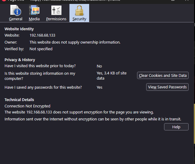

Lessaj 486 Posted December 27, 2025 Posted December 27, 2025 I don't use Emby Connect so I don't know how valid this will be, but after you sign in to Emby Connect try to delete the server that you see there, there should be a 3 dot menu in the bottom right or tap+hold for context menu, then add server with the address previously provided Host 192.168.68.133 Port 8096. Can maybe also try to remove your email from your User profile and add it back and see if that makes it update, but I would try deleting the one that appears and readding with the correct details first. 1

RanmaCanada 503 Posted December 28, 2025 Posted December 28, 2025 9 hours ago, Trekdriver3 said: Great, I went there and it wanted me to put in the address from the first solution The one ending in 101.8096. Now that address does not work for me, so why would I put that in? The only way I can get on Emby on my p.c. is to use the address given to me by "Lassaj" that ends in 1338096. That works fine on my p.c. which was my original problem. What is not working in no way, shape, or form is emby connect on my p.c. or Android phone. All that does is take me to the 101 address, and I can't add the 133 address. So what would a static ip do for me with an address that so far, I can't use? And yes, for things like this, I am somewhat tech. challenged, but I can follow directions. I'm not too sure about putting in the static ip, don't want to screw things up. So if you can explain a little further I'd appreciate it greatly. Thanks for the help. If you can't understand those extremely simple directions, I am sorry, there is absolutely no hope for you. Your system is currently setup with DHCP, which means your router will drop it after a certain period of time and renew the ip address, which means your computer will get a new address and your current system of accessing the server will no longer work as it will be pointing to where the computer is not. Please take the time to learn this and understand it. It is imperative. 1
