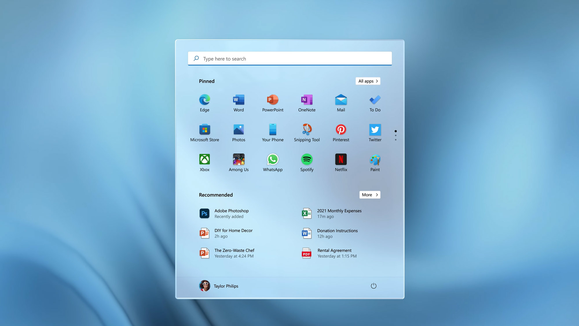

Trekdriver3 13 Posted December 26, 2025 Author Posted December 26, 2025 3 minutes ago, Luke said: Hi, what start button do you mean? Windows start where all programs are listed
Trekdriver3 13 Posted December 26, 2025 Author Posted December 26, 2025 1 minute ago, Trekdriver3 said: Windows start where all programs are listed The above photo is just an image of what mine looks like. it's not my actual start menu, thats why emby does not show on it.

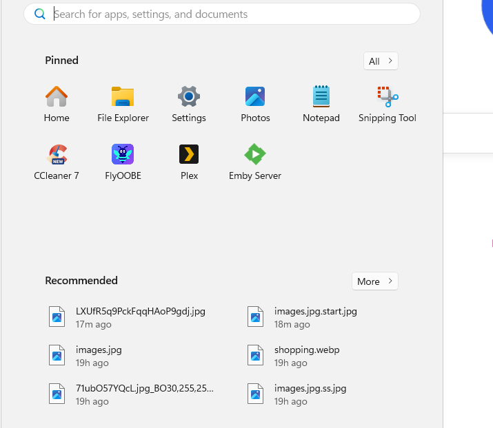

Trekdriver3 13 Posted December 26, 2025 Author Posted December 26, 2025 5 minutes ago, Luke said: Where is Emby on that? I can't take an actual screenshot of my start menu, but mine has an Emby Icon
Luke 43550 Posted December 26, 2025 Posted December 26, 2025 OK there was a fix for this. It’s probably just not in the version you have yet .
Trekdriver3 13 Posted December 26, 2025 Author Posted December 26, 2025 6 minutes ago, Luke said: OK there was a fix for this. It’s probably just not in the version you have yet . OK, Figured the screenshot thing out. But I still can't get into "Emby Connect" And upon re-boot Emby tries to start with local host, which does not work?

Luke 43550 Posted December 27, 2025 Posted December 27, 2025 OK so the fix for the windows button came after 4.9.1.90, so it will be in the next release. Does that clear everything up now?
