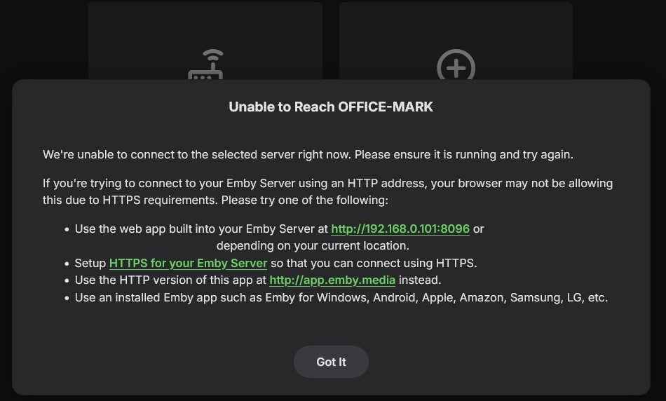

Trekdriver3 12 Posted December 24, 2025 Posted December 24, 2025 Emby seems to be working on all my televisions, the problem is on my p.c. Emby seems to load ok, but the above error is what I get when I click on ANY movie or t.v. show. I can't get into any of my settings, I cant start at all from emby connect. I have checked firewall, seems fine. Even tried turning off Defender, didn't help at all. I'm afraid to UN-install and re-install for fear of loosing friends and family, I have sharing my account. I don't even see Emby in my program files, it does show up in task mgr. I have no clue whats going on, and I'm not all that computer savvy, but I can follow instructions pretty well. Hate to bring this up on Christmas Eve, but it's been going on since yesterday.

Lessaj 486 Posted December 24, 2025 Posted December 24, 2025 If you're on the same machine as the server process you can try to access it via http://localhost:8096. Otherwise did you try to use the local address as mentioned in the first bullet? Barring that, did you try the plain HTTP link as mentioned in the third bullet point? More than likely your browser is automatically trying to use HTTPS, including when using Emby Connect. P.S. You should remove your screenshot it has your public IP on it, which luckily the port isn't open for. 1
Lessaj 486 Posted December 24, 2025 Posted December 24, 2025 Thanks for sending me a PM but let's keep it in the thread. So if you're able to reach it with localhost then your server should be up and running on that device. Check your Network Profile if it's set to Private (correct) or Public (incorrect). The client apps might be working if it ends up using your external IP and then it hairpins, not really sure about that, but I suspect the Network Profile, it likes to randomly flip back to Public.

Lessaj 486 Posted December 25, 2025 Posted December 25, 2025 Per this log file the IP address is actually 192.168.68.133, not sure where it's getting 192.168.0.101 from. Also I think the client apps might see it on the network because of a UDP broadcast, so you don't have to be specific, but on the web app you would.
Luke 42287 Posted December 25, 2025 Posted December 25, 2025 11 hours ago, Trekdriver3 said: The above is from "Emby Connect. But like I said, it works on all t.v.s Hi, the answer to this is in your screenshot. You have four possible paths to take. Which one would you like to proceed with?

Trekdriver3 12 Posted December 25, 2025 Author Posted December 25, 2025 8 hours ago, Lessaj said: Per this log file the IP address is actually 192.168.68.133, not sure where it's getting 192.168.0.101 from. Also I think the client apps might see it on the network because of a UDP broadcast, so you don't have to be specific, but on the web app you would. Are you meaning my P.C.s I.P. That ends in 192.136 The DHCP 192.168.68.1 ???
Neminem 1630 Posted December 25, 2025 Posted December 25, 2025 Did you manually set a Ip address on your server? 192.136 -> 192.168 seams like a type-o. 1

Trekdriver3 12 Posted December 25, 2025 Author Posted December 25, 2025 8 hours ago, Luke said: Hi, the answer to this is in your screenshot. You have four possible paths to take. Which one would you like to proceed with? What do you mean? I tried all those links to try to connect to "emby connect". None worked.

RanmaCanada 503 Posted December 25, 2025 Posted December 25, 2025 Well for starters, your Emby server should have a static IP address on your network. That way you can open the ports on your router PROPERLY. If you're trying to access the server from the server, it gets to be a bit complicated at times because of how networking works. As Luke mentioned, the answer is in your screenshot as it tells you exactly what to do to access your server.
Trekdriver3 12 Posted December 25, 2025 Author Posted December 25, 2025 15 minutes ago, RanmaCanada said: Well for starters, your Emby server should have a static IP address on your network. That way you can open the ports on your router PROPERLY. If you're trying to access the server from the server, it gets to be a bit complicated at times because of how networking works. As Luke mentioned, the answer is in your screenshot as it tells you exactly what to do to access your server. How would I do that?
Trekdriver3 12 Posted December 25, 2025 Author Posted December 25, 2025 Ok form the emby connect site, when I try to sign in I get the Unable to access office mark. The first link ending in 101.8096 - Timed Out the next one 524.46 - Timed Out The next one HTTPS takes me to the Help Thread , the last one emby.media also timed out. I did remove the Emby account from Peggy's t.v. and deleted her account from my users, and re-booted, No help there. Emby home screen still comes up on my P.C. http://localhost:8096/web/index.html#!/home When I click on My movie library http://localhost:8096/web/index.html#!/videos?serverId=4c7f10c5008045d089faa627db1b7860&parentId=3 When I click on T.V. Series http://localhost:8096/web/index.html#!/tv?serverId=4c7f10c5008045d089faa627db1b7860&parentId=5 When I click on Collections http://localhost:8096/web/index.html#!/list/list.html?parentId=41329&serverId=4c7f10c5008045d089faa627db1b7860&context=boxsets I also have a folder for single t.v. shows (non-series, just a mish mosh. http://localhost:8096/web/index.html#!/list/list.html?parentId=47263&serverId=4c7f10c5008045d089faa627db1b7860&context=folders All media is listed, all posters are present. But when I click on anything, I get the Error Processing Request Please try later.
Lessaj 486 Posted December 25, 2025 Posted December 25, 2025 Based on what I provided earlier (based on your logs) please try using this URL. http://192.168.68.133:8096
