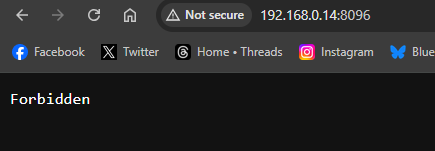

Smeghain 14 Posted December 11, 2025 Author Posted December 11, 2025 3 hours ago, Neminem said: Have a look at this. Connecting from Client Apps I added in the ip address in the top of the network section in emby and now im getting i cant get back in to change it back, i uninstalled it from the synology nas but it still wont let me back in
Smeghain 14 Posted December 11, 2025 Author Posted December 11, 2025 16 minutes ago, Smeghain said: I added in the ip address in the top of the network section in emby and now im getting i cant get back in to change it back, i uninstalled it from the synology nas but it still wont let me back in I also did this 1. Navigate to /volume1/@appstore then delete the application you want to remove. 2. Navigate to /var/packages see if there is a folder named the same as your app and remove it 3. Navigate to /usr/local see if there is a folder named the same as your app and remove it I reinstalled emby again on the synology and it still wont let me back in i still get the forbidden message
Smeghain 14 Posted December 11, 2025 Author Posted December 11, 2025 I had a connection issue and i tried a suggestion and added in the 192.168.0.14 ip address into the top of the network settings in emby server on the web interface it came back as forbidden when i refreshed the page, i couldnt get back in to change it so i uninstalled emby and reinstalled it but its still saying forbidden when i try to run emby....any help please ? i removed the folders from user and var but still get the same thing.....

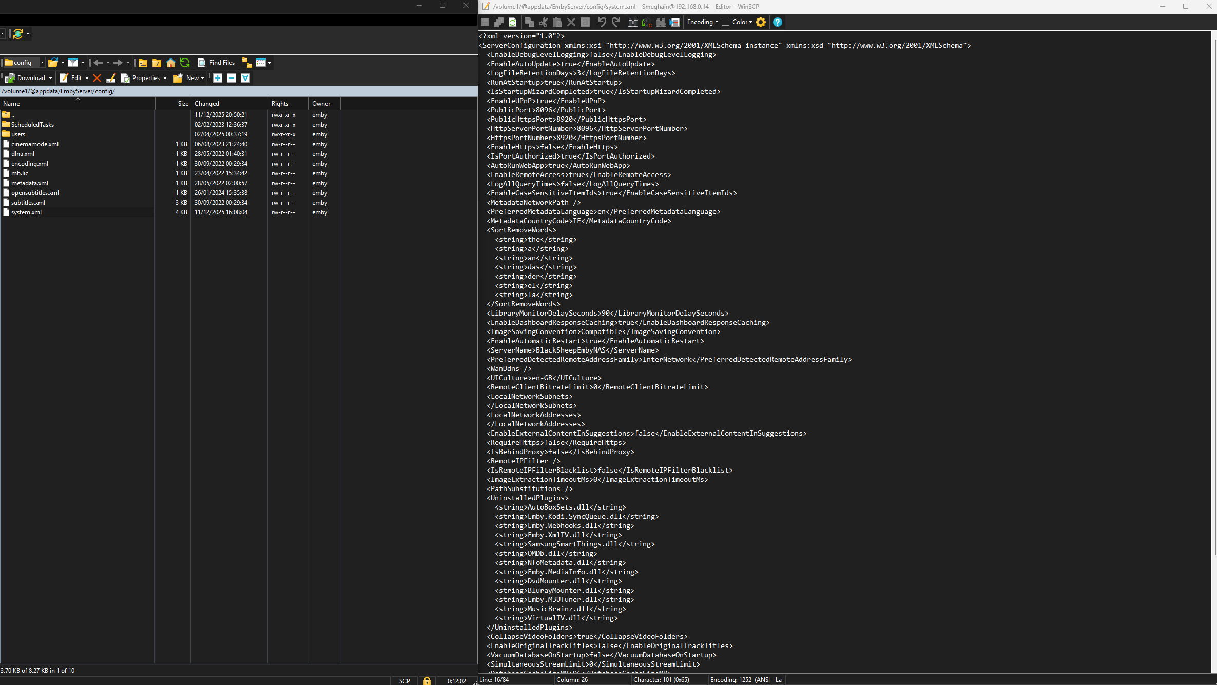

Smeghain 14 Posted December 11, 2025 Author Posted December 11, 2025 On 28/08/2023 at 05:24, Luke said: @emby10014914 Try shutting down the server, then locate the server's data folder: Emby Server Data Folder From there open up the /config/system.xml file. I would make sure EnableRemoteAccess is set to true. Additionally, try removing the entire LocalNetworkAddresses and LocalNetworkSubnets nodes, if they are present. Make sure to backup this file first before attempting to startup the server. If you start the server and get redirected to the server startup wizard, it's due to the file being malformed xml, so shutdown, restore from your backup and try again. Please let us know if this helps. Thanks. I got the system.xml and made the changes but as soon as i tried to save it i get scp: /volume1/@appdata/EmbyServer/config/system.xml: Permission denied so i must need to change permissions on that file, how do i do that ?
Luke 42239 Posted December 11, 2025 Posted December 11, 2025 Did you reach the file using SSH as mentioned in the link I gave above?
Smeghain 14 Posted December 11, 2025 Author Posted December 11, 2025 2 minutes ago, Luke said: Did you reach the file using SSH as mentioned in the link I gave above? Yeah ssh into it through winscp got the file and edited it, but as soon as i tried to save it it says i dont have permission
Smeghain 14 Posted December 11, 2025 Author Posted December 11, 2025 7 minutes ago, Luke said: Did you reach the file using SSH as mentioned in the link I gave above?
Smeghain 14 Posted December 11, 2025 Author Posted December 11, 2025 (edited) 16 minutes ago, Luke said: @FrostBytedo you have any tips? I got the file edited, but when i try to save it i get permission denied, i managed to change the file permissions but it still gives me the error. i tried to copy the file and edit it in another drive and copy it back and still got the same /volume1/@appdata/EmbyServer/config/system.xml: Permission denied error. Edited December 11, 2025 by Smeghain

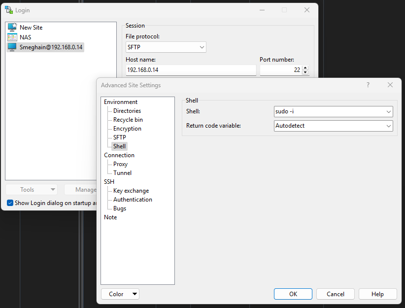

Smeghain 14 Posted December 11, 2025 Author Posted December 11, 2025 (edited) 3 minutes ago, FrostByte said: Did you set up winscp as su? Running as an admin yes ? still got the same error Edited December 11, 2025 by Smeghain
FrostByte 5453 Posted December 11, 2025 Posted December 11, 2025 Admin is not the same as su. Admin account without elevated su won't have permissions to save that file.

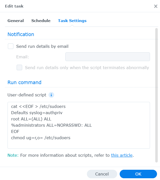

FrostByte 5453 Posted December 11, 2025 Posted December 11, 2025 Hhere is a guide on how to elevate your Admin account to su when using Winscp.
Smeghain 14 Posted December 11, 2025 Author Posted December 11, 2025 3 minutes ago, FrostByte said: Admin is not the same as su. Admin account without elevated su won't have permissions to save that file. ok so how do i do that, running win 11, using powershell to ssh into the DS920+ sorry about this but linux isnt my strong point.
FrostByte 5453 Posted December 11, 2025 Posted December 11, 2025 Just posted link to guide how to use su when using Winscp. If using command line SSH you need to do the following after signing is as Admin sudo -i
Smeghain 14 Posted December 11, 2025 Author Posted December 11, 2025 followed it but now i get Error skipping startup message. Your shell is probably incompatible with the application (BASH is recommended). when logging in through winscp
FrostByte 5453 Posted December 11, 2025 Posted December 11, 2025 3 minutes ago, Smeghain said: followed it but now i get Error skipping startup message. Your shell is probably incompatible with the application (BASH is recommended). when logging in through winscp Did you run the task you created in DSM? Probably need to be signed into DSM as Admin to run it.
Smeghain 14 Posted December 11, 2025 Author Posted December 11, 2025 2 minutes ago, FrostByte said: Did you run the task you created in DSM? Probably need to be signed into DSM as Admin to run it. Yeah, no joy....the user account im signed into the DSM is has admin privelliges also I changed Under “Environment” select “SCP/Shell“ Change the “Shell” option to /bin/sh and now i can login, i tried to edit the file and it still wont let me save it so i tried to copy it across and got the same permissions error 16 minutes ago, FrostByte said: Just posted link to guide how to use su when using Winscp. If using command line SSH you need to do the following after signing is as Admin sudo -i
FrostByte 5453 Posted December 11, 2025 Posted December 11, 2025 That needs to be exactly like it shows in the guide. Without doing the sudo -i command you won't be able to save. Can you try rerunning the script in DSM logged in as Admin? The message you posted before indicates the script most likely didn't run.
Smeghain 14 Posted December 11, 2025 Author Posted December 11, 2025 I logged back in to DSM through the proper admin account and put in a sheduled task and the script, i made sure to run it this time and went then to winscp and ran that as an admin as well opened the file, edited it and tried to save it, same result....wouldnt let me save it went back again and changed the shell in winscp to sudo -i when i tried to login again it gave this error
FrostByte 5453 Posted December 11, 2025 Posted December 11, 2025 (edited) Is Smeghain a member of the group 'administrators' in DSM? Or, does it just have admin privileges? To check if it's a member. Control Panel User & Group Click Group tab Double click 'administrators' Click the 'Members' tab Smeghain should have a check in the box Edited December 12, 2025 by FrostByte
FrostByte 5453 Posted December 12, 2025 Posted December 12, 2025 (edited) Or just try the 'admin' account in Winscp instead of Smeghain Edited December 12, 2025 by FrostByte
