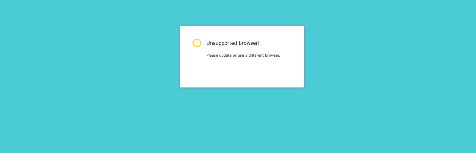

crusher11 1153 Posted December 12, 2025 Author Posted December 12, 2025 4 hours ago, Luke said: Did you try by IP? Yes: On 12/10/2025 at 11:17 PM, crusher11 said: I'm unable to access via WAN IP either; that times out. 4 hours ago, Luke said: Is it getting to your reverse proxy? Did you try without the reverse proxy altogether? Disabling the NGINX docker container results in my IP and the Emby port going to an “unsupported browser” error page that looks like it's being generated by my router.
crusher11 1153 Posted December 12, 2025 Author Posted December 12, 2025 3 hours ago, Luke said: Screenshot of that?
Luke 42288 Posted December 12, 2025 Posted December 12, 2025 Is it tplink? https://community.tp-link.com/en/business/forum/topic/616702
crusher11 1153 Posted December 12, 2025 Author Posted December 12, 2025 1 hour ago, Luke said: Is it tplink? https://community.tp-link.com/en/business/forum/topic/616702 It is, but I can access the router just fine via LAN.
Luke 42288 Posted December 12, 2025 Posted December 12, 2025 I would still read that link and/or do some research on this error screen. It looks to me like you have something that needs resolving that is not emby related.
crusher11 1153 Posted December 12, 2025 Author Posted December 12, 2025 17 minutes ago, Luke said: I would still read that link and/or do some research on this error screen. It looks to me like you have something that needs resolving that is not emby related. I tried my WAN IP and Emby port in a different browser, and I got the router login page.
Luke 42288 Posted December 12, 2025 Posted December 12, 2025 Is this a statement or are you wanting a fix? This does not sound like an Emby related problem. If something is preventing the remote traffic from getting to the Emby Server application, then what would you like Emby to do about it? I'm assuming you've already stepped through our remote setup guide: Connecting from Client Apps If you haven't done that since this problem started then I would start there. I know you're probably going to say that you don't need to do that because it was working before, but over time things will happen and these kinds of things need to be double checked every once in a while. So assuming you've got your port forwarding setup properly then I think you need to look at why your router is presenting a login page rather than forwarding the traffic.

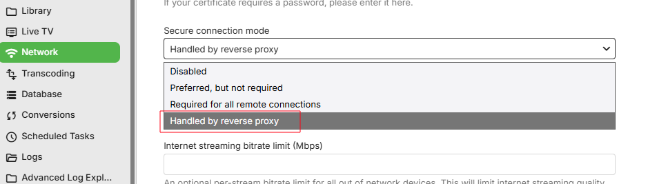

Neminem 1630 Posted December 13, 2025 Posted December 13, 2025 Is this option still set in you Emby network settings.
crusher11 1153 Posted December 13, 2025 Author Posted December 13, 2025 20 minutes ago, Neminem said: Is this option still set in you Emby network settings. Yes. 1
