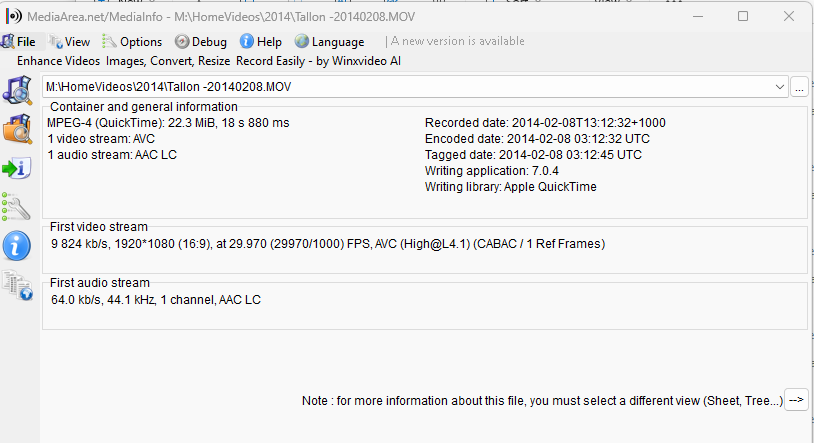

vaise 340 Posted December 3, 2025 Author Posted December 3, 2025 OK. This file - Tallon 20140208.mov. See attached. On VLC and played via emby in browser (chrome), it is portrait all the way. It also plays portrait on the emby for iphone app (and ipad) - which is good. But the Android TV - it flips it. I took some photos of this (if you need proof) but will have to add those from my phone. The mov file it attached. Media info says this - I note it states 1920/1080 so maybe that is why the android client is flipping it - but I want it to play the same as it does everywhere else. Tallon -20140208.MOV

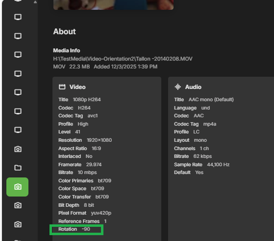

sa2000 697 Posted December 3, 2025 Posted December 3, 2025 9 hours ago, vaise said: Media info says this - I note it states 1920/1080 so maybe that is why the android client is flipping it - but I want it to play the same as it does everywhere el We recently fixed issues in this area - well, not very recently ! Could you select the item in the library and use the "..." and then select "Refresh Metadata" and see if this resolves the issue When you view the item with the details showing in Emby Web, you should see "Rotation -90" at the bottom
vaise 340 Posted December 3, 2025 Author Posted December 3, 2025 Yep - in the web I can see the -90. But the web plays it correctly. I only added this media yesterday - so it would have done the metadata then - but I will give that a go.

vaise 340 Posted December 3, 2025 Author Posted December 3, 2025 I can see that rotate -90 on the TV too. It just does not seem to do it there. Will report back when I can test the shield tv (I gave a 2917 and a tube). But that won’t help the wife as no spare HDMI’s in the lounge.
