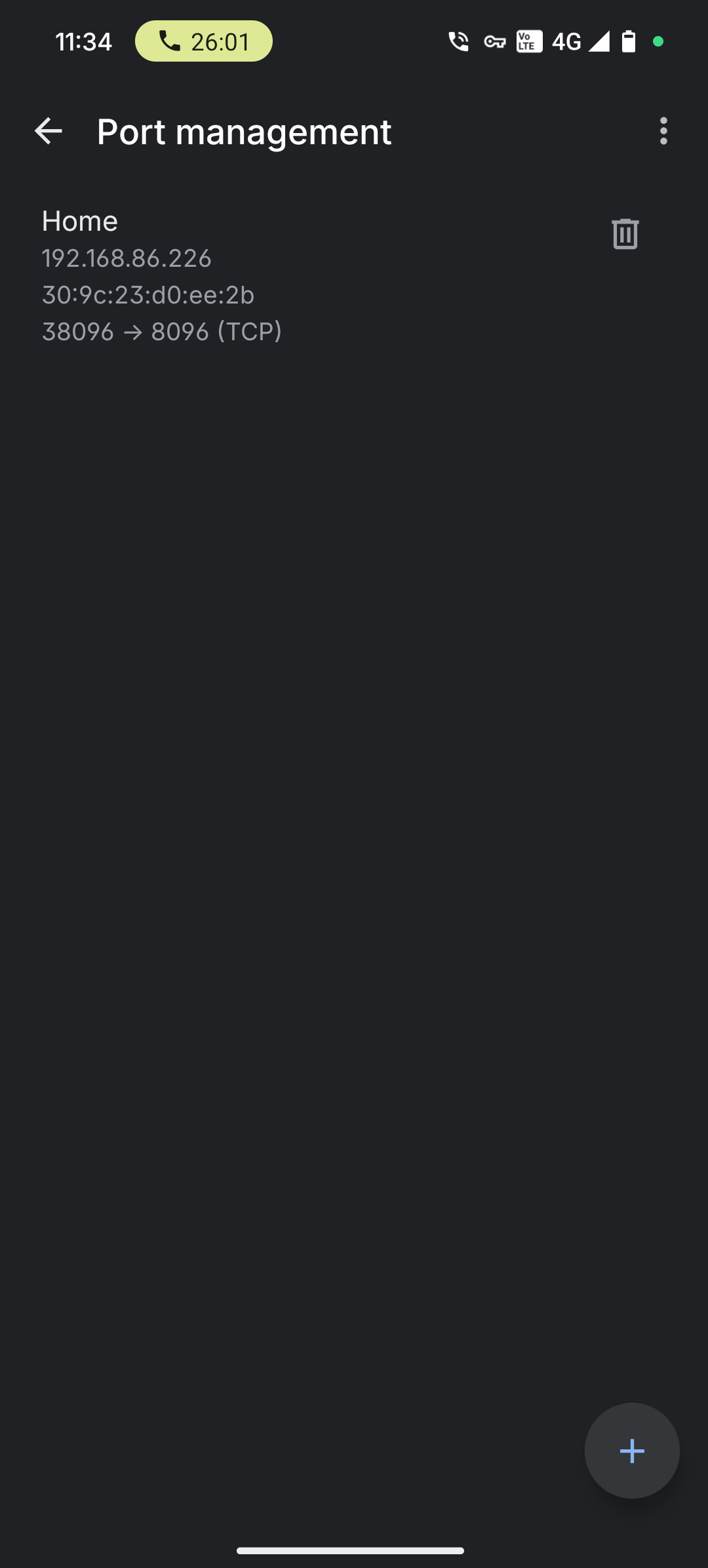

timgreen 14 Posted December 1, 2025 Author Posted December 1, 2025 (edited) I used my router settings to set up a TCP Port Forward from external port 8096 to internal port 8096 and turned off Automatic Port Mapping in the Emby settings. I then changed the external port to 38096 in both the router and Emby settings to try that. The server's IP is http://192.168.86.226 Edited December 1, 2025 by timgreen
GrimReaper 4896 Posted December 1, 2025 Posted December 1, 2025 (edited) 12 minutes ago, timgreen said: I used my router settings to set up a TCP Port Forward from external port 8096 to internal port 8096. The server's IP is http://192.168.86.226 Great, can you share a screenshot of that? Also, since you've posted under General/Windows I'd assume it's a Win server - is your network set to Public or Private? Are you using Windows Firewall or 3rd-party one? Edit: Is that address within your router's DHCP pool? Do you maybe have double NAT in your network chain? Edited December 1, 2025 by GrimReaper Append
timgreen 14 Posted December 1, 2025 Author Posted December 1, 2025 It's not on Windows, sorry about that. It's in a Docker container on an Unraid server. I couldn't find the correct forum for that, so I thought 'General' was best. Attached is a screenshot of the TCP Port Management settings.
GrimReaper 4896 Posted December 1, 2025 Posted December 1, 2025 *Moved to Linux forum* In that case I'd assume it'll likely be related to docker/host network translation and some fellow member more familiar with that particular setup might chime in and offer some insight.

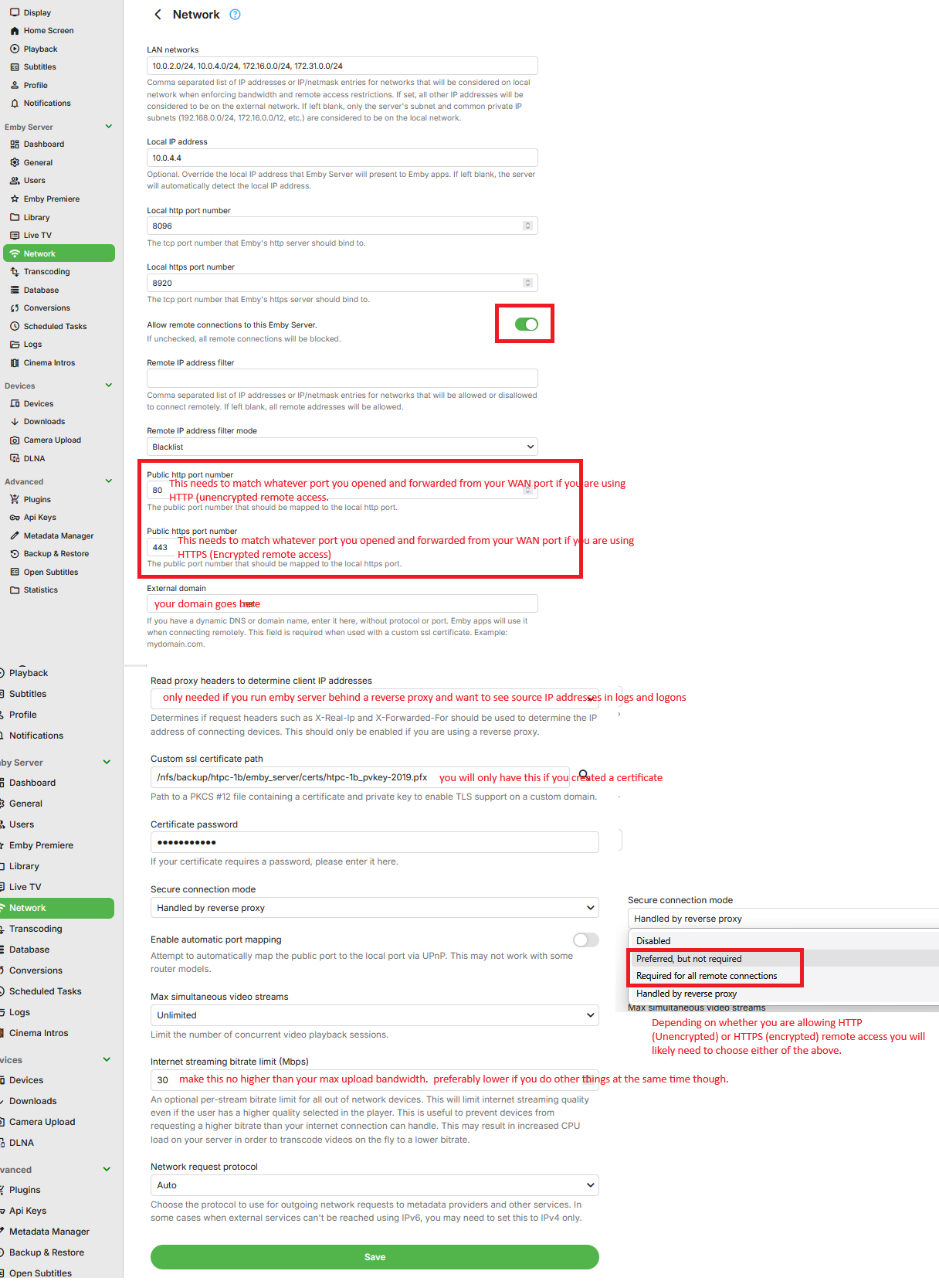

Tur0k 148 Posted December 1, 2025 Posted December 1, 2025 (edited) These would be my high level instructions: 1. Describe your network equipment. We need to know what kind of home Internet, Modem, Router/firewall, etc you have. We need to rule out a Double NAT issue/CGNAT issues 2. Get your public IP. Services like https://www.whatsmyip.org can help here. Then check the IP address in your modem or home router that is tied to your WAN network interface. Ensure that the IP on your home modem/router's WAN network interface is not a private IP address (if it is you likely have a CGNAT and will need to setup a cloud proxy (see below). Private IP addresses look like the below: 10.0.0.0 – 10.255.255.255 172.16.0.0 – 172.31.255.255 192.168.0.0 – 192.168.255.255 3. make sure that your Server gets either a Static IP or a DHCP reservation from your home router/firewall. 4. Depending on the type of router/firewall you will need to figure out how to port forward from your Wide Area Network (WAN) physical interface to the static IP/DHCP reservation you are hosting the Emby Server Docker container on. Then use a public Internet port scanning service to make sure the port is open and forwarded to the right internal server IP and port number. https://www.whatsmyip.org/port-scanner/ is pretty good at this. 5. You will need to ensure that you have setup remote access settings in "manage emby server" menu (gear icon in the top right) - network tab. (See Attached) Enable the "Allow remote connections to this emby server" radio button Update the "Public HTTP port number" or the "Public HTTPS port number" to match what you setup on the firewall WAN port for open ports. 6. Extra points if you setup some type of Dynamic DNS (DDNS) domain name that dynamically links your public IP address to your public IP. I personally use Cloud Flare as a Domain name and public DNS provider only. it is pretty cheap and they offer an integrated DDNS update service that I setup my firewall to automatically keep up to date in the event my public IP changes (I don't pay for a static IP). If you do go this route tou can also add this to the External Domain section of the "manage emby server" menu (gear icon in the top right) - network tab. (See Attached). 7. Whenever you make something accessible on the Public Internet I would recommend setup of encryption in transit. Generally your options are: TLS/SSL encryption either within emby, from a reverse proxy. you could go through adding openvpn and setting up a self signed certificate (i think there are a bunch of instructions on how to do this) but all clients will get a message saying your certificate is untrusted. you also could go through and purchase a Public Key Infrastructure (PKI) publicly trusted certificate. There is a more significant cost with this and the process is cumbersome (rarely automatable) and requires you update the cert regularly. The method I like most is offloading Encryption handling to a reverse proxy there should be some relatively good videos on how to set them up and there is a thread here that goes over config setups. Then use a service like Let's encrypt to get free TLS/SSL certs. they even make apps and integrations that handle automated updates of the certs. Some of the reverse proxies offer Let's Encrypt SSL certificate setup integration. This allows you to keep costs down to near 0 as well as automating the update process. I like nginx proxy manager for this feature. Cloud proxy service. Cloud flare has this in their offering but I am pretty sure they don't support hosting streaming services across their Free tier cloud proxy service. cloud mesh (tailscale or some other alternative like it)/ a private VPN service (wireguard, openvpn). I use Wireguard but only for remote management when I am not at home. Edited December 1, 2025 by Tur0k
